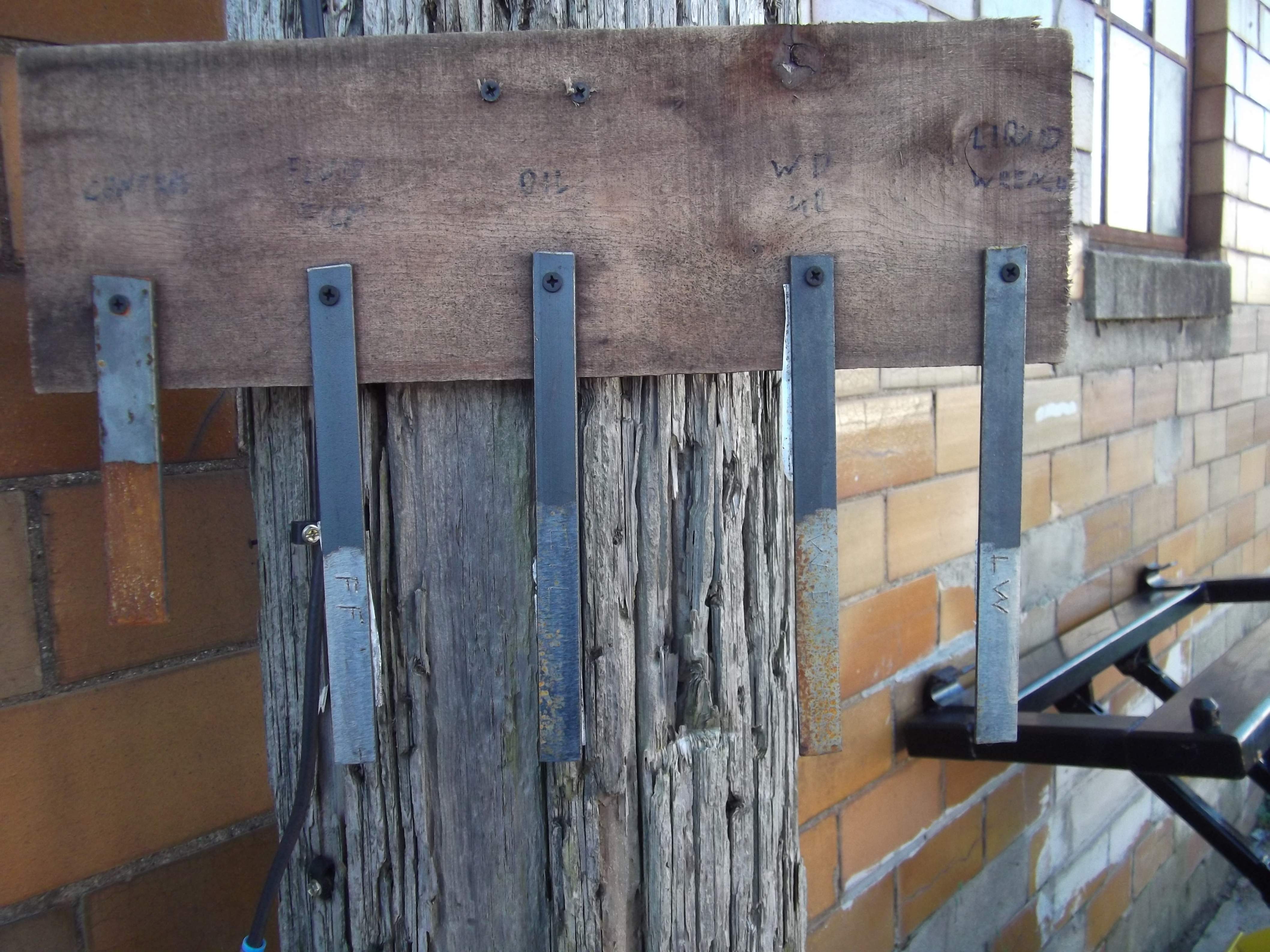

First off let me say to Moored4. I looked at the original pictures and I agree with you about the FF bar. I don't know what caused the discoloration but it was there at the start.
About the new picture.
Normally I look at the bars daily, but I didn't yesterday, so I can't say for sure which rusted first the LW or the FF bar. I think it's a fair bet to say the LW went first because the rust has bigger spots and is easy to see. You have to look hard to see the FF rust. Neither bars rust shows up well on the picture so I am just posting the latest group shot.

In the picture I just posted you can see the rust starting on the LW bar.
At this point I know who rusted first and last.
1. motor oil
2. WD40
3. Liquid Wrench
4. Fluid Film
I started the test on 12/3/11 and as of today 12/29/11 all have rust. To be honest, I thought it would take longer than 3 1/2 weeks.
I'm not done with the test yet. I plan to wait a little longer to see which gets a complete (or mostly complete) coating of rust. The oil bar is motivating me to do this. If you look at the picture it was the first to rust but looks better than the WD40 bar. I find that odd and want to see what else happens. It seams there's more to this than just who rust's first or last.

From my experience with WD 40 it is a good cleaner but a poor rust preventative. It seems to attract moisture after a few days and really cause corrosion on guns. I now only use it as a cleaner and then use good gun oil applied with a heavily saturated rag for my long term storage. I also use dessicant sacks which I take out and dry in the oven whenever I think about it.:laughing:
