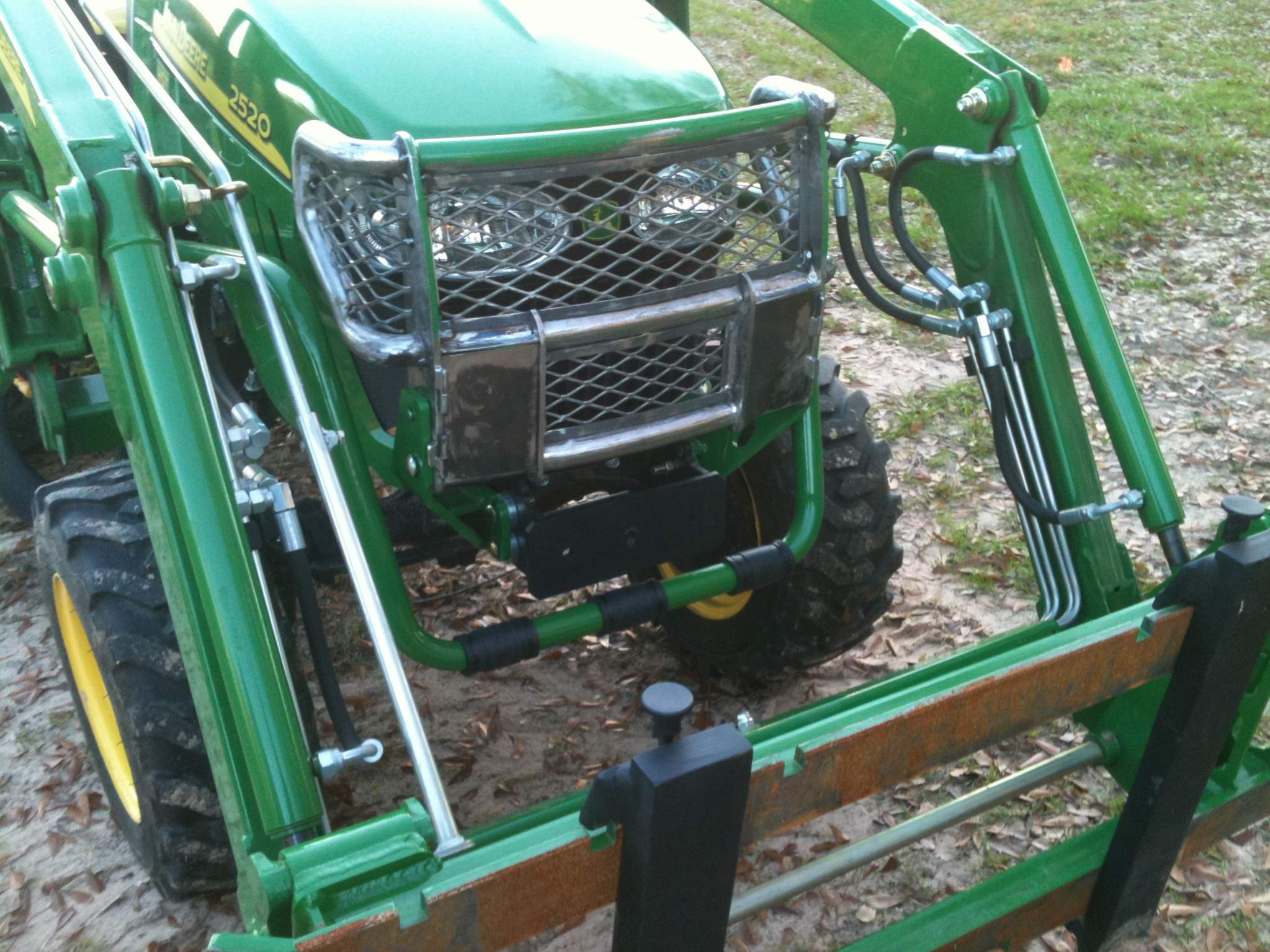

I sprayed FF on my FEL and it still had stuck snow.. I will re-spray; but, so far not impressed.
   / Rust protection comparison #42
We had good luck with Pam Cooking Spray.
Chris

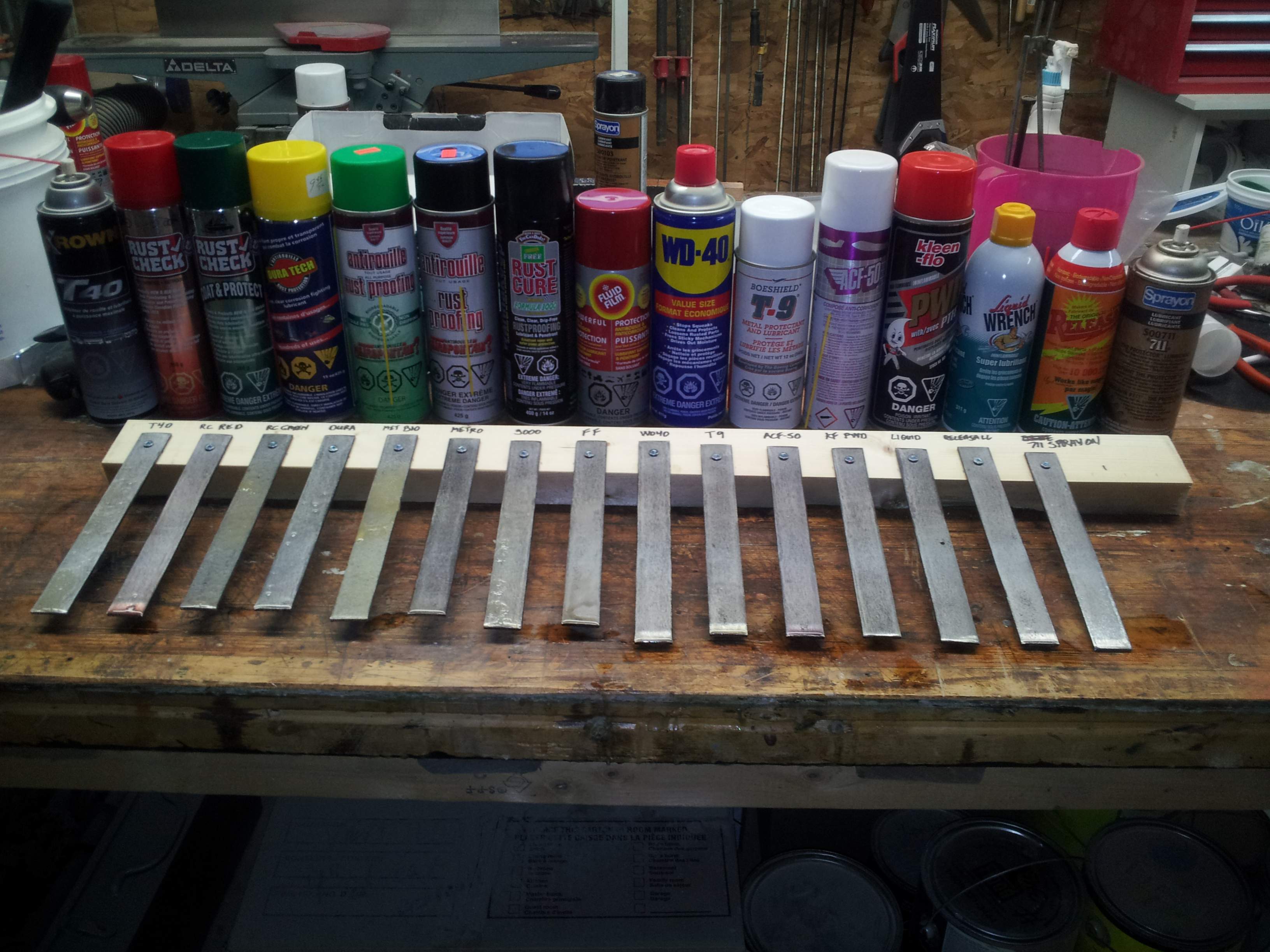

I make same test with 15 products
Krown T40
RustCheck Red
RustCheck Green
DuraTech
Metropolitain Bio
Metropolitain Old
Formula 3000
Fluid Film
WD40
Boeshield T-9
ACF-50
KleenFlow PWD
Liquid Wrend Lubrifiant
ReleaseAll
SprayOn 711

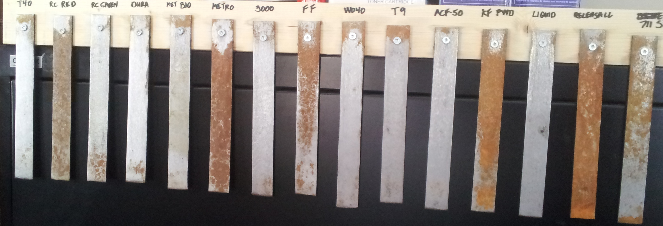

Rust Check, Metropolitain Bio and Formula 3000 are thicker
I put stuff on steel bar 02-09-2014, spray salt water 5-6 times, wipe bottom (+- 1 inch), spray salt water 2 more times and wash with soft water. 03-01-2014 picture show results.
First: Liquid Wrench (I dont understand. It was not my first choice)
Second (ex-aequo): T40, Metro Bio, Formula 3000, WD-40 (Yes), T-9 and ACF-50
Next step, I will use high-pressure washer and salt water again.
   / Rust protection comparison #50
That's pretty cool. I would not have expected liquid wrench and wd-40 to do so well. Did you do any prep to the steel before you coated them? I notice that allot of the samples have rust around the fastener which could be the acids from your fingers when you mounted the samples.
