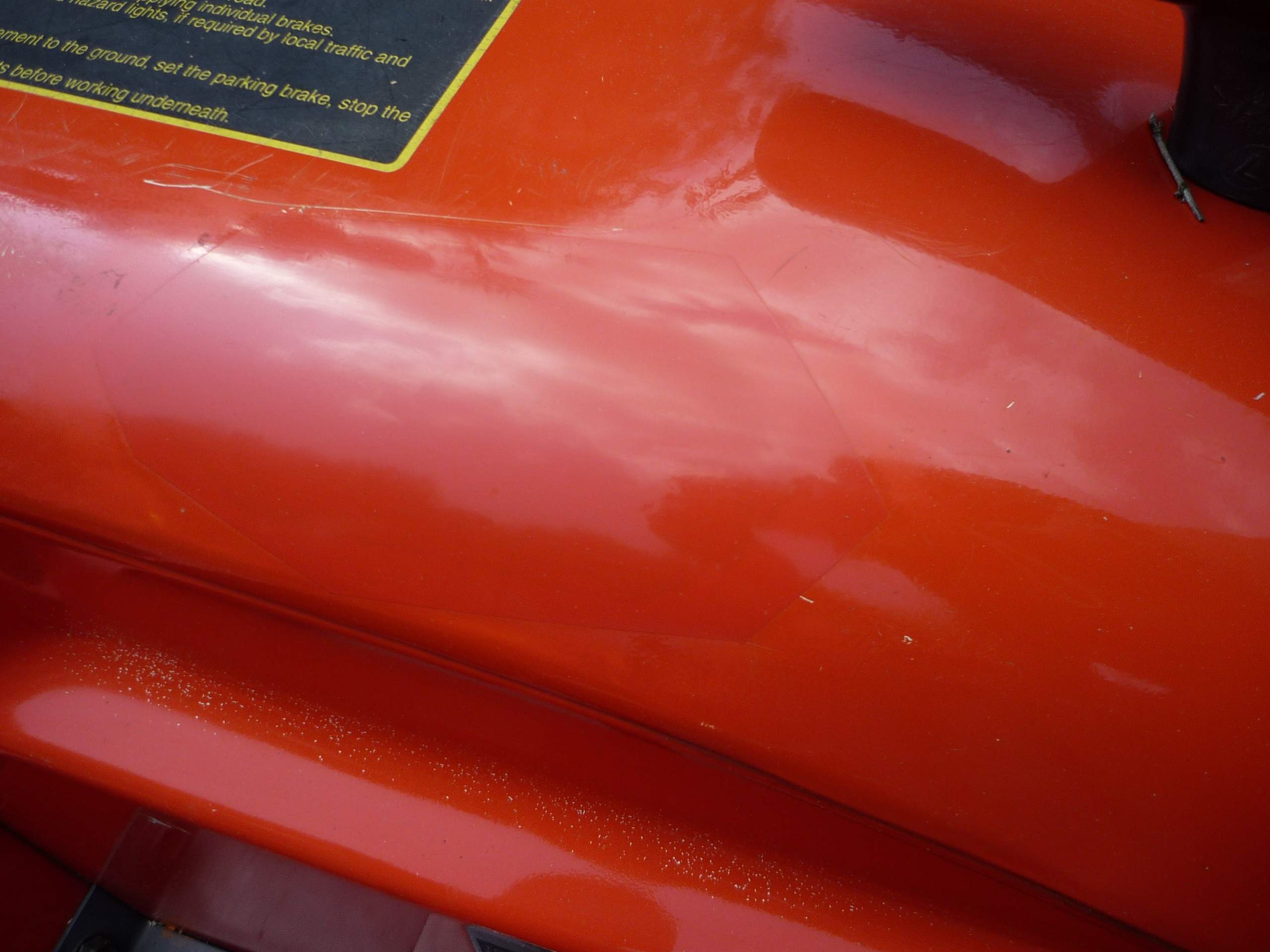

Don't know what type of paint you are referring to, but in spraying the Kubota urethane factory paint, which you can thin with mineral spirits, I finally bought some xylene, which is the preferred thinner, and man, what a better way to go! It slows down, slightly, the drying, and makes for easy coating and good leveling. I am an amateur painter, but I got great results. Any time I spray, it's my go-to thinner now. The pic is of a 6" sq. area, one coat, just as it came from the cheap spray gun. (you can see where I had masked off the surrounding fender...)

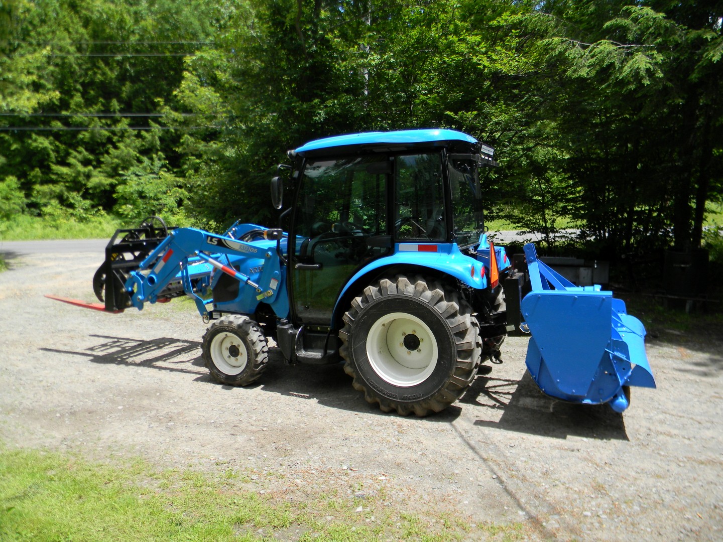

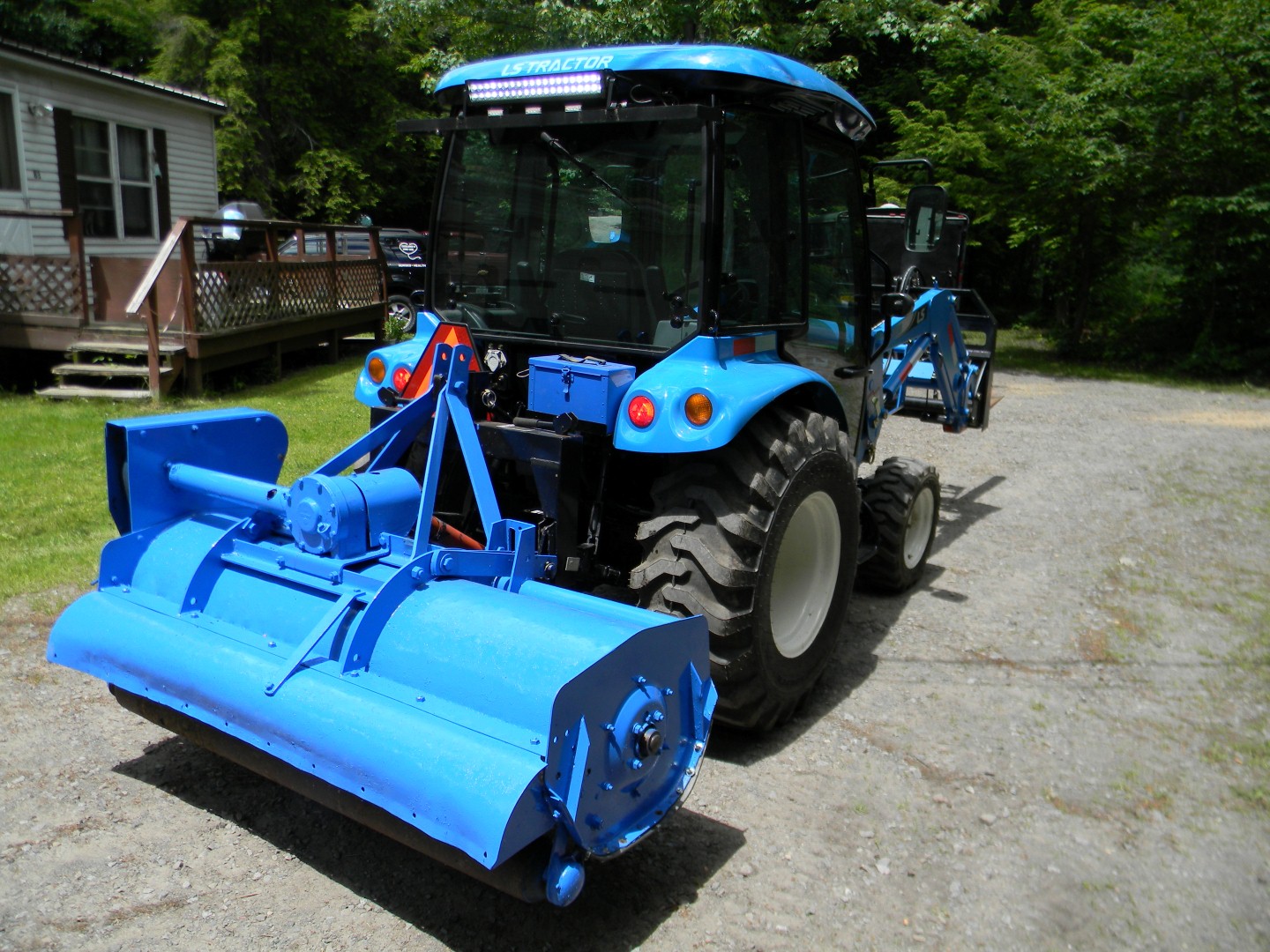

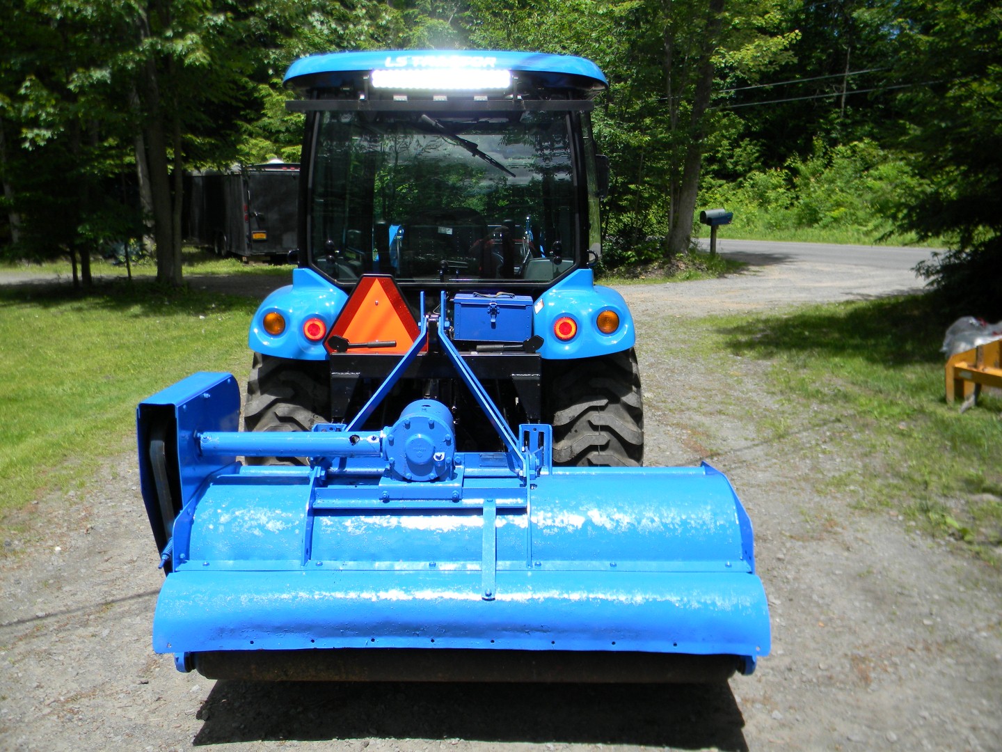

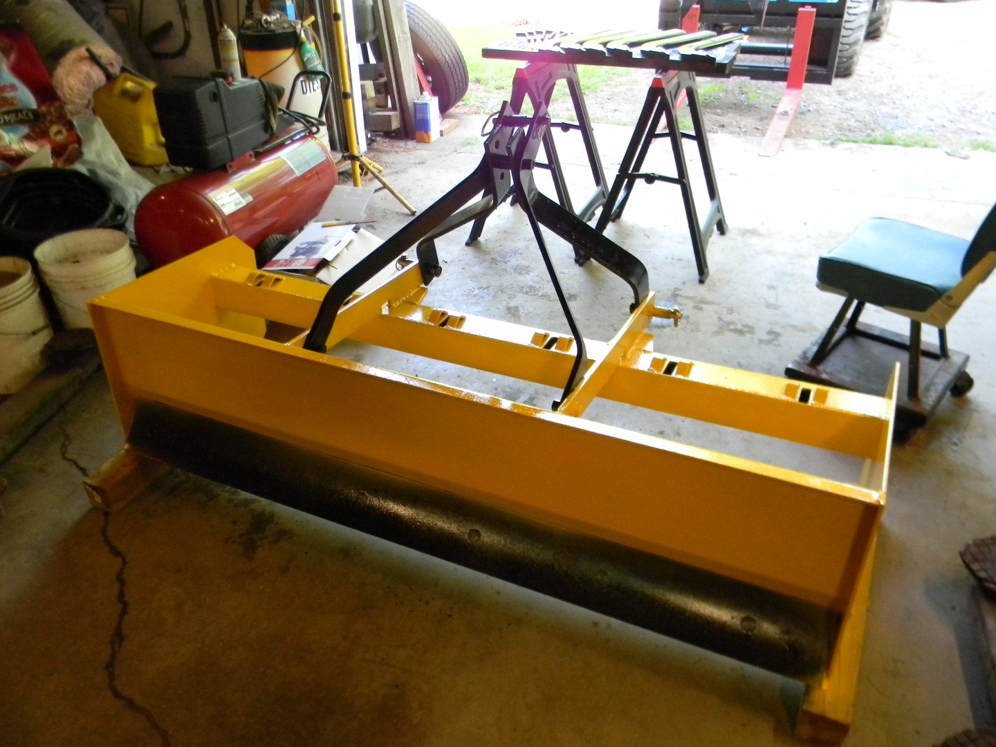

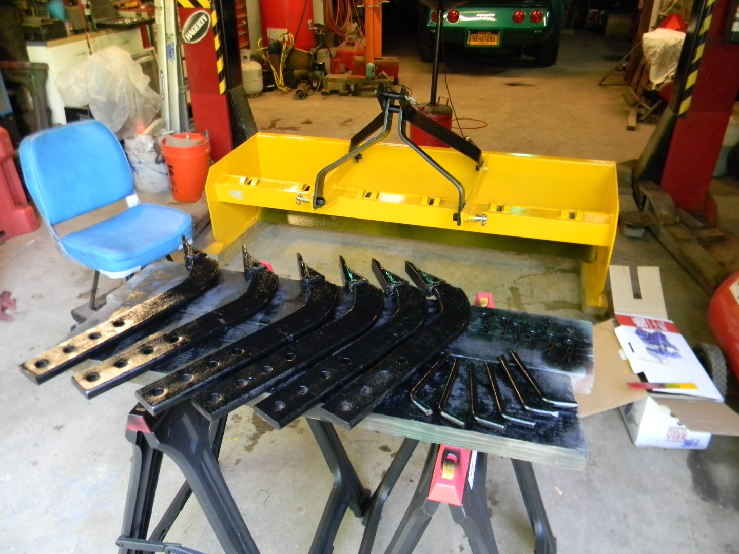

I like rustoleum also. I recently cleaned and repainted a flail mower I bought. I bought a quart can of sail blue (very close to LS blue) and sprayed it on with a $15.00 HF spray gun. Thinned the paint a little bit before putting in the gun. I could have used the spray cans but this way was much quicker and did a nice job. I think rustoleum also has clear in a spray also but never tried it.
I also cleaned and sprayed the box blade I bought at the same time. The scarifiers were done in rustoleum gloss black from the spray can.
