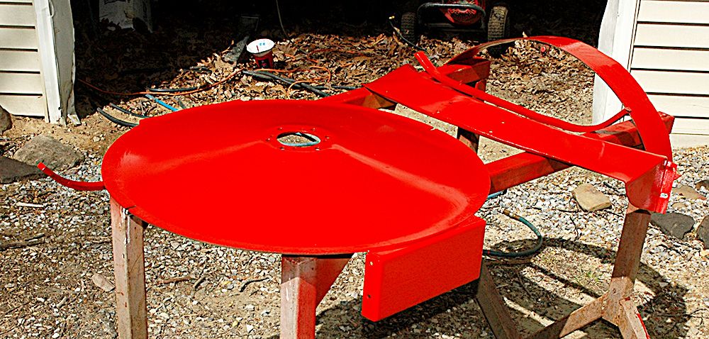

OK so you all shamed me into fixing it! LOL
I had a few things going on, the first was the paint gun, a threaded knob under the trigger had come un screwed, I wasn't getting hardly any material through the gun. I cleaned the gun, had a plugged air passage on the nozzle.
I mixed up what paint I had left, about 8 oz. I didn't use any mixing ratio, I just added some acetone until it looked thin, then I dumped about an oz into the paint can to get the last of the paint out. I gave it a test shot on the piece I cut out, adjusted a little and it looked great, went to town on the top. I think it looks much better now!
Thanks for the push :)
I'll be ready for the next thing I need to paint.

Your second attempt is much better and the top looks really nice. Great job.
Rustoleum is a great paint and dries fast enough if you thin it with acetone. That's all I use for implements if I can find a matching ag color. For the better work I stick with OEM factory paint because it's just such good quality, has a great shine and stays that way for a long while. Most factory OEM paint sprays beautifully.
If you want a great paint gun, the $25 Harbor Freight HVLP one is what to get. Lots of threads on it here and you can find those paint guns in repair shops everywhere. When I clean mine after use, I set it up for the next time I use it so I don't have to remember where to set the knobs. Works for me. You'll be painting everything now.
