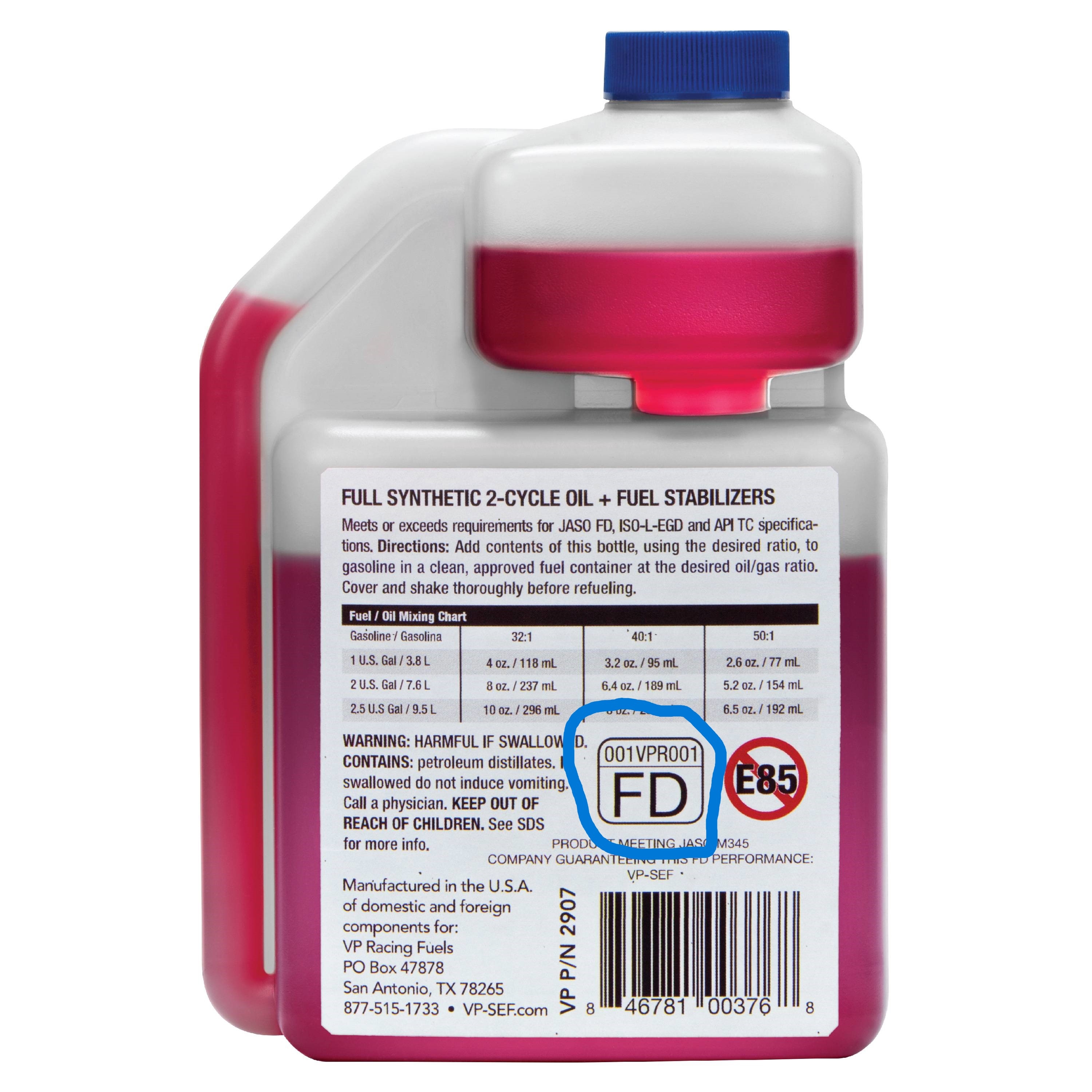

I run everything 40:1. Dealers cant tell you different either due to epa law. ;)
But knowing a few dealers that are in the know. They will tell wink wink if they trust ya. They run their stuff 40:1 min.
Look for FD oil IMO too.
Always tune to your mix. AT or MT will do it for ya.
