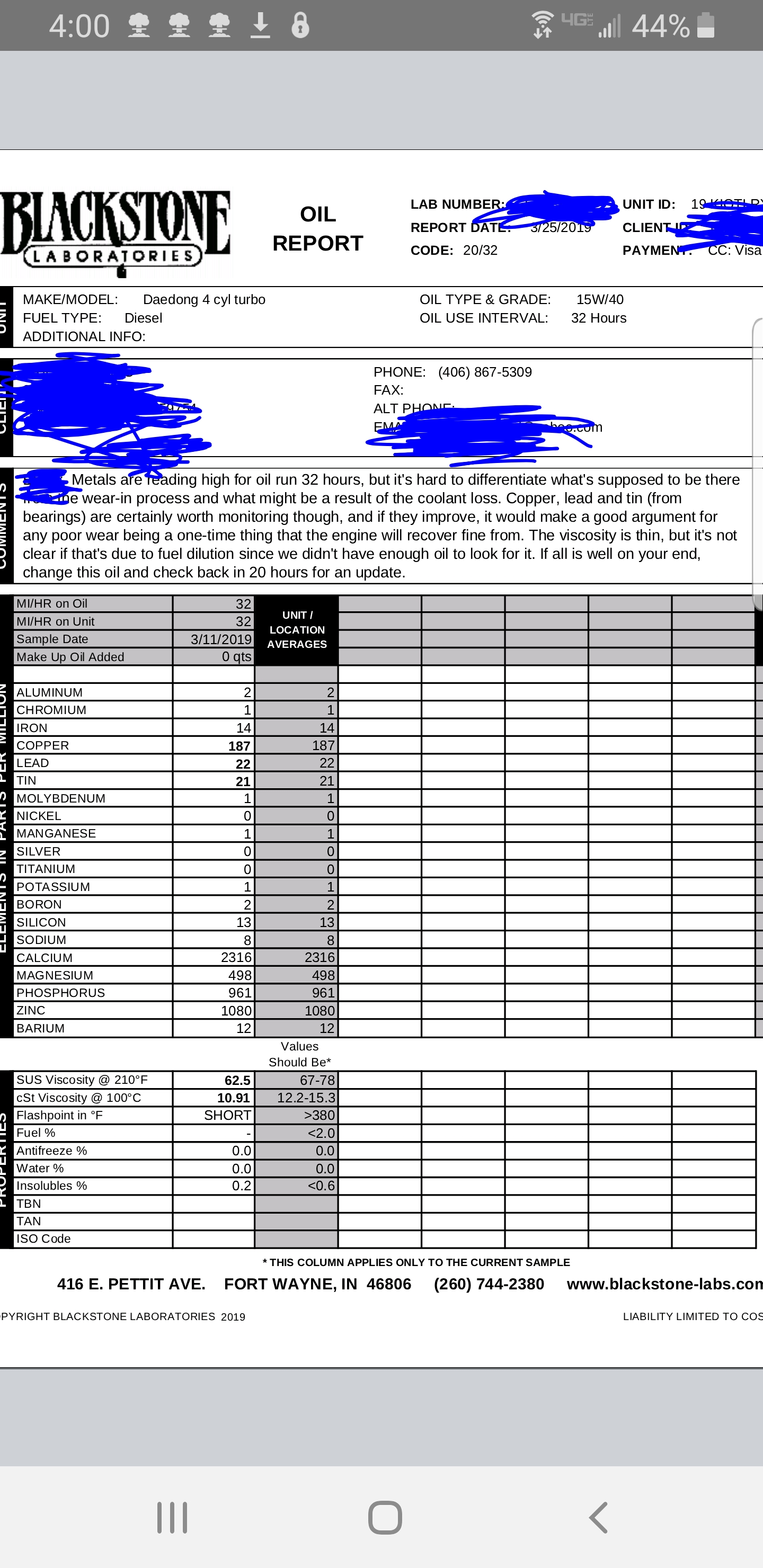

1-I’d go ahead and pull an oil sample and send it to Blackstone. If any piston/ring/ cylinder material scuffed it might show in an analysis.
2-make sure dealer has a written statement that clearly states the tractor was suspect to overheating due to coolant loss and you noticed a power loss along with the RPMs unable to go above 2000.
The thing is no one knows how hot it got. Gauge will be useless without coolant passing over it. If that heater popped out at 1 hour and you ran it 6 more without coolant, the engine will have damage.

I agree with all the above, with one exception: oil analysis is a great way to track wear over time, meaning as a long term wear indicator of an engine's overall condition and as a predictor of when a rebuild may be needed. Your engine's situation is different because it is too new to have anything to compare it to it's last oil change, for instance. BUT, if coolant entered the oil or excessive metals show up in the first oil change, it could confirm the overheat/wear conditions you are looking to find. If so it would possibly indicate a near term failure on the horizon. Essentially engine will be toast, whether the B. heater pops again or not. Result run away from that engine/tractor. I don't know for sure if asking for a completely new tractor and having, possibly to settle for a new engine is the best option, or not. It's difficult to say what Kioti will decide, but I'd hope they do you right in your situation.
Regardless of anything else, lookup Blackstone Labs and or call them to find out the exact prep you need to do to get a sample and how much oil they need, whether you need to run the engine to temp or not before sampling etc. Do what they say, EXACTLY as they tell you to, and get enough sample oil to have at least 3 samples. One for them, one to keep, and a third in case Kioti wants an analysis for their own tests. Change the filter too, and mark the exact hours and date on the filter body. Store the filter with whatever oil is left in it for reference, in a ziplock baggie.
Most labs can do coolant analysis too, so that might be worthwhile to see if there are metals present that shouldn't be at such low hours.

I would pull the injectors and use a borescope to inspect the cylinder walls and pull an oil sample to check for iron other wear metals. I assume Kioti uses plasma faced rings.
