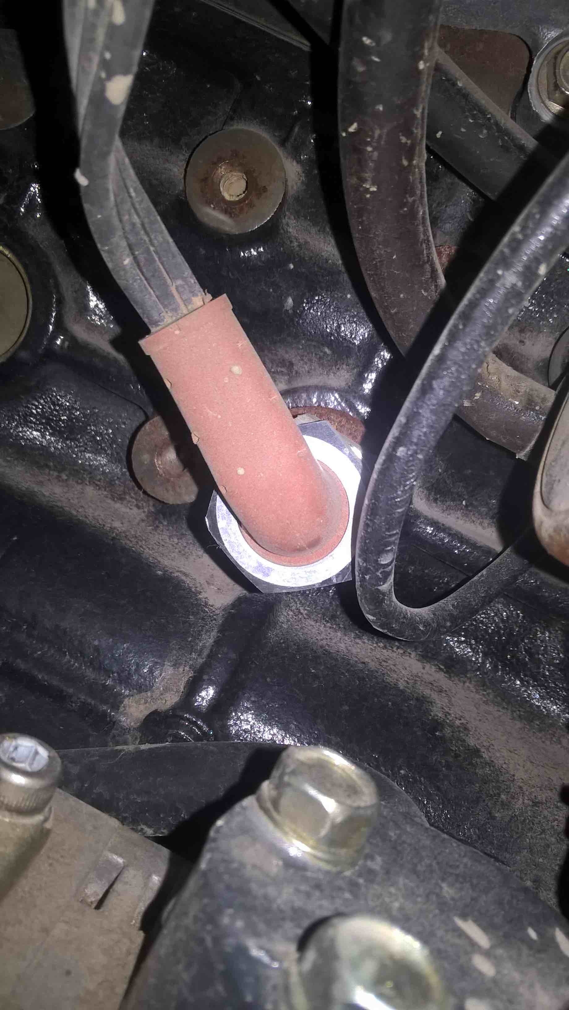

I suspect, as your dealer's field tech mentioned, something is wrong as to the mating of the block heater adapter sleeve diameter and the block's actual dimension(s). It's also possible since this is not an isolated instance on several (?) Kioti's recently, that the plug manufacturer and Kioti are working to find the answer to which it is. This is another reason a case with Kioti should be started regarding your specific tractor. The more cases they have to investigate, the sooner they will have to solve the problem.
Consider your dealer's mechanic took no time to point you to opening the hood- indicating he knew what the most likely outcome was to your issue. The field tech didn't hesitate to know how to remedy the problem and spoke of others they'd seen. They clearly understand the problem; which begs the question of why they continue to install these block heaters?

I'm really sorry to hear about your trouble. As Coyote Machine said, a similar issue came up here recently. The owner was out of warranty, but still with very low hours. He was upset that Kioti wouldn't help him out. He got an earful from some folks on this forum saying he was out of warranty and shouldn't expect any help. Apart from some photos and a few comments, he never gave sufficient details for folks to take him seriously. This looks eerily similar. As frustrating and disappointing as this is for you, I think the fact that it happened with so few hours on the tractor is good. A brand new tractor costing north of $40k should not be doing this. I'm not sure what it would take to make me comfortable. Perhaps different tractor (same make/model) with no block heater. Or perhaps different brand all together.
As you know I've got the exact same machine, with block heater. I've attached a picture of my heater install, done by the dealer. No bracket. Please keep us posted with how this develops. I wish you the best of luck. blockHeater.jpg
