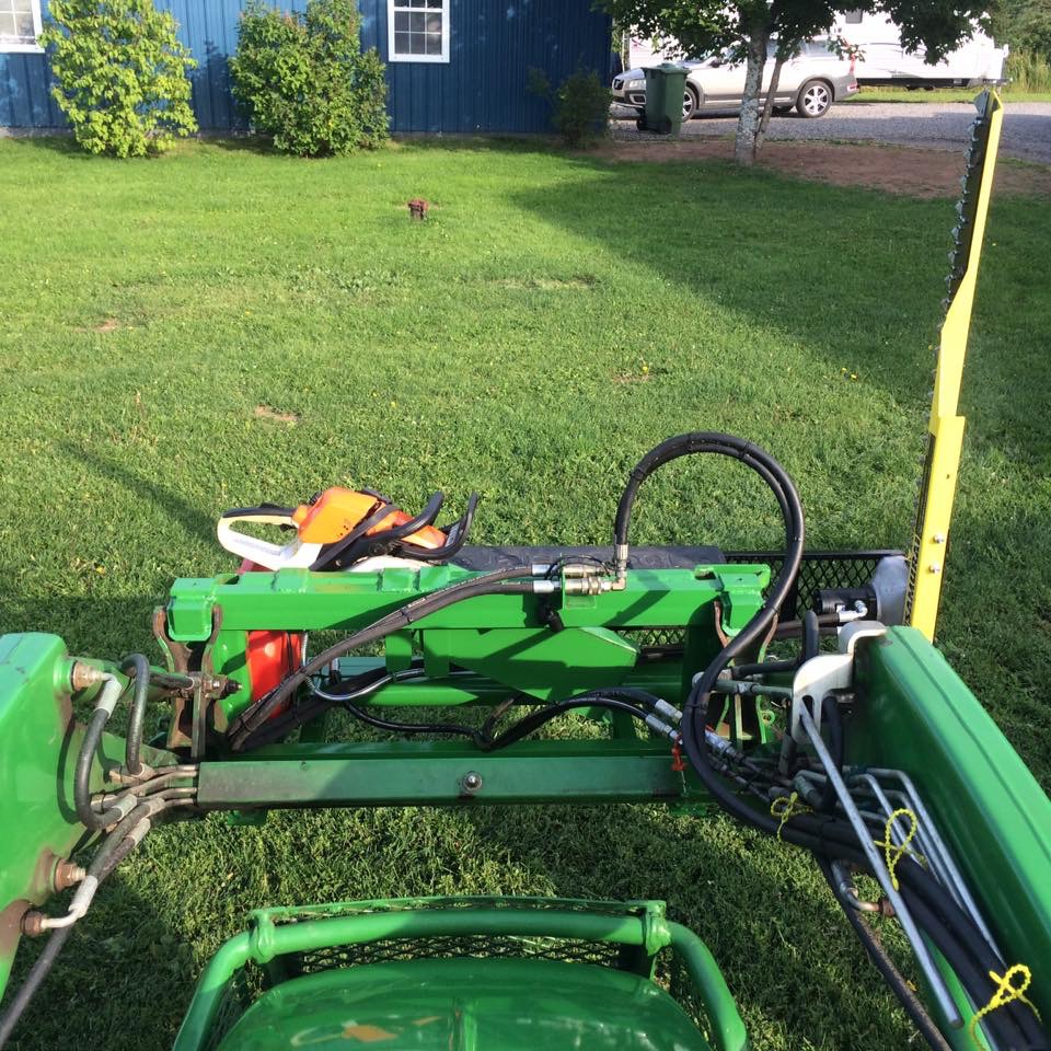

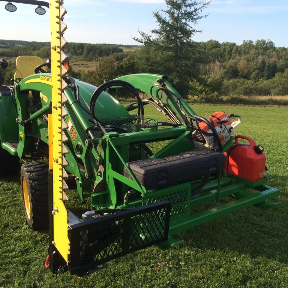

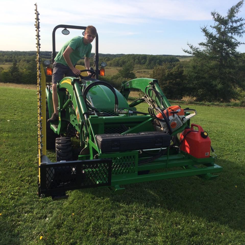

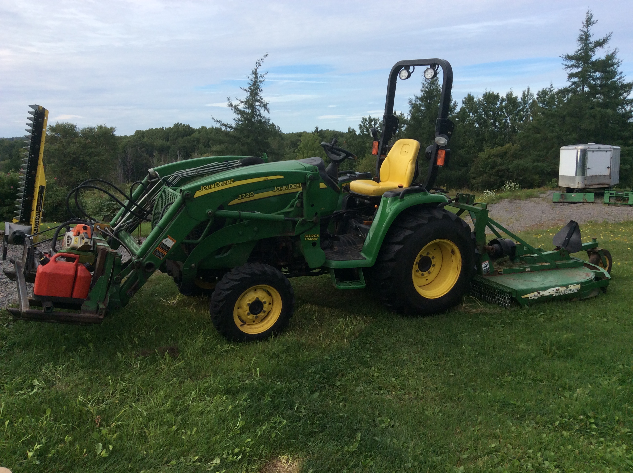

Here is my version of the Sabre Samurai cutter.
I researched this attachment on this and other sites,saw what others had done and came up with this set up to work for my trail clearing needs.
I made a quick attach frame for my FEL, modified the supplied mounting bracket and added a hydraulic ram that can extend the cutter assembly out 30" from frame.
I tapped into my power beyond hydraulics that power my backhoe and used a flow controller to provide the proper Gpm. This way I can also run my bush cutter at PTO speed and lift the rockshaft arms as needed.
I have to tidy up some hoses yet to make a nice clean install but everything is working great.
It makes trail work or cleaning up the edges of woods roads a much easier and quicker thing to do!

Very nice work! Well thought out. How far will the cutter angle down? As in cutting along a ditch by a driveway?
   / Sabre Samurai Cutter attachment #3
Really nice work. Looks like it could've been made by one of the major manufacturers. I could use one to keep the sides of my driveway cleared. Too sloped for brush hog use.

I didn't like the supplied bolt that allowed you to put in any position from vertical to horizontal as it would loosen as you were using it, found this out as I was mocking it up.
I made so it could be pinned in the vertical, at 45 degrees up, horizontal, and 22.5 degrees down to cut in the ditch. It would have been nice to mount another cylinder to make it tilt hydraulically but I didn't have another scv to use - I suppose I could have made a manifold where I mounted the quick connects for the motor and added another valve back in the operators' station - maybe this winter's project once I get our trails trimmed!
I will post some pictures again in the different positions and with it extended once I tidy up the hoses on the flow controller.

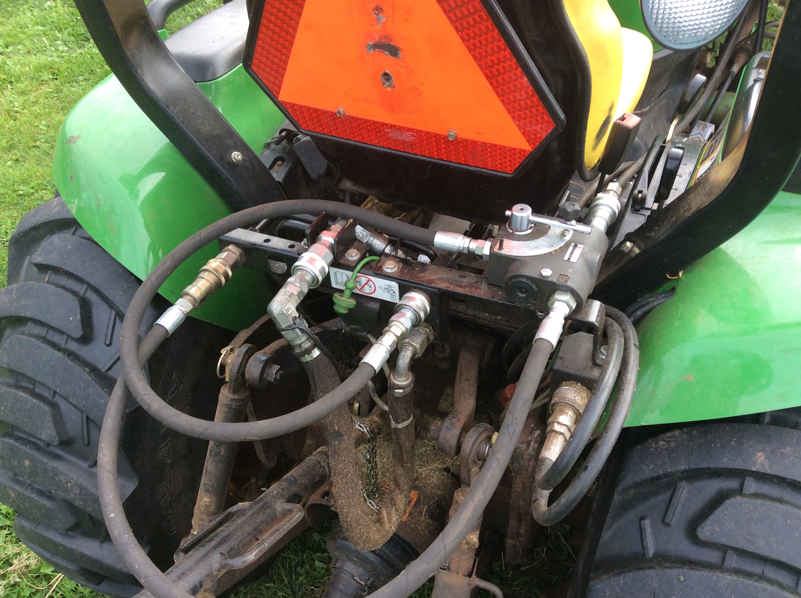

Does your tractor already have the "power beyond" hydraulic kit from John Deere? This puts the full hydraulic power of the 3720 to the rear of the tractor.
I had this previously installed as I have a 485 backhoe as well - this was the starting point where I plumbed in a flow controller to power the samurai's hydraulic motor.
I can give you detail and pictures from this point. I am not certain how you would get access to the flow ( valve and gpm wise ) you need from another setup.

Sorry for the delay in getting back to you.
Here are some pictures that show the hydraulic set up from the rear view of the 3720 when the Samurai is connected and in its usual state with no hydraulic implement attached - just the circuit that powers the rockshaft arms to lift the 3pt. hitch.
The first picture is the circuit connected to run the rockshaft arms alone as per the power beyond kit. The next pictures show how to power the Samurai and keep the power to the rockshaft arms.
Also there is a flow diagram that the service manager at my JD dealer drew for me to follow when plumbing it up so that it allows the tractor at full PTO speed, setting the flow controller to the 4gpm the Samurai requires and still run the rear PTO and lift the bush cutter on the 3pt. hitch.
I do a lot of trail work with our local atv/ snowmobile club and this setup is excellent for that type of work.
You can set the cutter at the height with the FEL to get all those annoying branches that swat you in the face on your first pass, they drop and you grind them up with the cutter behind you, then your next pass it's easier to move over a bit - has made it very simple to effectively widen our trails. Anything over hanging up to about 13ft I can reach up and cut. Much easier on 50+ year old shoulders than hours with a pole saw!
The cutter is stored for the winter up here in Canada - I will post some detailed pics of the ram set up when I next have it out.
