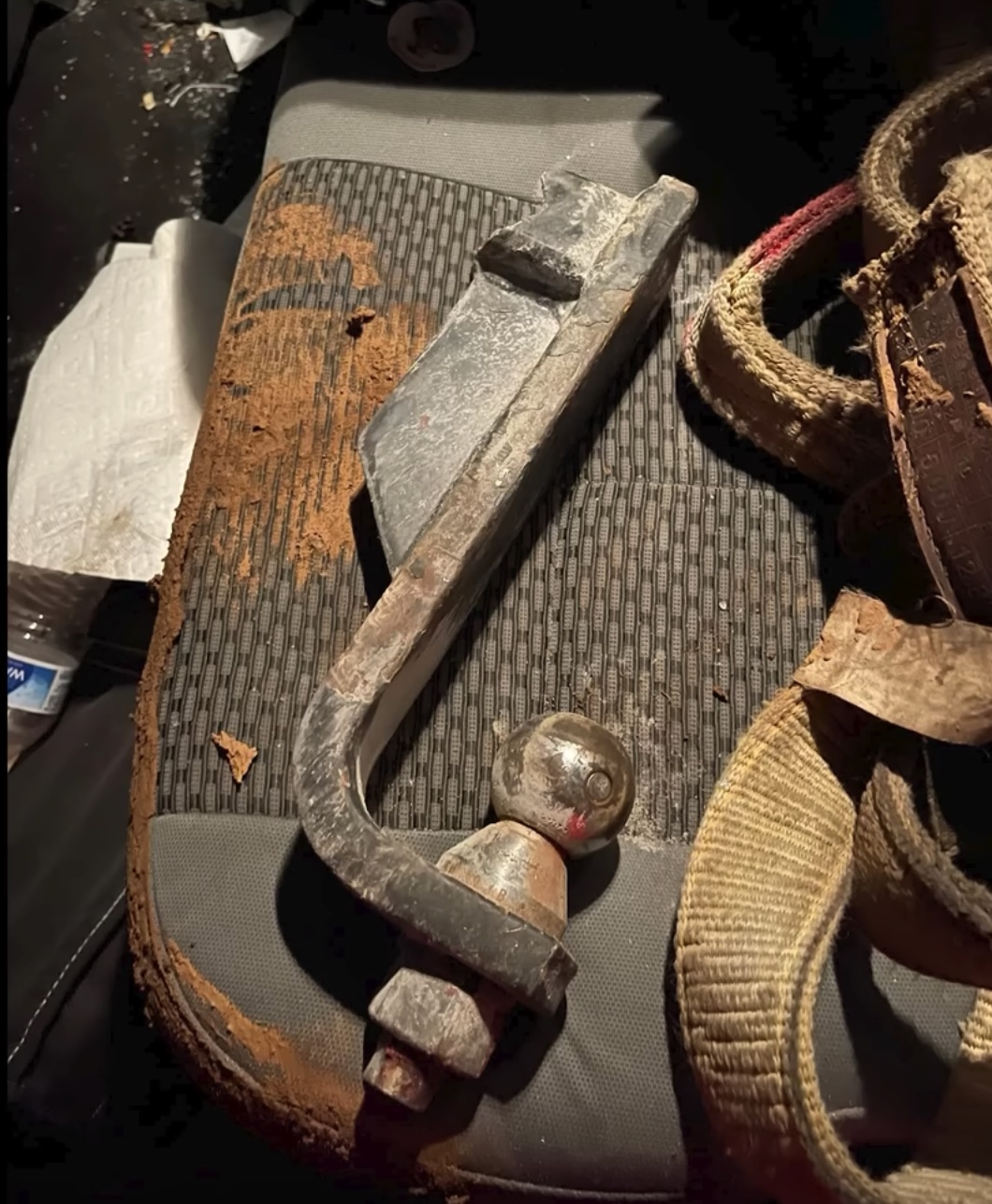

Sad truck recovery accident out of Arizona. Sad becuase the guy died, but also sad because his 3 kids were sitting in the back seat as a 30 lb. drop hitch came through the window and killed him. Could have been avoided, putting this here to remind us to not make a similar mistake.
He didn’t mention the pulling strength of the receiver.

Do not trust the 5/8" pin that secures the slide in hitch. This is not the first time for this failure.

This may have been asked before, but I wonder how strong the trailer hitch assembly is on the truck itself? If it is just bolts-on, wouldn’t it possibly fail?
   / Sad and Tragic Recovery Accident in AZ. #59
Sure. If the whole assembly is rated at, say, 8000# and someone puts 18,000# of jerk force on it, there's a chance the bolts will fail.
Our 93 G20 had a bolt-on hitch. I put it on myself. The bolts fit in factory holes in the frame. There were three bolts on each side. It was rated at 8000#. I often wondered about that.
   / Sad and Tragic Recovery Accident in AZ. #60
It is easy to understand the failure in this case. The amount of leverage a sudden shock would have on that hollow hitch insert would be tremendous. My suspicion is that we wouldn't be talking about this if the strap had been slid up to the dop of the drop hitch. It was the leverage that allowed the drop hitch to literally tear the square tube in half.
