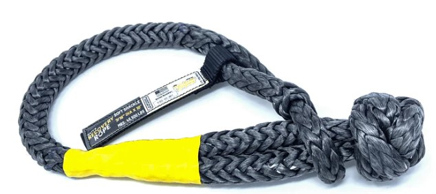

How do you suggest attaching the loop end of a strap to the vehicles without a "hook"?
You use what is called a soft shackle:
The soft shackle can be placed around many different frame shapes under the vehicle, its a pretty clever idea.
This Youtube channel channel uses them almost all the time:
https://www.youtube.com/@MattsOffRoadRecovery/featured
