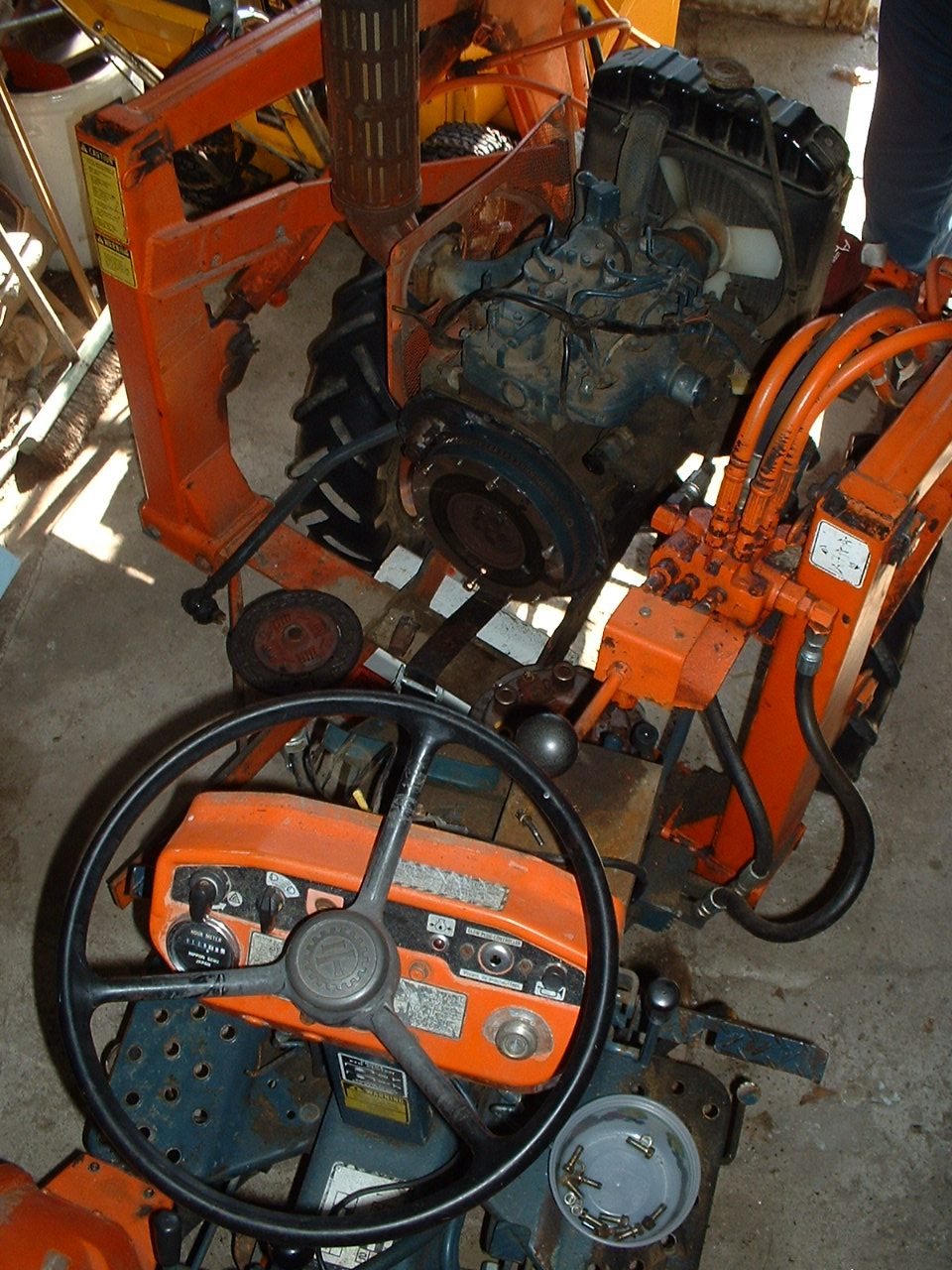

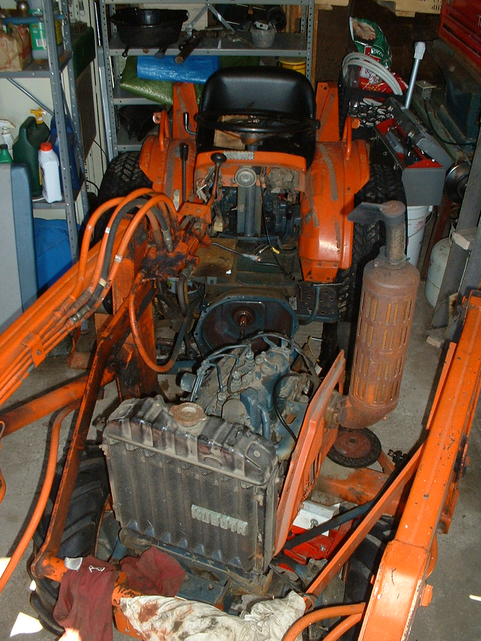

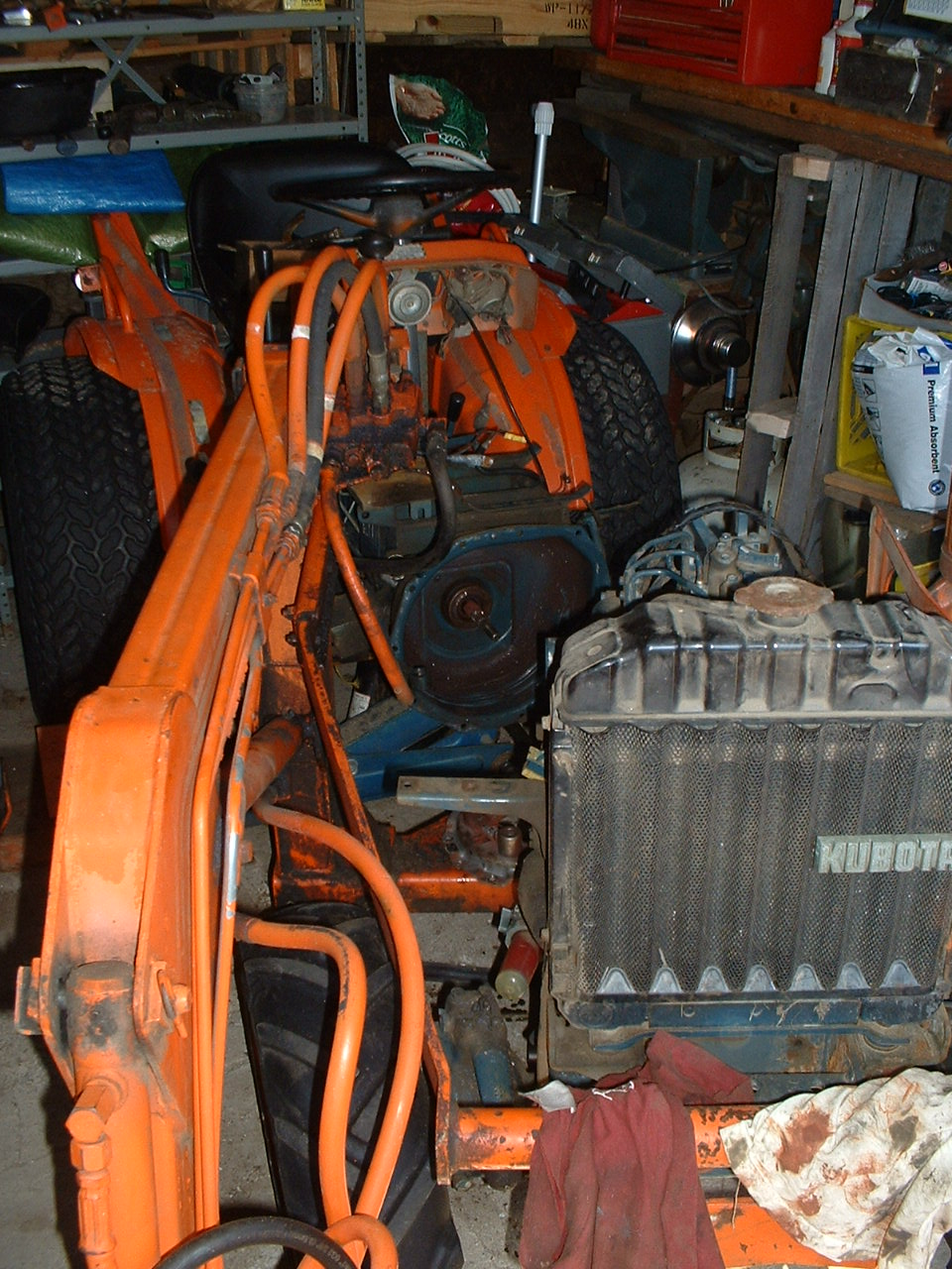

I can try, it's a small garage so not sure how far I can get back. After I posted them I was thinking some were too detailed. These ones were more for knowing how things will go back together. Here's a question for someone who's done this on one of these little tractors, where'd you get the tool to line up the clutch disk? Will an auto parts place have one to fit? Thx.
You can eyeball it or trace the shaft back towards the rear end and there is a coupler, loosen that and you can extend the shaft forward a few inches... this was just enough for me to get the clutch aligned etc when putting it back together.

Mike...re centering the clutch disc...I have had great luck over the years using a piece of an old broom handle or a wooden dowel of the correct diameter to fit through the splined hole in the disc. The wooden broom handle with a rounded end works well to center in the pilot bearing, otherwise I whittle the end of the dowel to fit the pilot, being careful to centre my whittling.:rolleyes: The last clutch I replaced actually came with a plastic tool that saved me the whittling!:D
Good luck with it.

Most auto parts houses have inexpensive (plastic) alignment tools to line up the clutch plate. You will need the ID of the pilot bearing and the OD of the splines on the input shaft. Probably will be metric. I have a universal tool that is SAE that I have been using but the cheap tool is adequate.

Here's a couple pics from back a bit. Please disregard all the stuff in the garage.

The old tractor is finally back together and running. I did have a glow plug issue, just a loose connector though. The clutch pedal is now adjusted properly so hopefully this clutch setup will last forever. Total time somewhere between 7-8 hours including some repair work. It's good to hear the old diesel run.
   / Sad day for my B6100 :-( #30
Great to see you have it up and running. It doesn't look like the small work space helped you doing your repairs. What did you end up using to align the clutch plate etc. Not a broom handle hopefully. :)
