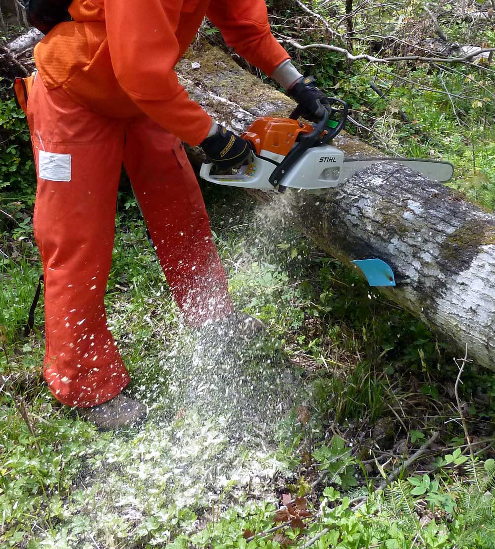

I have two Stihl chain saws. A big one with a 24" blade and a small one with a 14" blade. The small one because I kept cutting with the big one when tired. I tested my steel toed boots.
