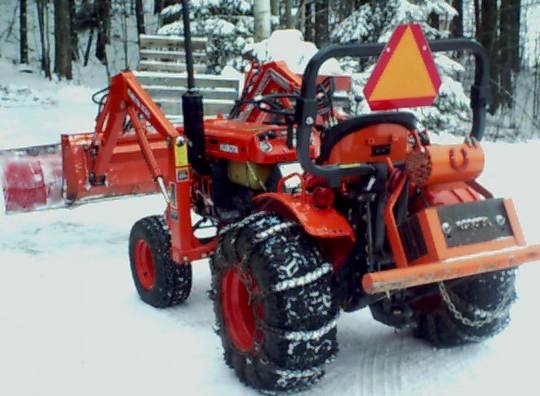

All kidding aside, here is photo of Thomas NH's Kubota with a modified ROPS. It sure looks stong to me.

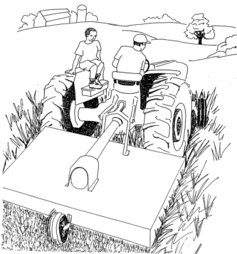

Re: Safety Tips - No Extra Riders...Please...!
Spending some quality time...? brush hogging on a beautiful day... {Part 1 of 2}
