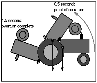

Re: Safety Tips- In a blink of an eye you are DEAD
“Don't gamble.
<font color="red"> A tractor cannot turn over by itself. It only does what you - the operator -command it to do. </font>
Many overturns are related to using bush hog mowers, because we tend to place the tractor in precarious situations attempting to cut all offending vegetation.
Tractors must obey the laws of physics. When you try to cheat on those laws, you lose!...
“Almost all overturns can be prevented by safe operating practices…”
“Tractor overturns occur too fast for you to jump clear in most cases...”
“Unless you are expecting the tractor to flip, your reaction time probably will be even longer (you have a problem if you are expecting it to flip)…
“Proper ballasting maintains proper balance for stability and control…”
“Additional front-end weights are needed when using heavy 3-point hitch mounted cultivators, mowers or other heavy implements and when moving round bales of hay. You are not in control of the tractor if the front wheels lift from the ground when engaging the clutch or starting up slopes or if the front wheels slide when attempting turns….”
“Many overturns occur on relatively flat ground…”
PREVENTING and SURVIVING TRACTOR OVERTURNS
(PDF file)
(Download this, print it out... anyone that uses your tractor... require mandatory reading... it WILL save their life!)
Please don’t end up being foolish DEAD… by not following proper safety procedures… Be smart and stay ALIVE… with Safety…
Good reading, John. I like the part where it says "a slope is too steep for safe operation if you can't back up it." Good advice.
   / Safety Tips #139
I think that was a great safety message in general.. but I do have one question....
Unless you are using a peice of chain for a toplink / and / or using a drawbar mower.... I would think the standard run of the mill 3pt mower would tend to act as a stabilizer.. or a wheelie bar per se...... Other opitions on this....
Soundguy
   / Safety Tips #140
I think my 3pt hitch brush hog has a piece of chain in the top link for flexibility and the A frame is just bolts running through the sides. If the tractor were to wheelie, the brush hog would not stop it(at least mine wouldn't).
