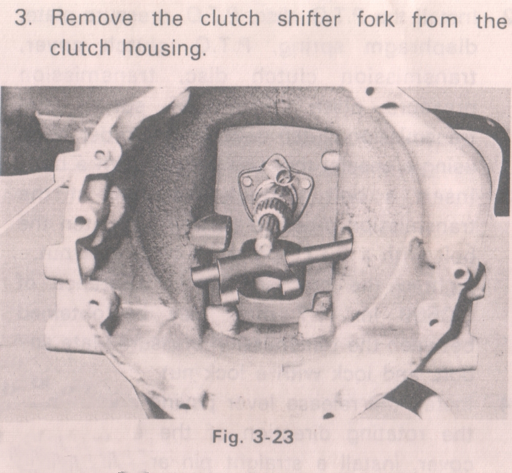

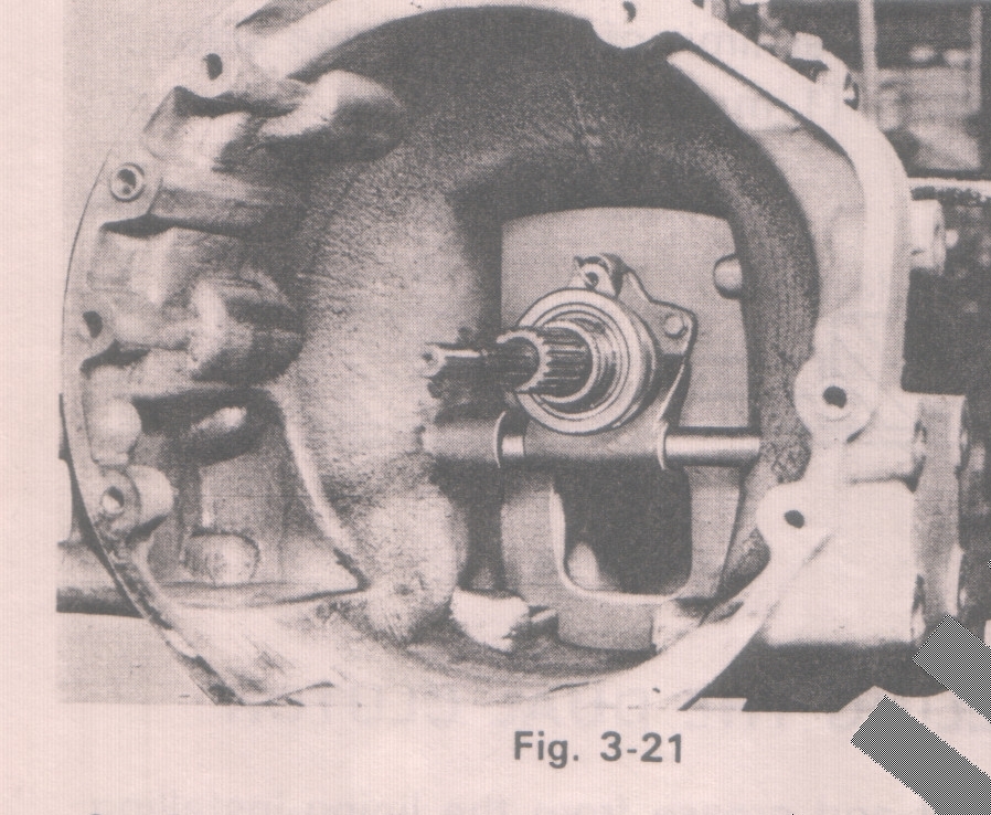

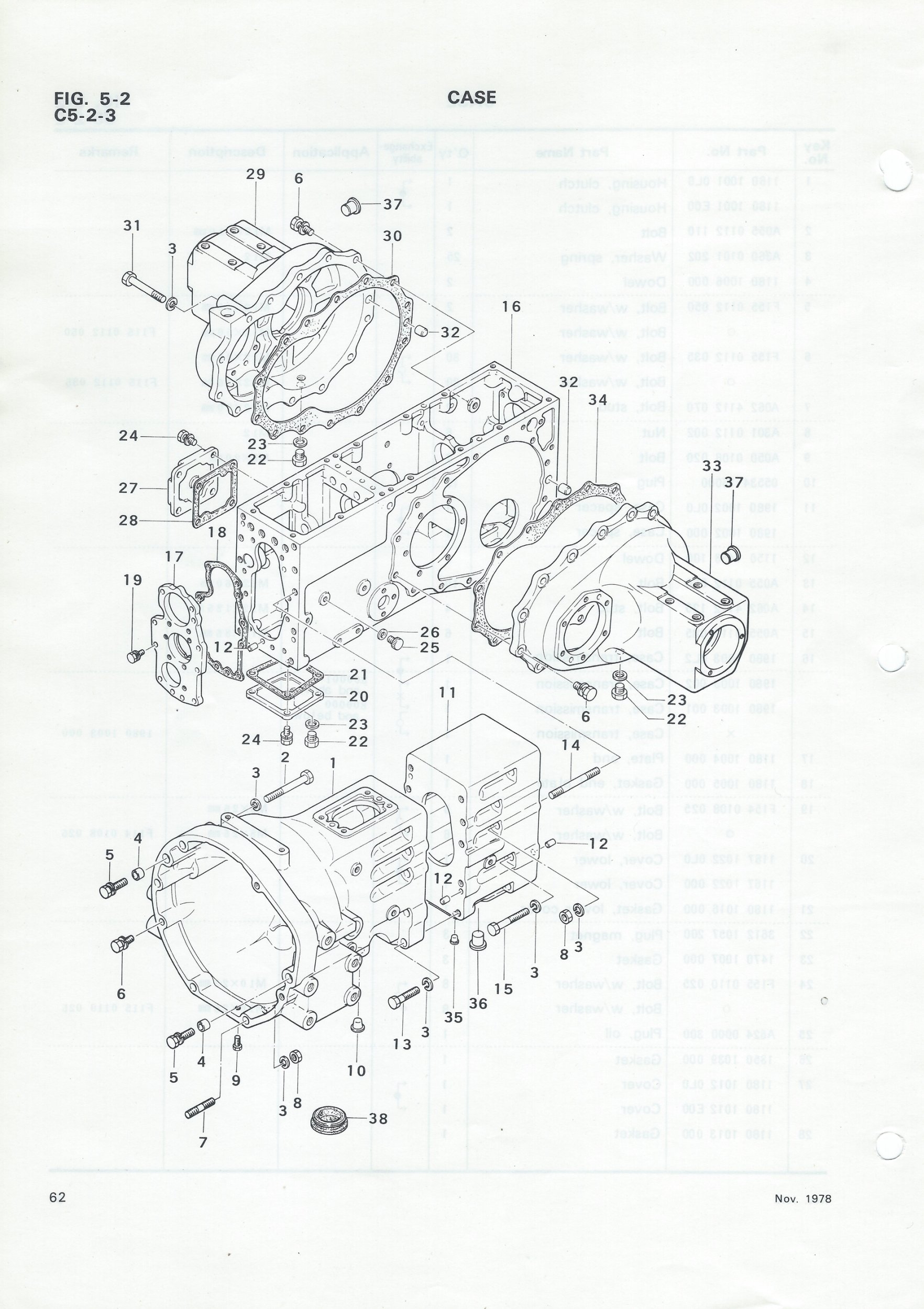

I found an old scanner and got the pictures (belatedly). I will try for the expanded view, but that will be more difficult (using trial version software, proper driver not available for Windows).

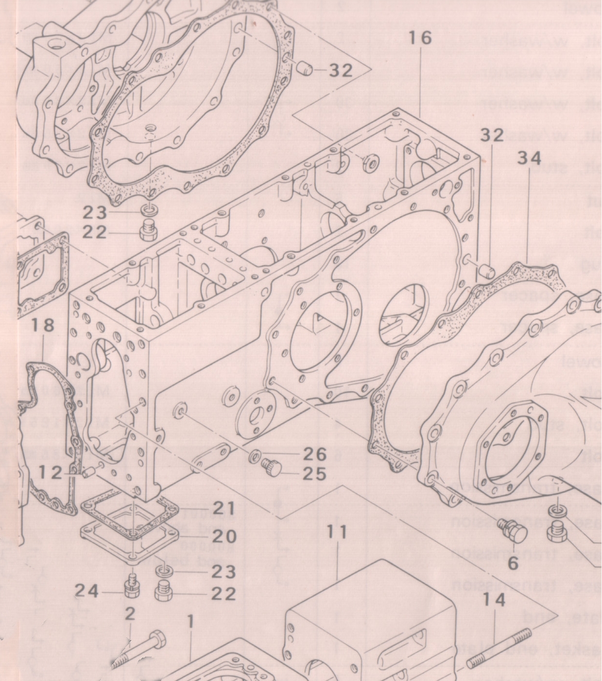

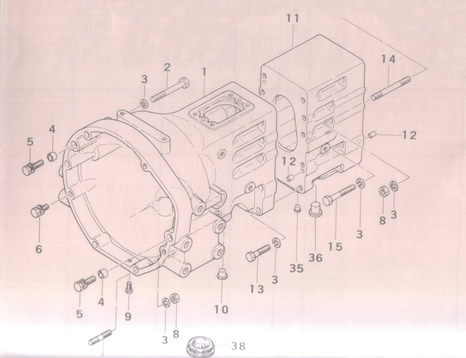

Here are pictures of the case. I had to make two separate pics, but if you will notice the reference numbers 2, 1, 11, and 14 in both pictures, I think it is obvious how they correspond.

I will definitely have to remove the next two pieces of the case, but don't expect to make it back to the tractor today. I may be able to get the exploded view scanned. I have some old computers that should work with my old scanner, or I can scan to flash drive if I can locate that scanner.

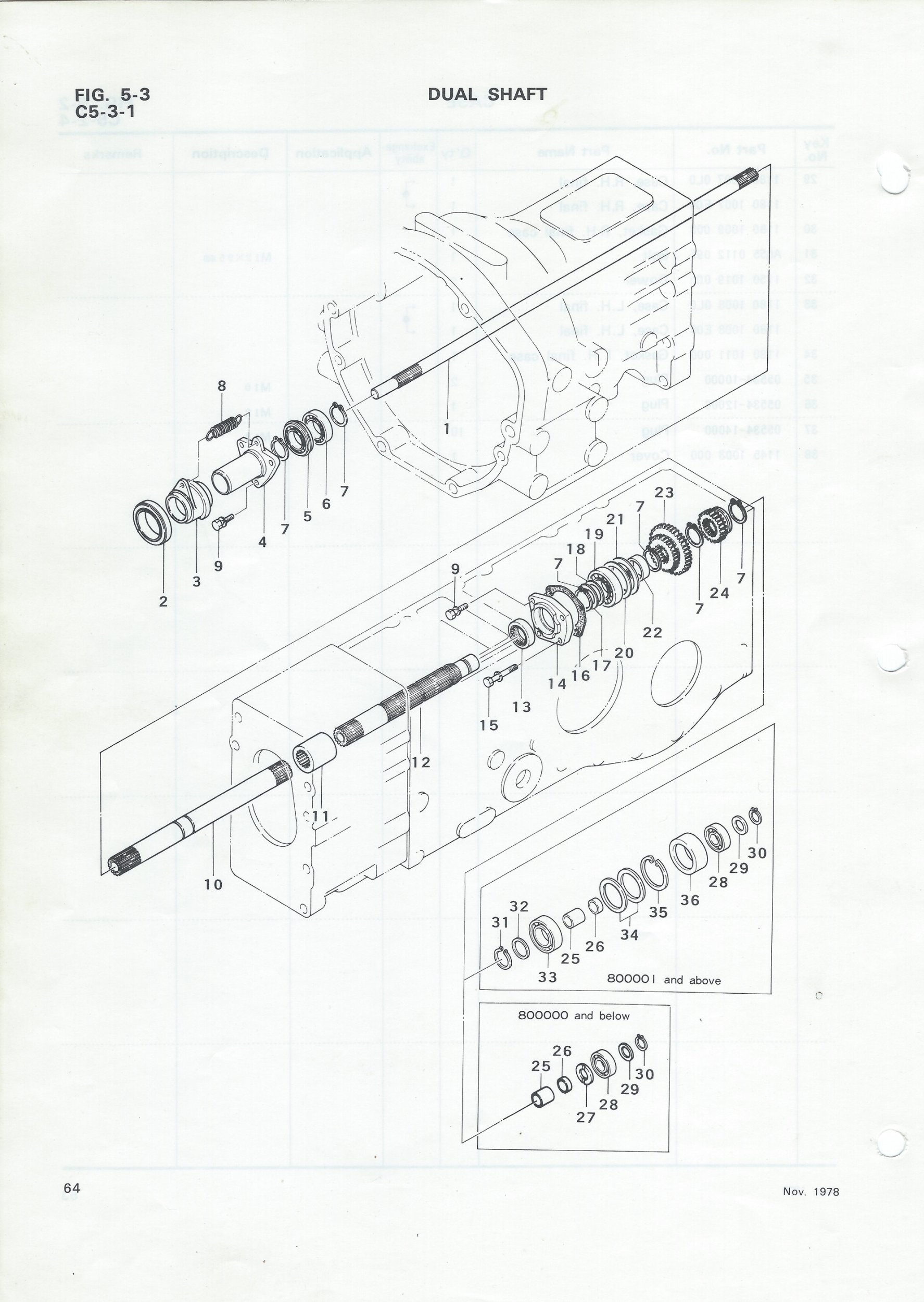

Found my scanner.

So where is your input shaft bearing and seal? Is it in plate 17 in the first pic? If so looks like you will need to remove both bell housing and spacer to get to it

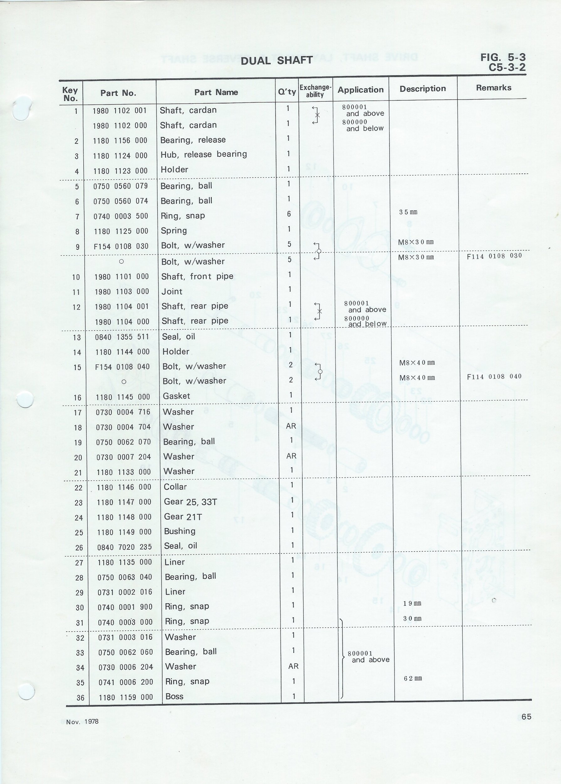

Yes, I will have to remove the bell housing and spacer. The seals are number 13 in the top diagram and number 26 in the lower diagram. I have just finished scanning in the parts list.
