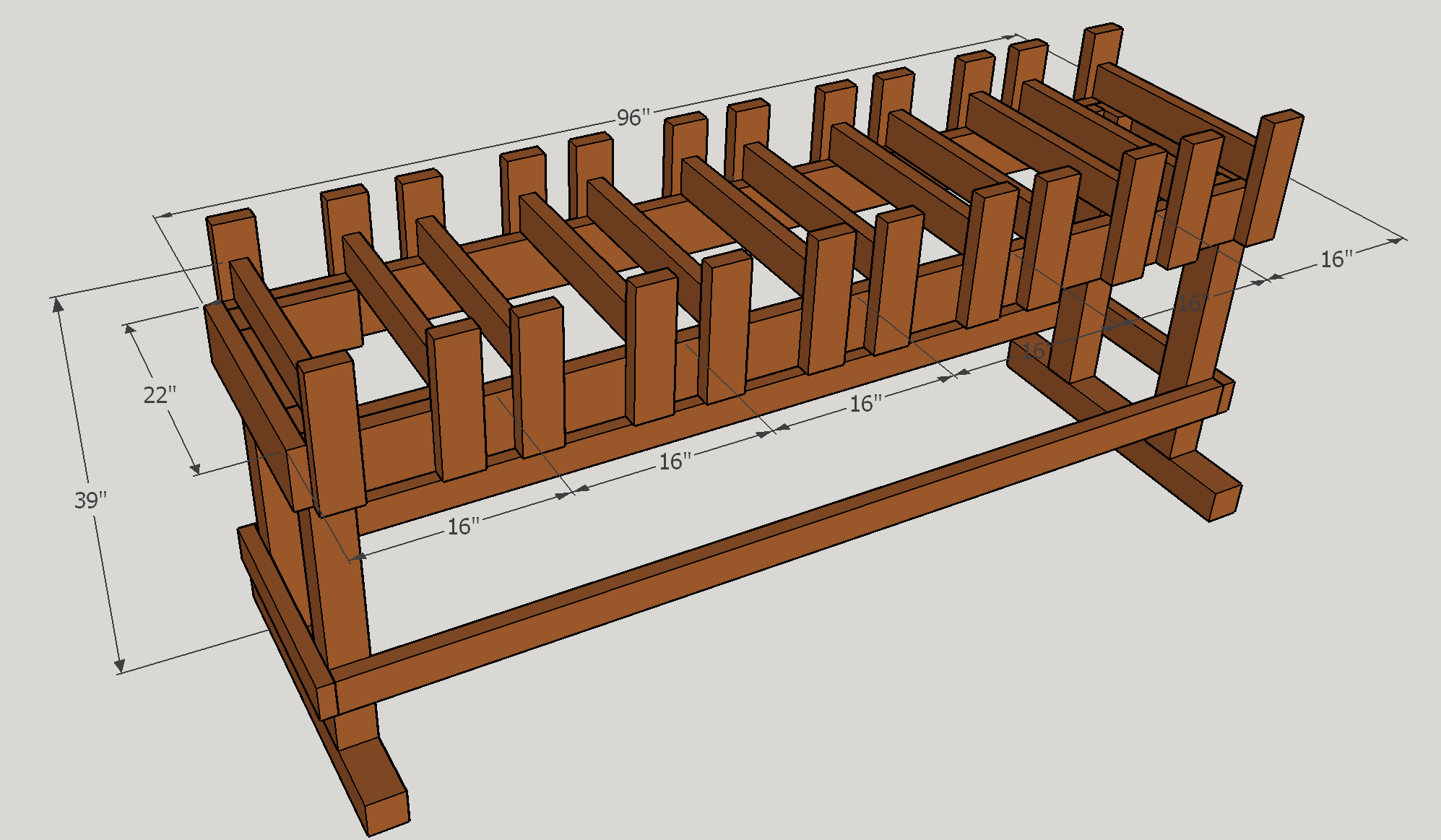

My log bucking rating is about 1/2 a notch above novice. I kick logs around, maybe teeter them on something, aim for 16" and try to keep the chain out of the dirt. I recently took down 11 trees, some maybe 75+ feet tall. Needless to say, I have a lot of cutting to do. I've got a Fiskar X27 and a mean swing so I think I'm set on the splitting, but cutting these logs down to size is hard on the ol' spinal fusion.
I think it is time I construct a sawbuck. I have been tinkering around with some designs, but I haven't really liked any of them. It seems that the designs I have seen on Google either require moving logs around or still allow the log to bind on the chain or pieces drop all over.
I was hoping I could throw my design up here, explain my thinking and you guys could tell me why my design sucks so I can get to something better.
My thoughts on this are that I can use Pedro to throw a log up and I can then cut @ 16" with both ends of the cut pieces and remaining log always supported. The pieces shouldn't fall to the ground so I won't have to bend over so much. The span is supported by 2x6 lumber with 2x4s perpendicular to raise the log up so I don't cut into the frame. I considered a 3rd 2x6 in the middle, but figured it would get in the way and I'm thinking that 2 would be enough. I've got small 2x4s on end to keep anything from rolling off. I thought about notching the 2x4s to allow a log to park itself, but I don't know if that is necessary either. For the height, I really just took a guess. I'm 6'3" and the higher up while still being able to safely cut it, the better.
I would appreciate any thoughts and criticism or if you wanted to post better ideas.

If its made out of wood, my guess is sooner or later, Pedro will crush it.
I heat with wood. So here's what I do if I need to buck wood elevated...
What's worked well for me is item #T3151, 30" pallet forks for $400. Lift the log up to your preferred height and start lopping off 16" pieces. Reposition the tractor when you get to the forks. Then use the forks or the light material bucket item #T3062 $450, scoop them up and dump them in a pile by your splittter.

I have to agree with MossRoad since you already have the PowerTrac. Letting the tractor do the lifting and repositioning etc saves a lot. I use a buck but it is only for smaller stuff so that I can cut many at one time and the pieces are all in one place. I also do this in the woods so my buck is very light and easy to handle so I place it near where the wood is and bring the 8-10' pieces to it and then cut away. Bucks for logs were nice before hydraulics but since then I am not sure of the usefulness.

Used the mini-hoe today. Put the wife in the captain's seat and walked her through what to do. Worked awesome and was pretty quick. Scraping the idea of a sawbuck for now. Thanks everyone for the feedback.

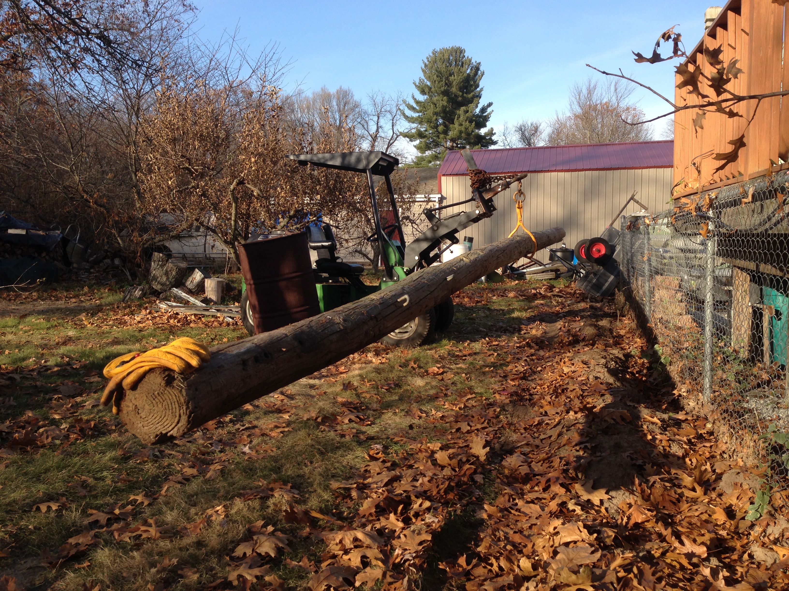

I have used my 4-in-1 bucket to grab and hold 20’ logs (not too big around). I grab it in the center and hold it up at a comfortable sawing height. Then I cut down from each end. Works great.

You can use logging tongs to lift up one end and then undercut each chunk. I prefer a grapple bucket or mini hoe but I have used tongs as well.

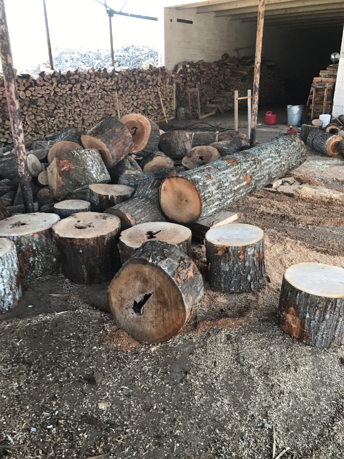

While I still had my backhoe I used it. Now I pick up several logs on the forks. I have to leave 4 feet of the last log but that still beats cutting it all on the ground. The 4 foot section is easily rolled by hand so it's not much trouble to make 2 cuts in it. Once I get a decent pile of rounds cut I usually drop a load on it to be cut and then get another load on the forks. That reduces the time wasted between sawing and tractor operating. Cutting the logs on the rounds usually isn't bad either because there's no dirt or rocks to worry about hitting. If I've got a log suspected of having metal I'll set it on blocks so I can check it with the metal detector. IMG_0747.JPG

I can certainly see cutting them on the forks as the logs would be much more stable than hanging in the tongs.
