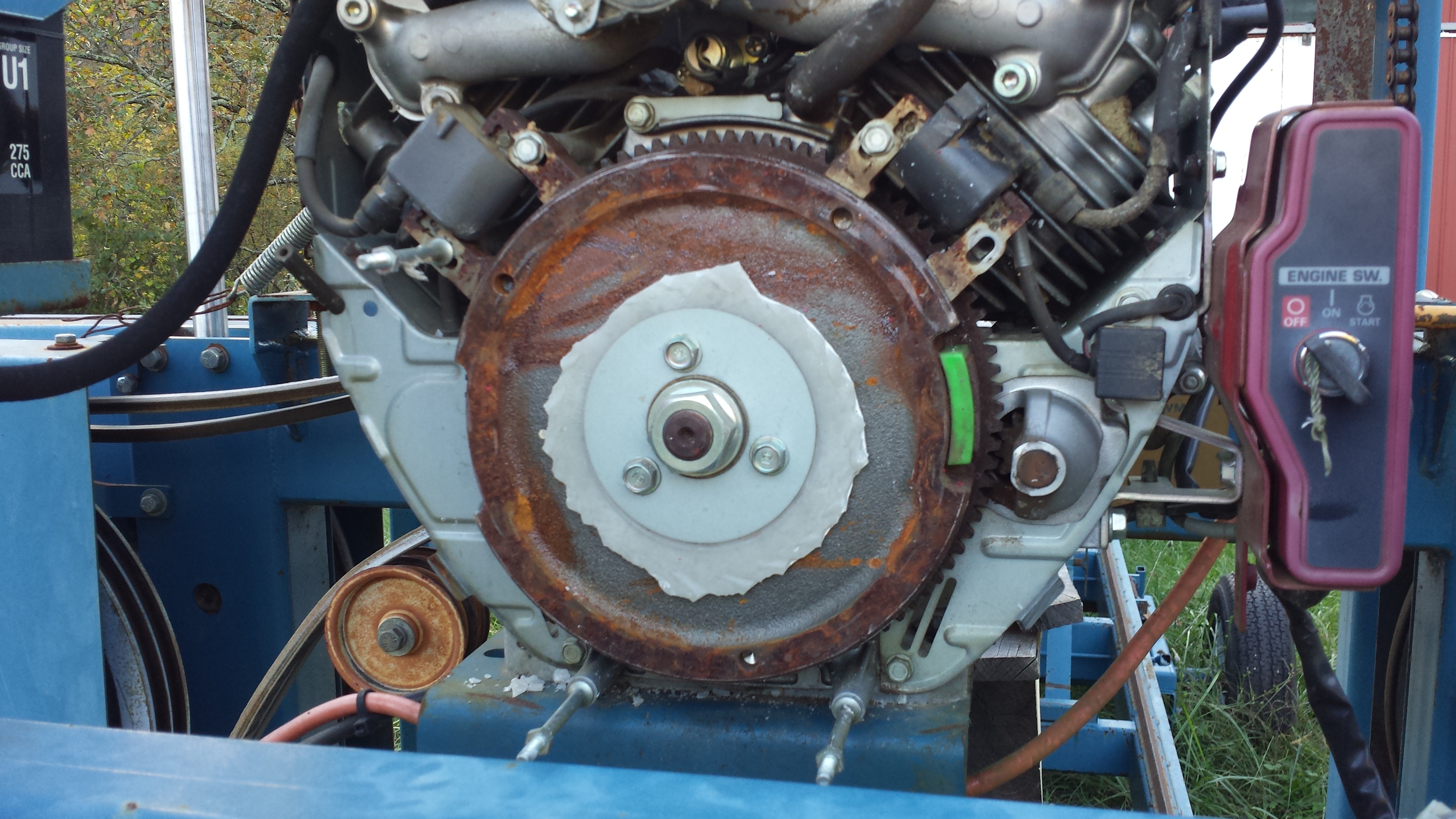

My Honda engine on my sawmill decided to disintegrate the cooling fan yesterday.

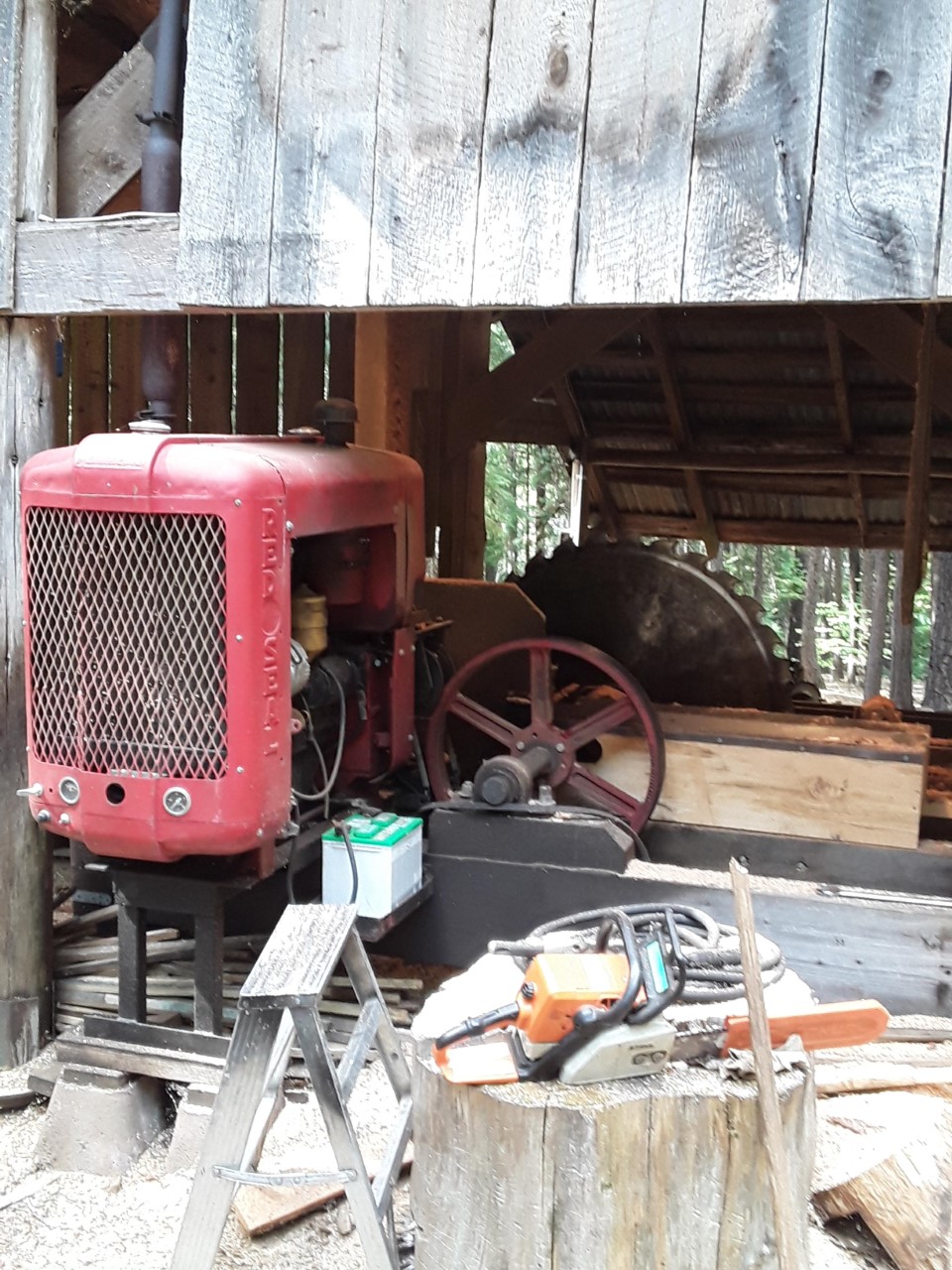

Viking. I remember all the travelling amusement park rides were powered by those kind of engines. With some crazy Carny operating the throttle.
These motors were used here primarily to power sawmills , farm water pumps and used in the mining industry. This one we found in a field 40 years ago and rebuilt and put on the mill. The Volkswagen motor was not up to the job but this one was and still is.
Hope that Forgeblast gets it figured out and mills the logs.
