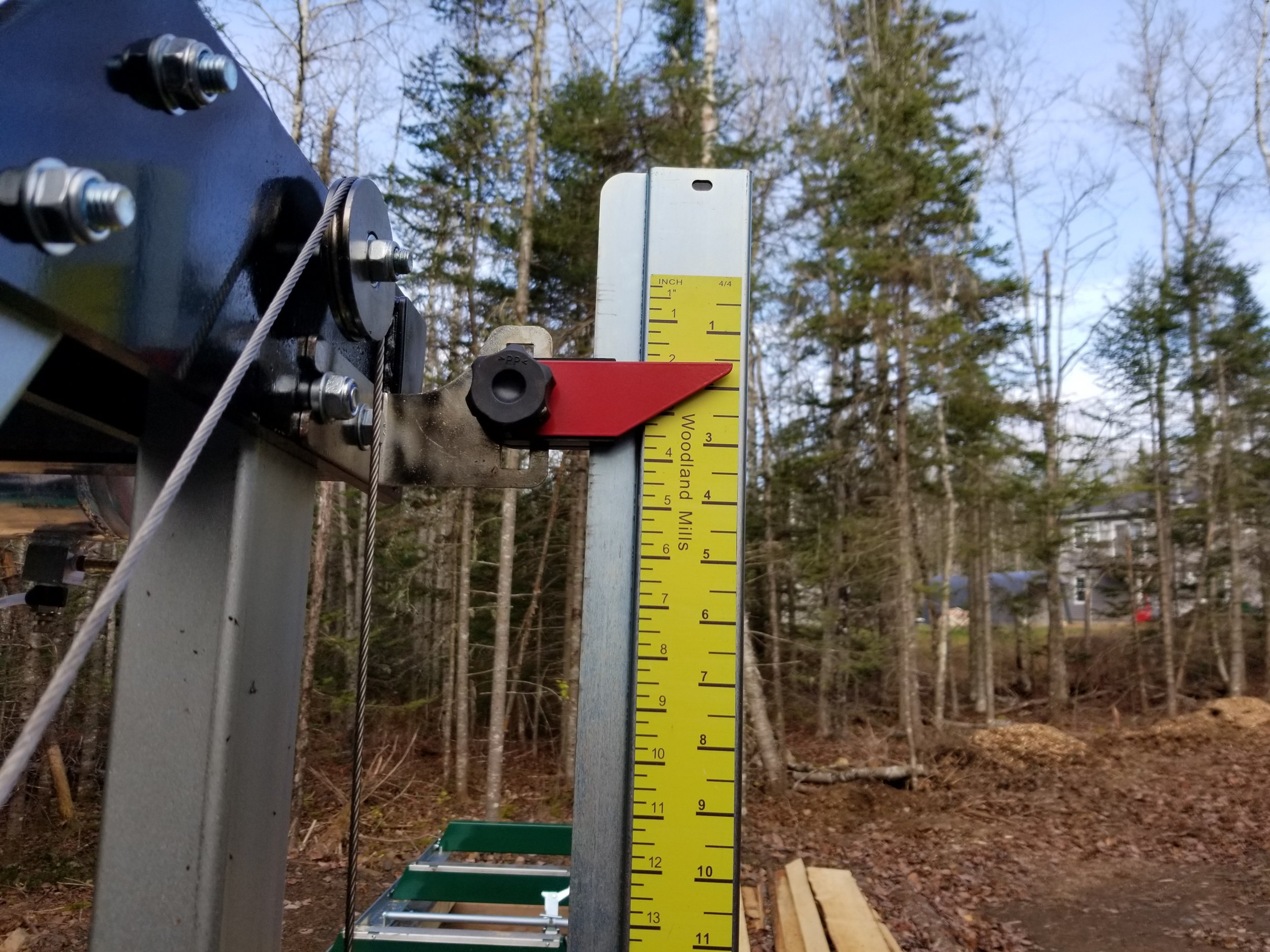

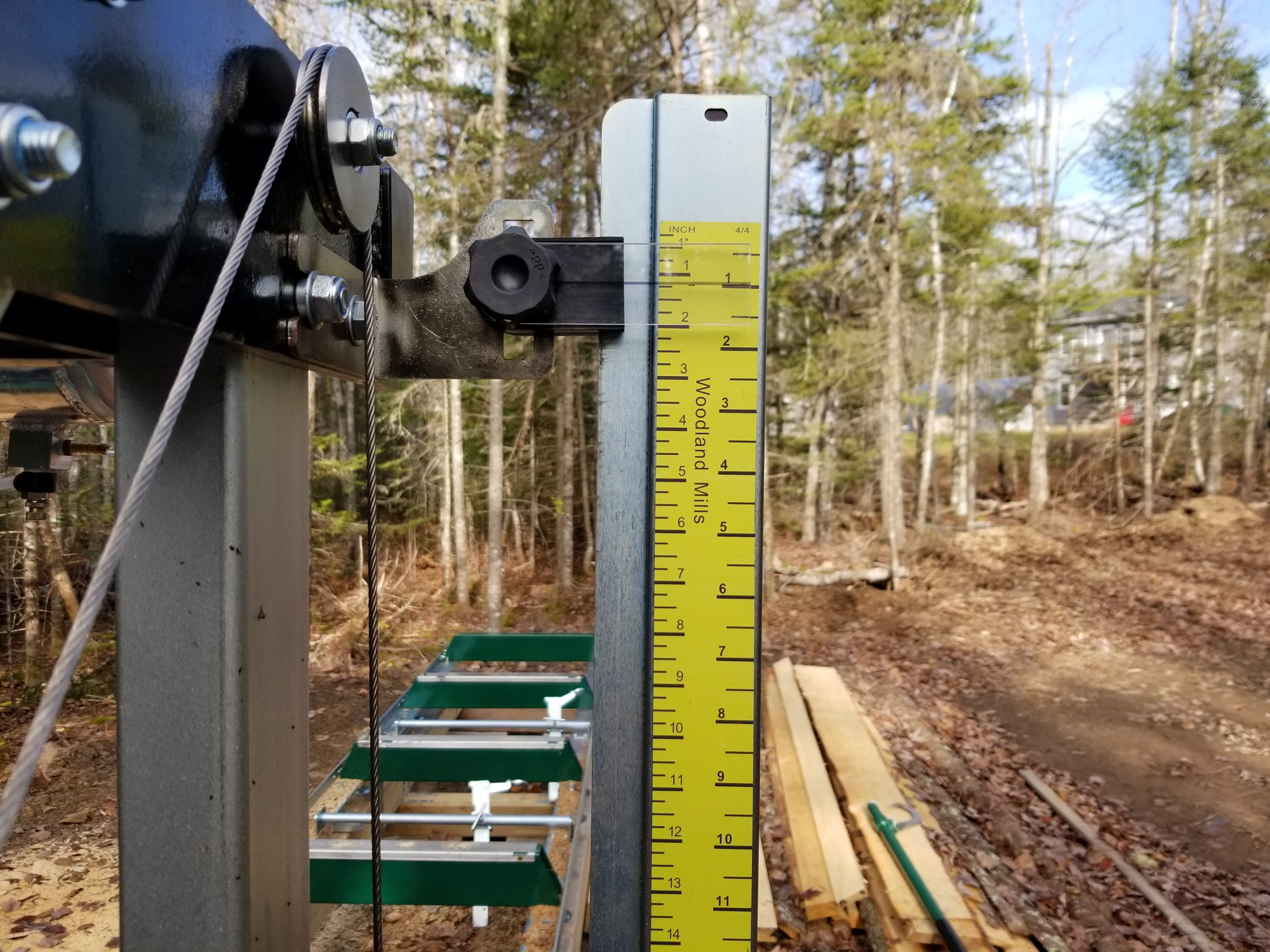

The pointer on my log scale was annoying me. It obscures an inch and a half of the graduations when moving up and down. I noticed on some of the other woodland mills sawmills that they had a clear pointer so I made one out of Lexan for my 130 to try it. I like this way better. It was throwing me the way it was so this is a good fix.

Resetting the rule on a woodland mill saw is really easy. Once the saw head is adjusted to level you simply put the magnetic rule on the metal post and slide it up and down behind the pointer to match the height of the blade off the bunk . I like its simplicity.

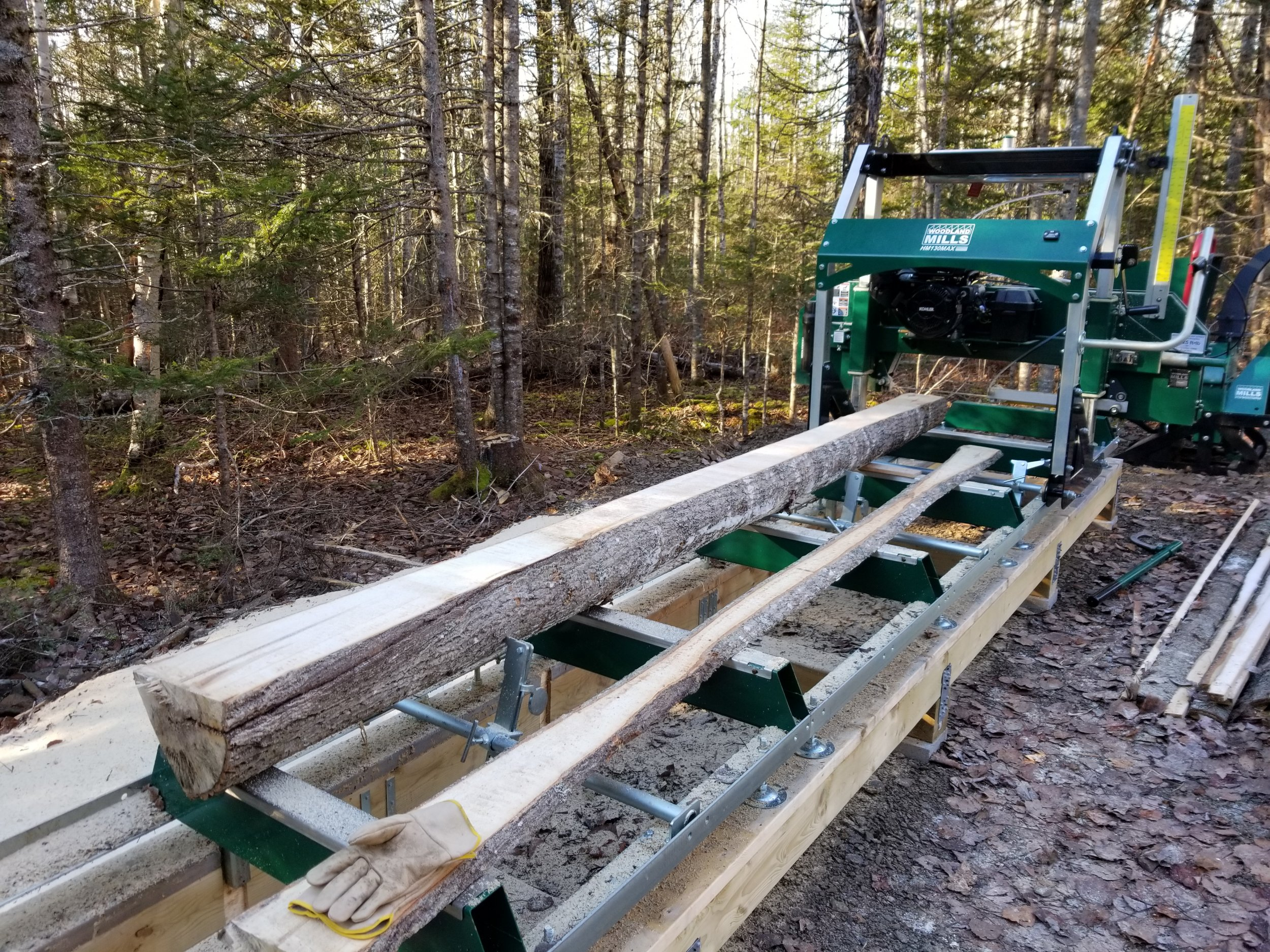

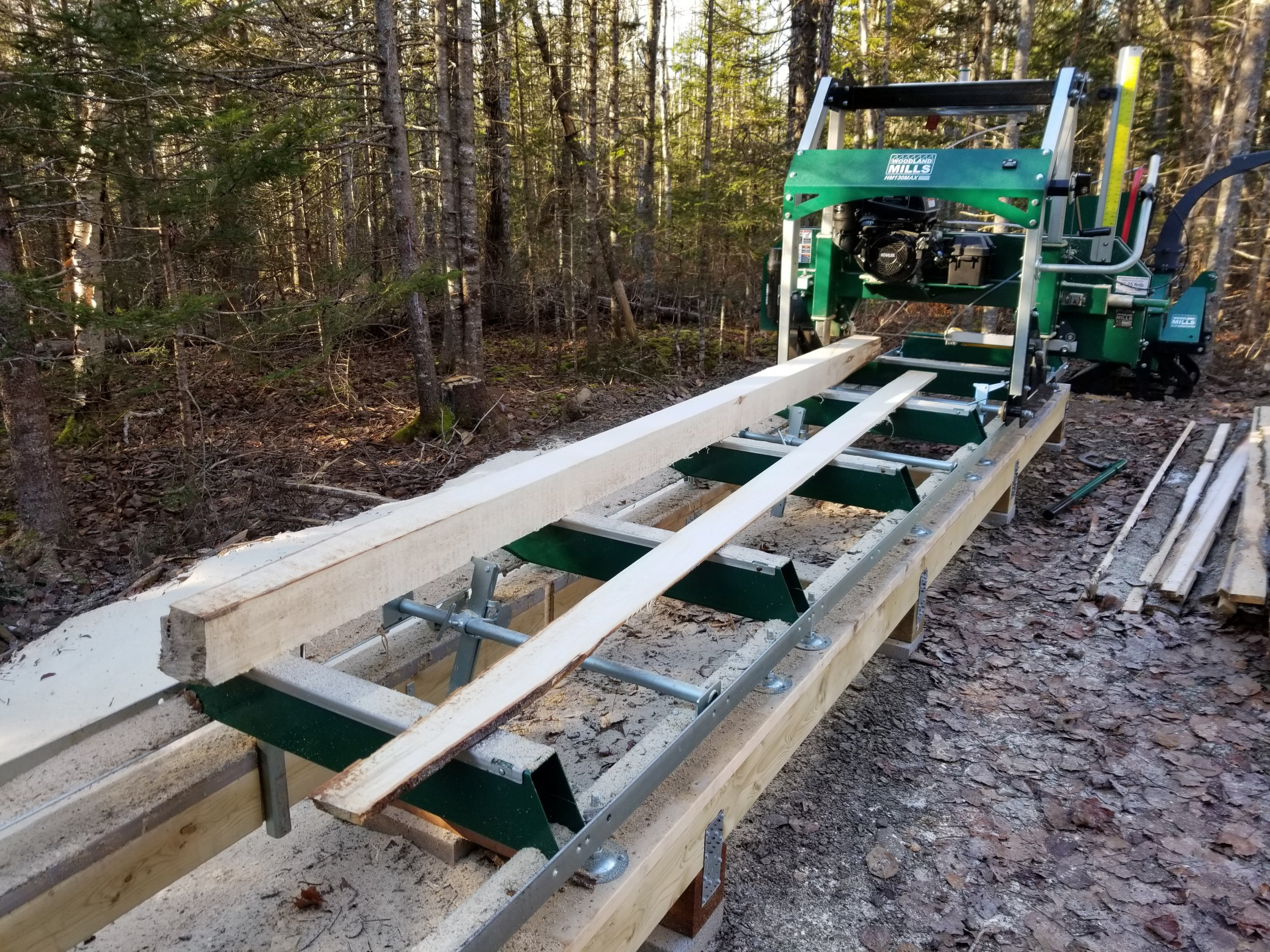

I cut my first couple of poplar logs on the mill today. (the first bunch of logs on the pile were spruce).
It is really nice and white as opposed to the green hue that a lot of poplar that we sell at my work has. I am not sure of the exact type of poplar I have but there is a ton of it on my property. I will do a little research just for the fun of it .The color should make it more stainable and more desirable for selling. Once I get my solar kiln up and running this stuff should sell well with the weekend warriors . Great for furniture and such.
One thing I did notice is that there is more tension in it than the spruce. When I got to my last cut the last piece on the saw bunks had a bit of a bowtie effect going on. It was slowly bowing more the whole time. When I get to cutting stock for the kiln I will try taking a bit more care and flip the cant every one or two cuts to bring the wood back some. I am guessing it is the same as planing lumber . If you take it all off one side your wood will almost always bow. I have lots of time and I don't want to have the last piece misshaped every time.

Poplar makes some nice boards. I hope to eventually saw out a few, although most of my larger trees have already been sold to the OSB mill. Still it grows fast, and I think it would make a nice interior if I ever build a camp.
