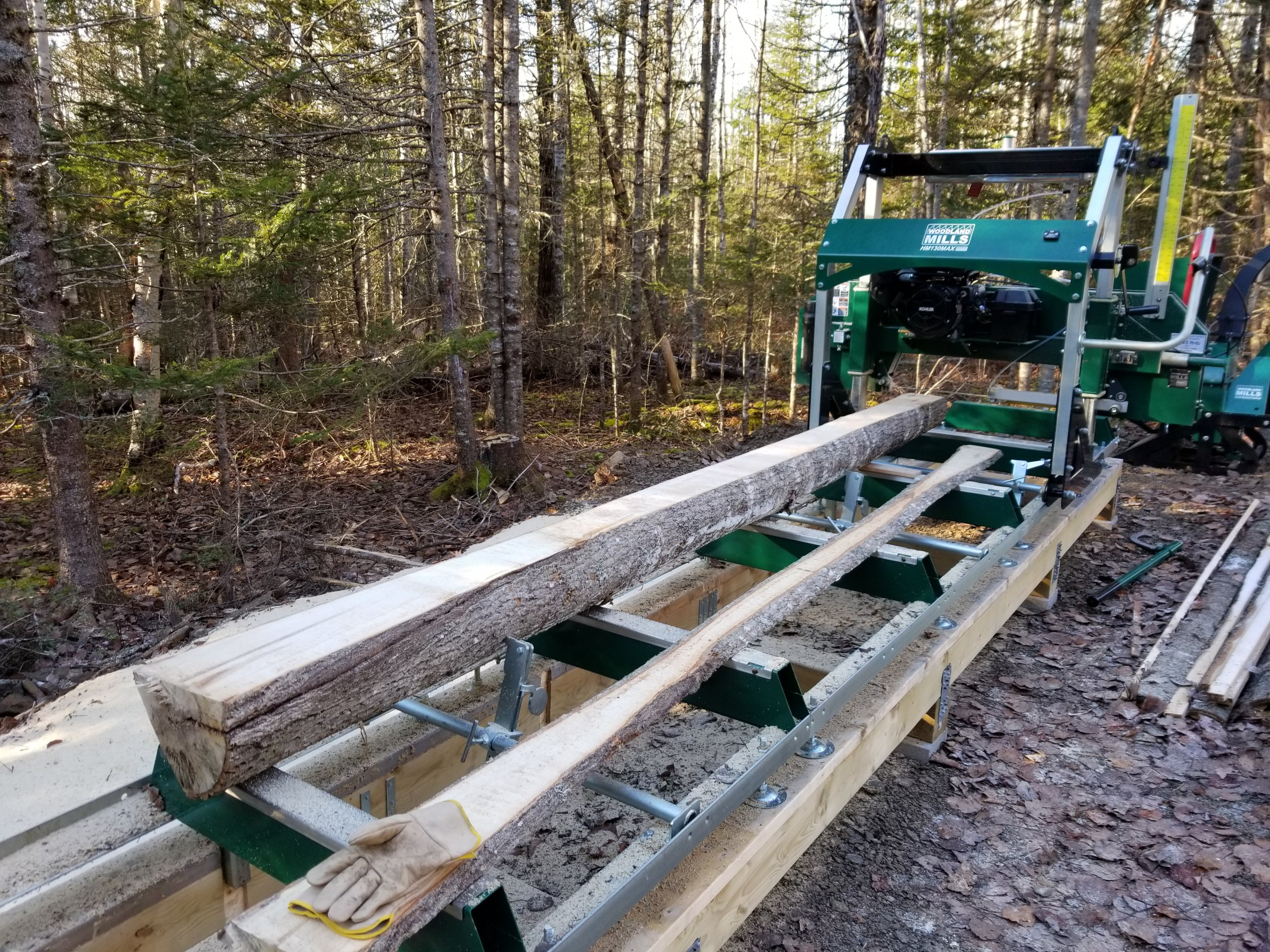

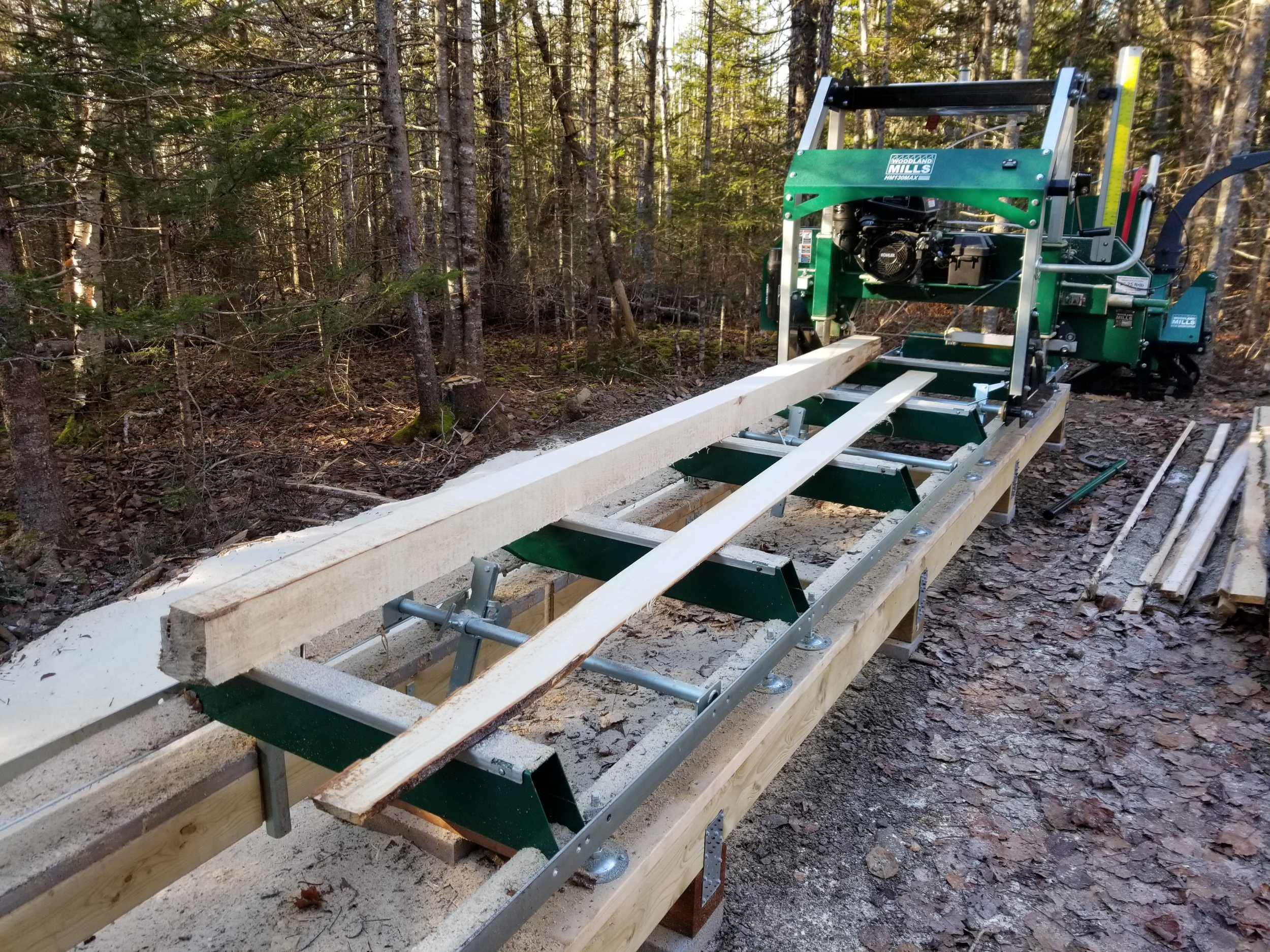

Keep turning that log to saw the tension out of it.

I cut my first couple of poplar logs on the mill today. (the first bunch of logs on the pile were spruce).
It is really nice and white as opposed to the green hue that a lot of poplar that we sell at my work has. I am not sure of the exact type of poplar I have but there is a ton of it on my property. I will do a little research just for the fun of it .The color should make it more stainable and more desirable for selling. Once I get my solar kiln up and running this stuff should sell well with the weekend warriors . Great for furniture and such.
One thing I did notice is that there is more tension in it than the spruce. When I got to my last cut the last piece on the saw bunks had a bit of a bowtie effect going on. It was slowly bowing more the whole time. When I get to cutting stock for the kiln I will try taking a bit more care and flip the cant every one or two cuts to bring the wood back some. I am guessing it is the same as planing lumber . If you take it all off one side your wood will almost always bow. I have lots of time and I don't want to have the last piece misshaped every time.
View attachment 771155View attachment 771156

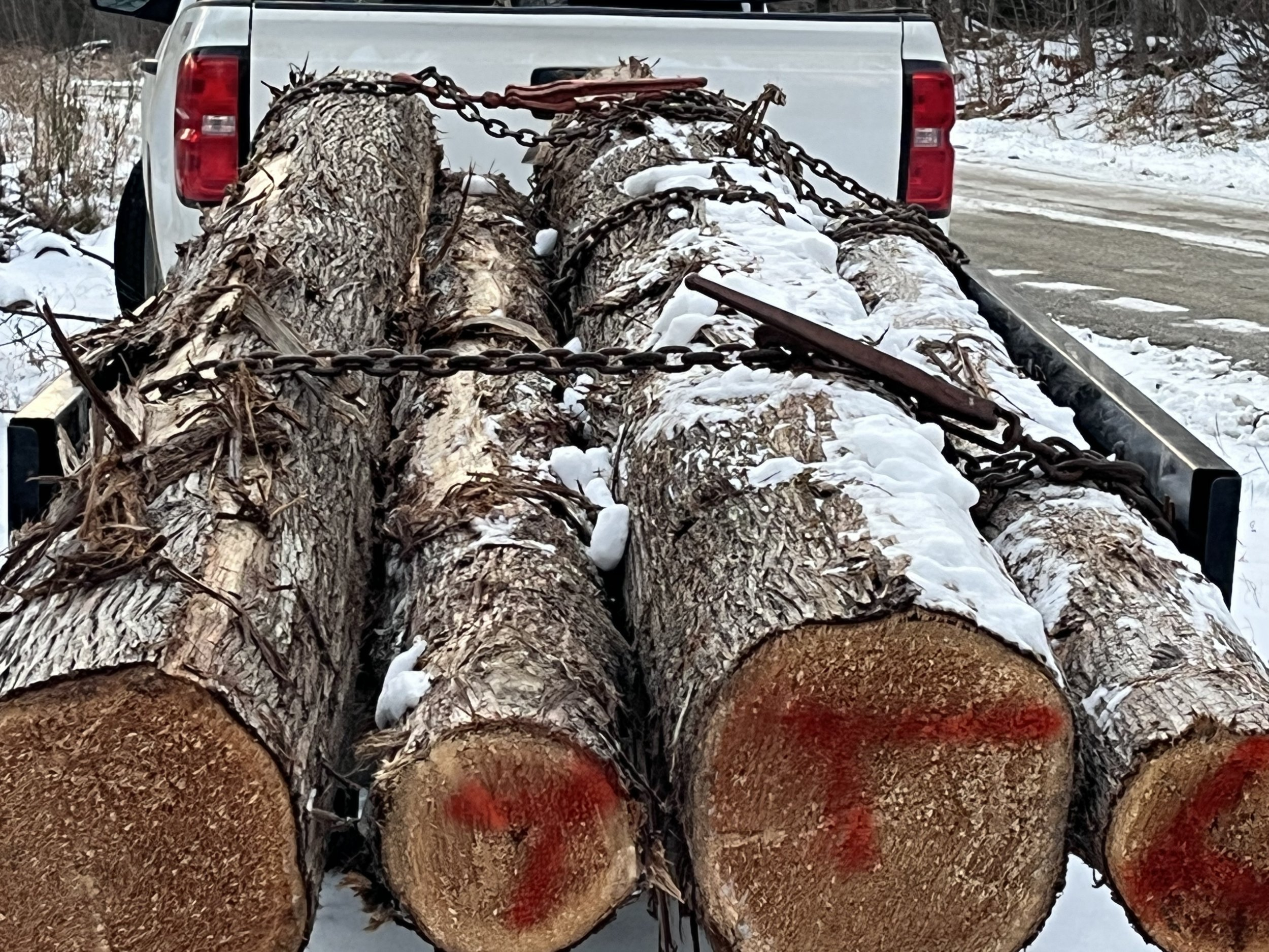

It looks like I'll be sawing this weekend. 👍 These were the only cedar on a job I was looking after this summer, so I bought them. Actually there was one more but after estimating the weight I tossed it off... my little trailer only has a 2000 lb payload. I brought it up, parked next to the pile and they loaded them for me. Good thing, a couple of those are too big to manhandle.

What'cha gonna cut?
Is eastern white??? as durable as wrc?
