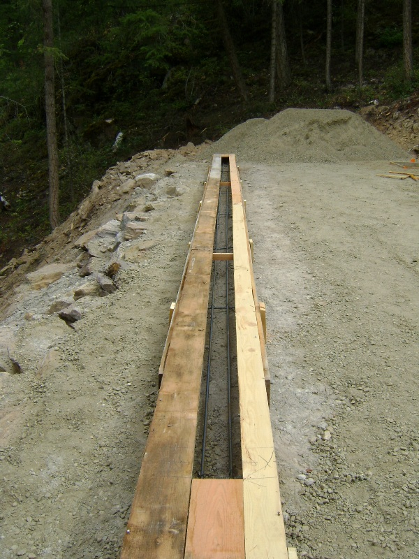

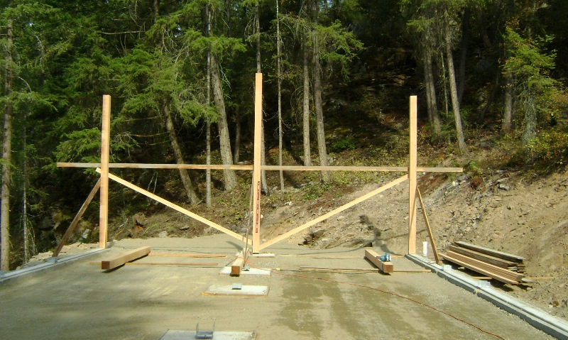

Couple pics Backroad.
3 rows of rebar in side ftings. and 4 rows each direction incenter pads.
Very nice work Billrog. I like the western heavy timber style. Very different from back east. Why do you form the tops of your footings like that. Is it to keep the wall/floor framing up from the moisture line or something else ??

Yes Gordon I put a curb on them to keep the exterior walls and posts above the floor.

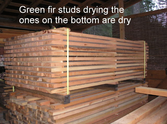

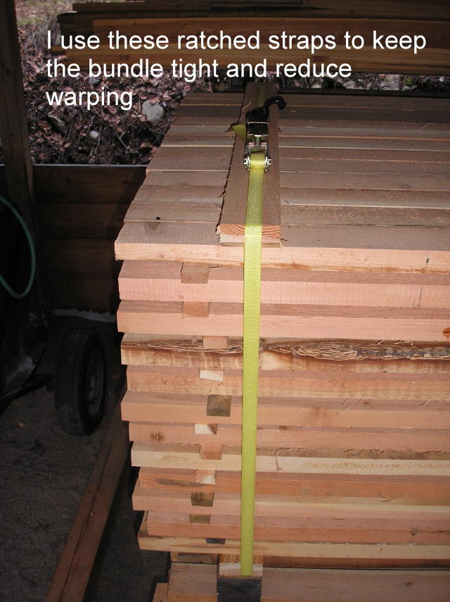

Many ways to deal with warping after stickering the lumber this is the one I found works best for me. You can give the ratchet a few clicks every day or so as the wood shrinks Usually a couple wks. then every wk. or so. Also found it's best to keep the stickers within 2" of the end of the lumber.
If you bevel the end of the top and bottom 2x4 under the strap it makes it much easier to tighten.

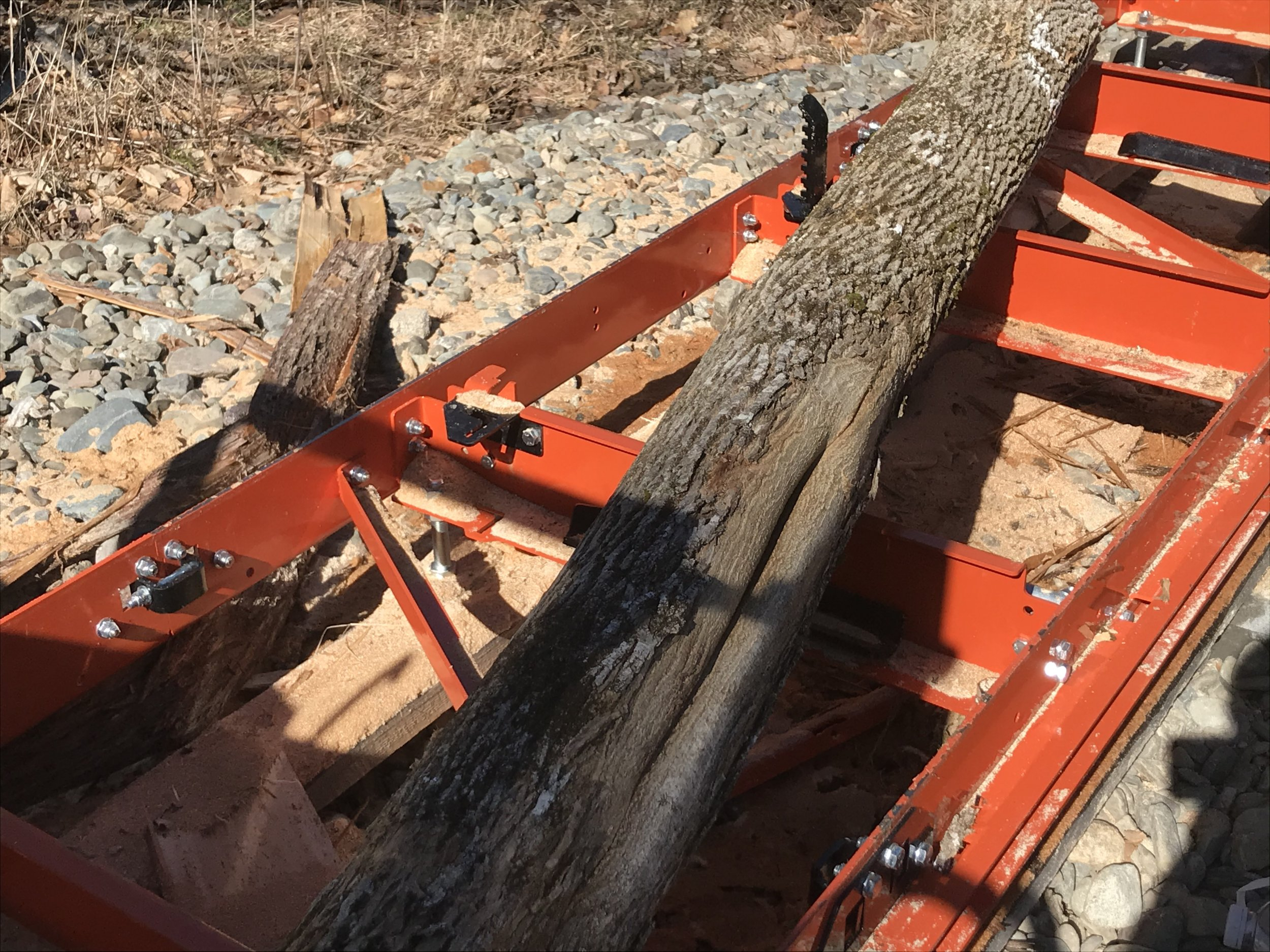

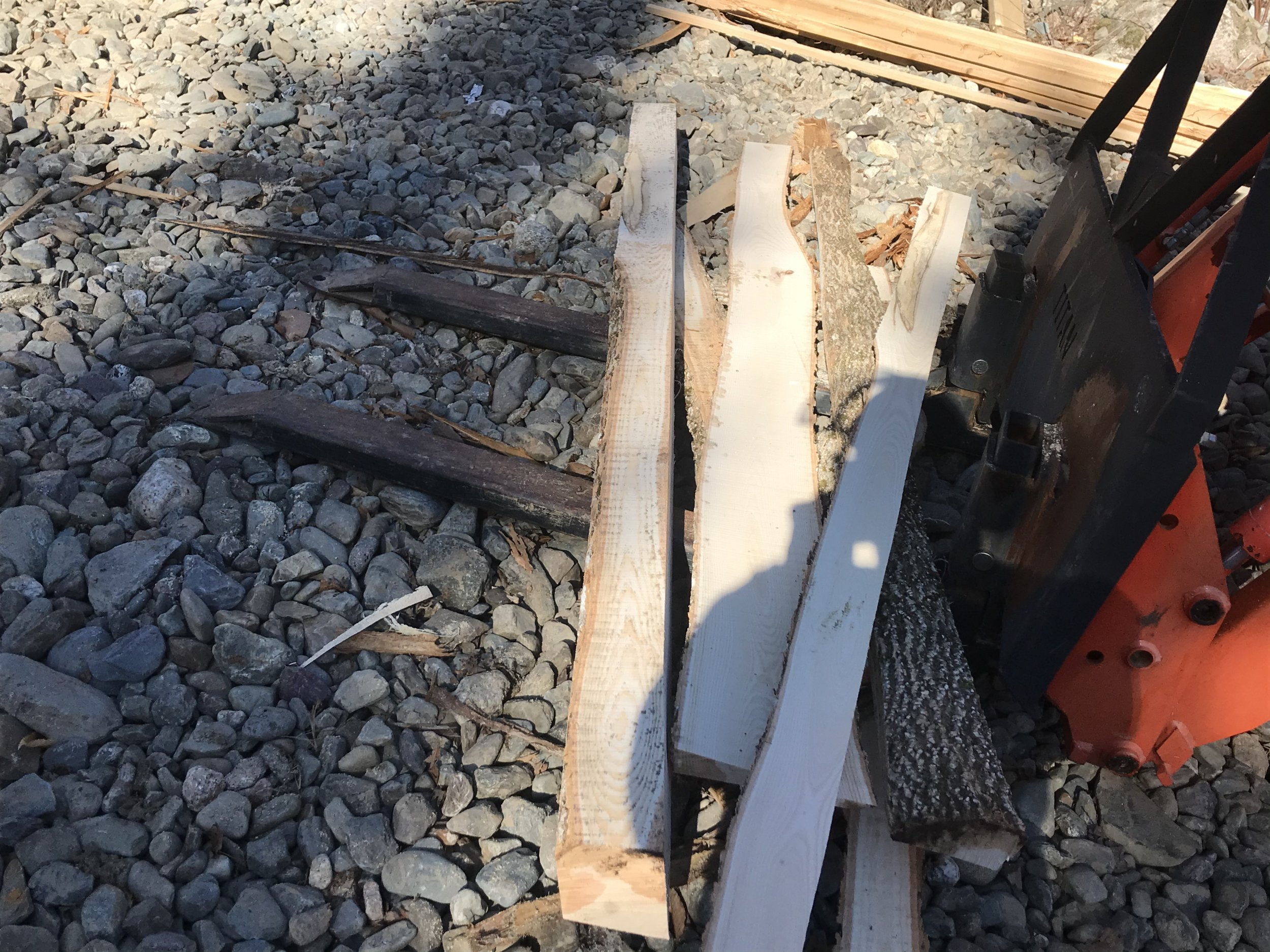

I finally sawed a couple of cedar logs, then decided that I wanted some 4x4s to stack them on. I had a couple of small ash in an area I plan to clear sometime... you could say I tried to polish a turd.:poop:

haha! A fine turd, indeed. You're sawing, and making boards, and that kicks a$$.
