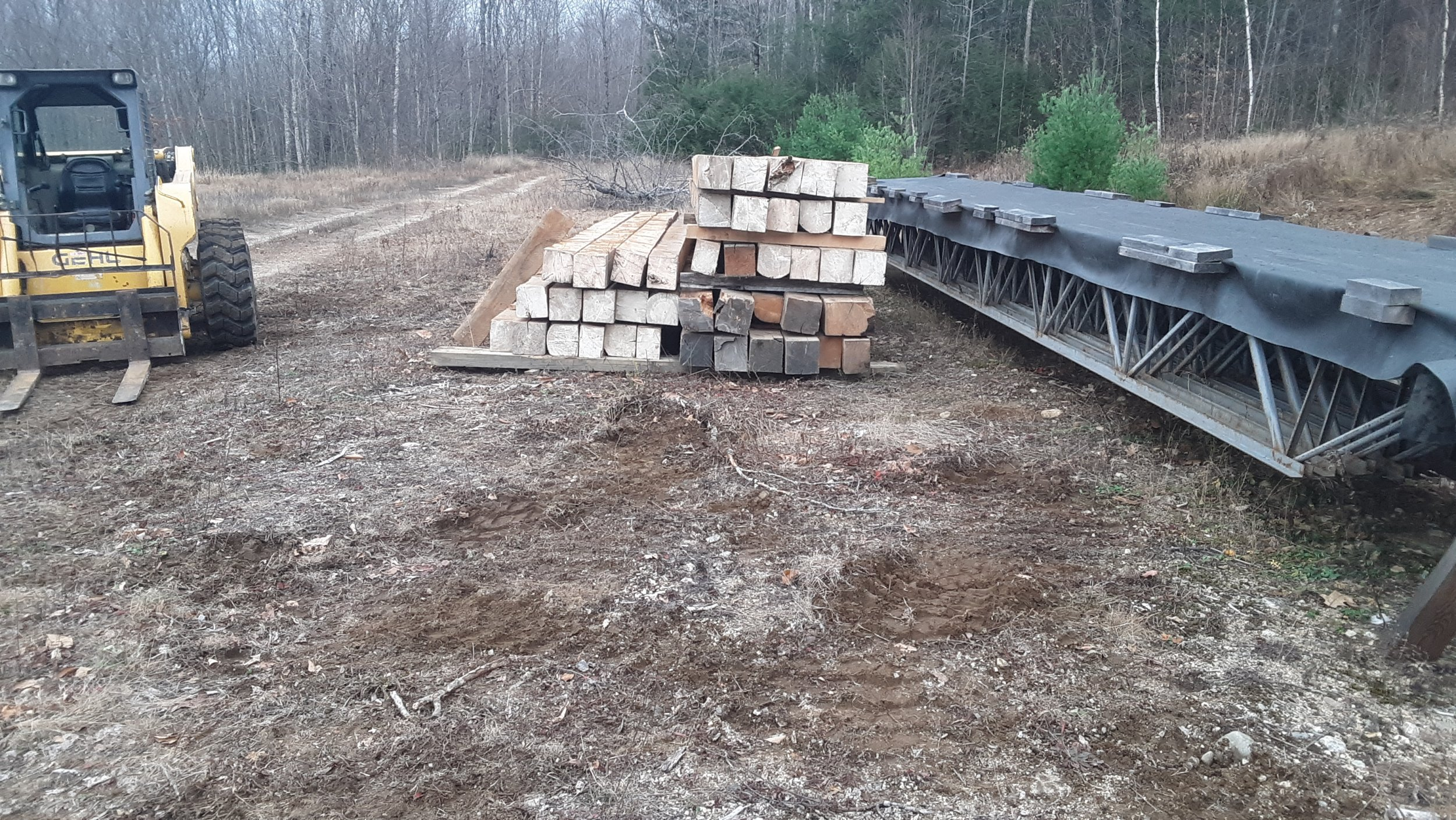

Gordon I think your looking at the bottom of the "bar joists". It's what you'll see if you look up at the (inside-bottom) roof at a flat roof commercial building, think Walmart or Lowe's. I found a guy that had a pile of 11 of them in his side yard - 38' long and talked him out of them for $400.
These are the reasons for the very odd construction with all the posts. Typically they'd span between heavy I beams and they had a 2 1/2" pitch built into them. Not wanting a single pitch type roof combined with running into a guy that wanted get rid of 40 sawn, dried and stickered 8x8x26' spruce posts that were taking up space in his building.... for free, it all came together for me.
Here's the pile of posts and the bar joists.
Thanks - It makes sense now. I was totally confused. Now I don't have to ask why all the posts on the gable ends and how you managed those huge openings on the eaves sides of the building. lol. Very clever use of what you can find for materials.

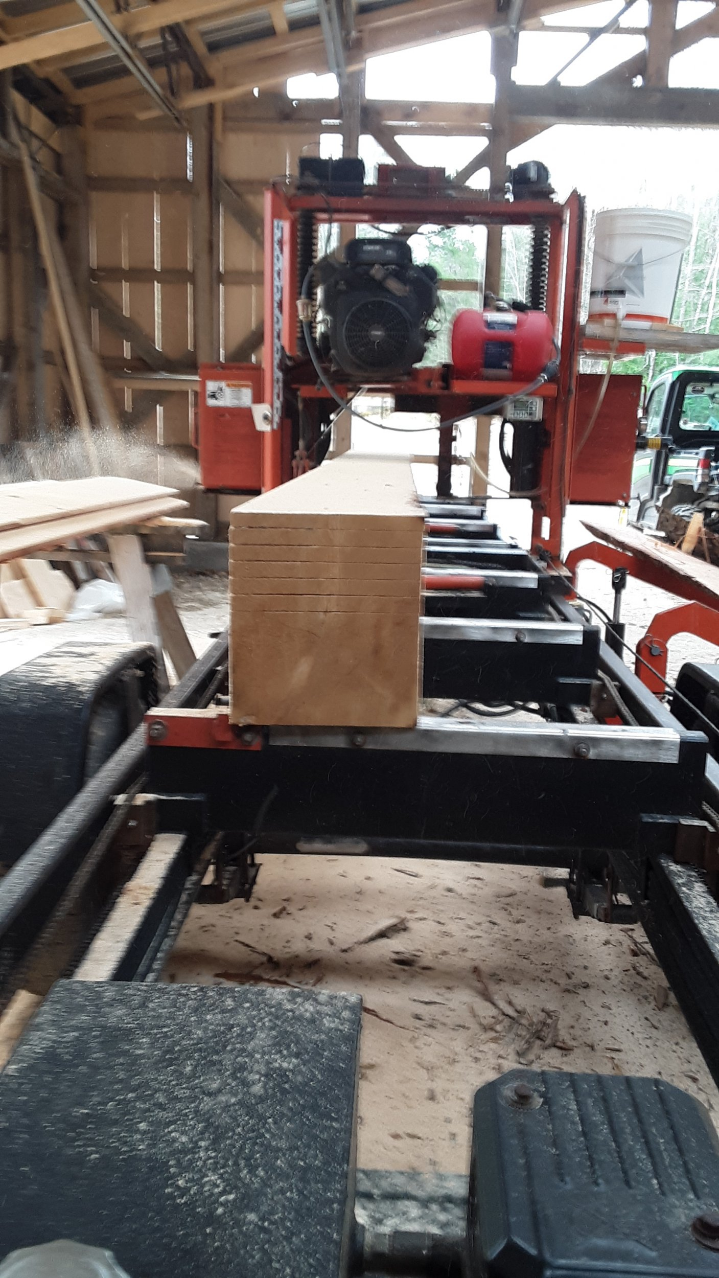

I sawed out a small cedar today. I needed (two) 4x4 posts and also got some 2x4s. More practice is needed, as I am getting too many waves in the boards. I believe that's speed related, I need to work on a more steady movement through the log.
I also am considering a chainsaw mounted debarker, the wood seems clean and was cut with snow on the ground yet my blade is already getting dull.
Right now I have a pine log on the deck which I cut last summer. I wanted to saw more tonight but it was end of the day after work, and that's when I start making stupid mistakes.

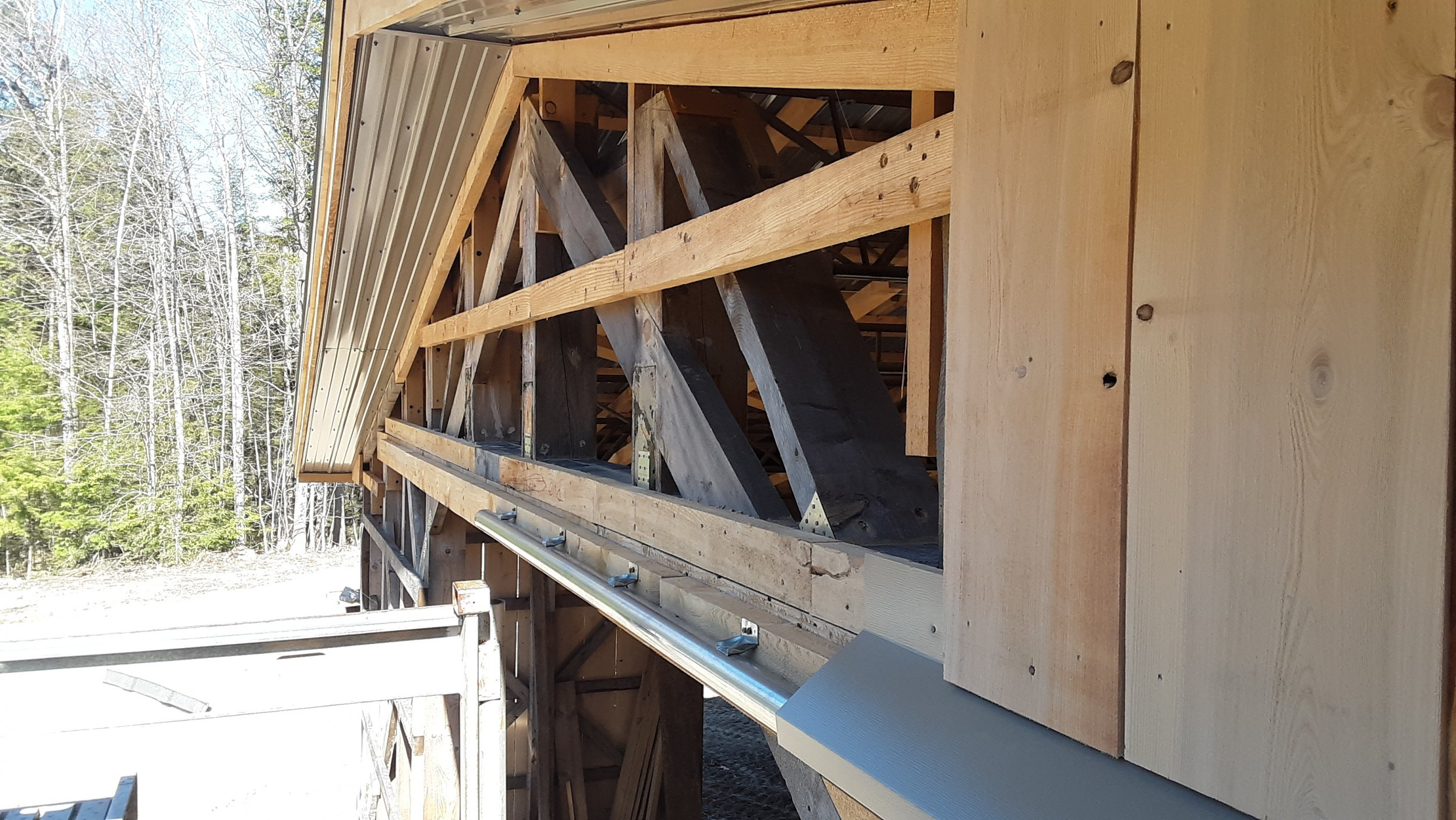

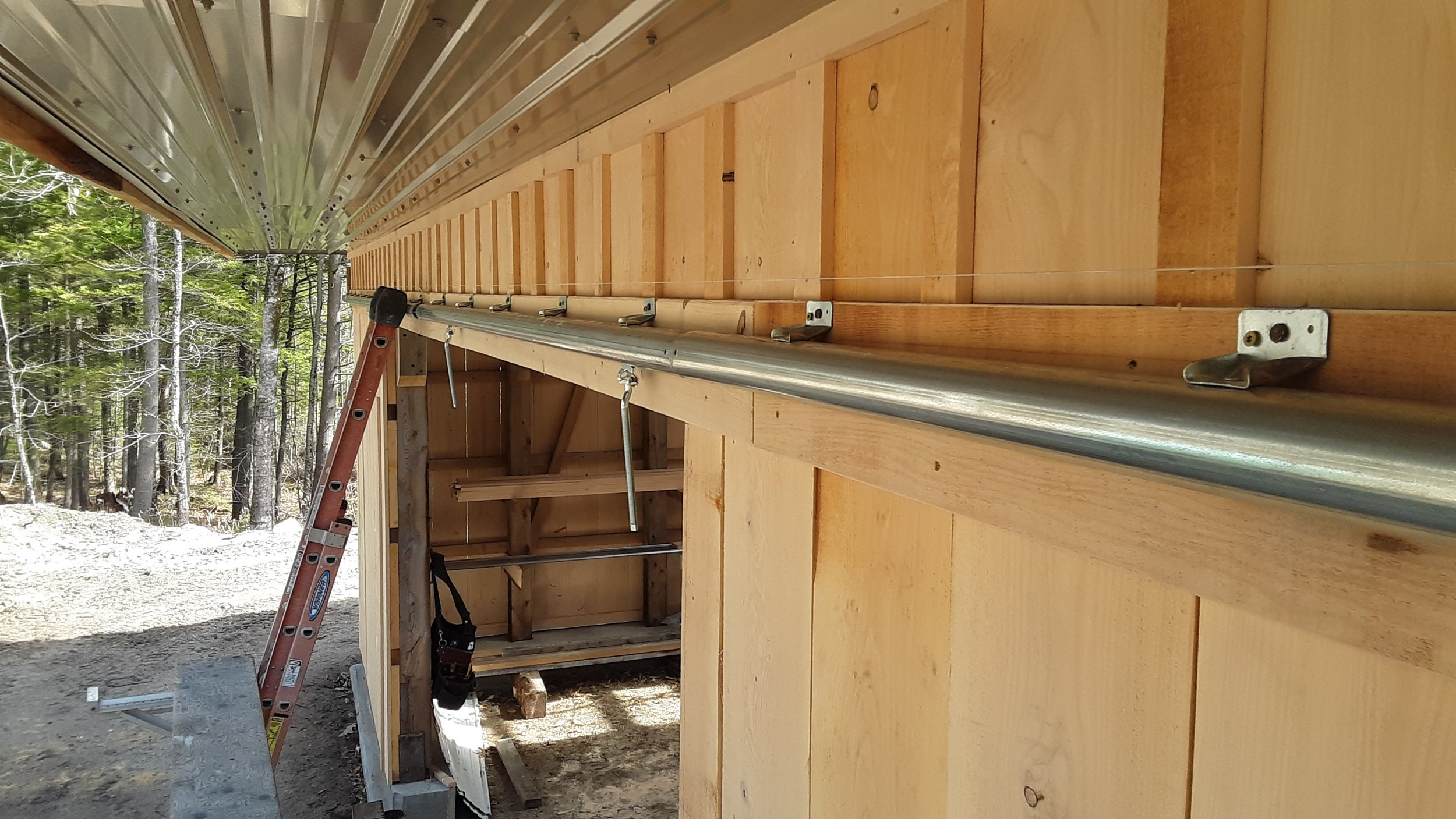

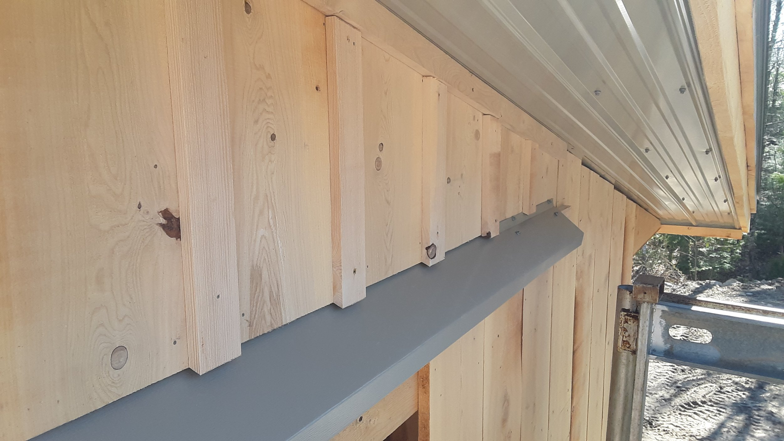

Pecking away at the exterior and door tracks.
I'm easily distracted and was bored with nailing up 12' boards. I decided to play in the gable today. It's a little slower as I'm going for "one trip" across. That means the little bit of backup for the door track, the track, track cover I'm bending up out of coil stock, siding, a little gable trim and finally the battens.
My battery is wearing down and as you can see from the sky, it's a perfectly perfect day and I'm ready to quit for the day. 😁
View attachment 744225View attachment 744226View attachment 744227

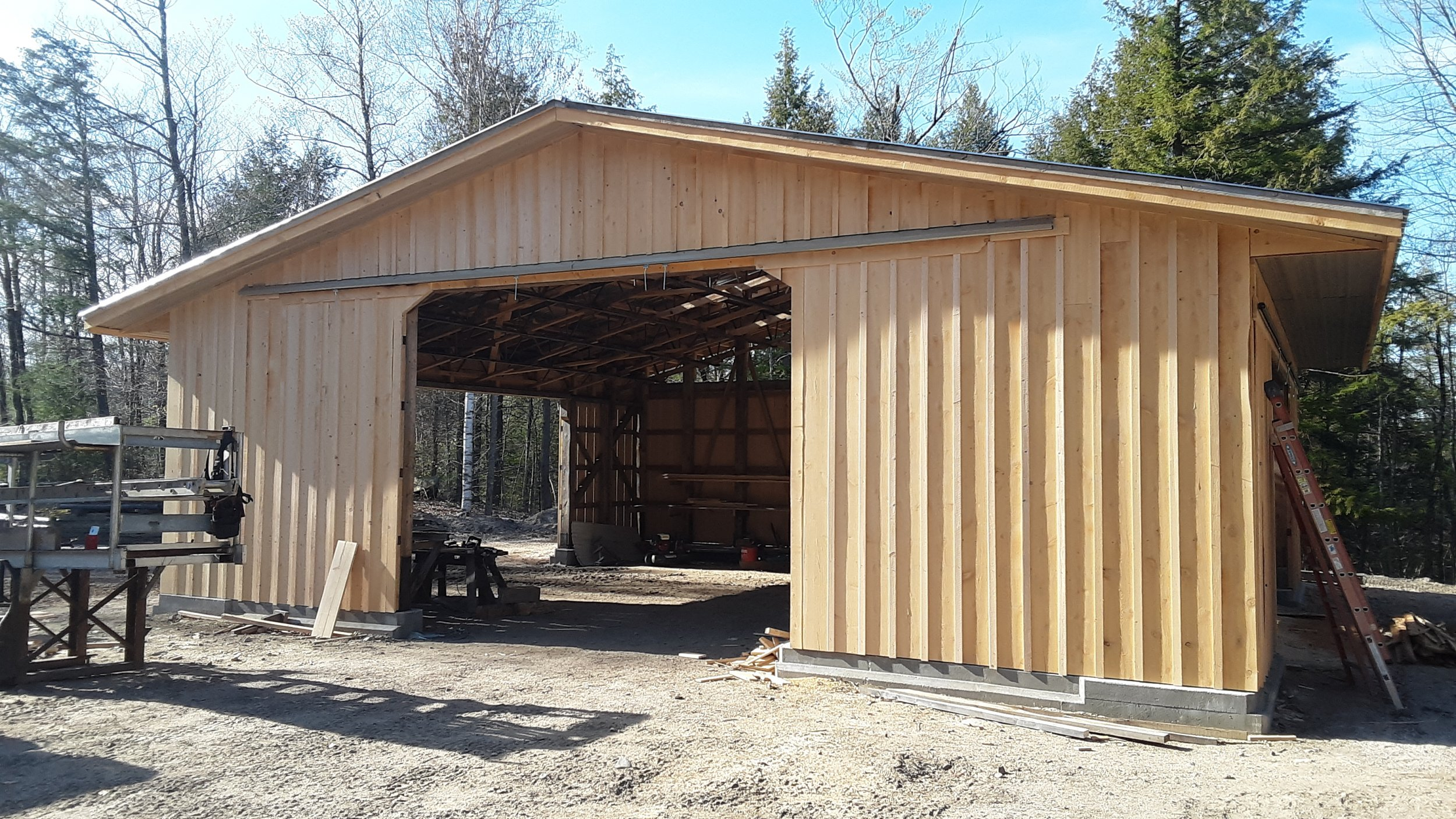

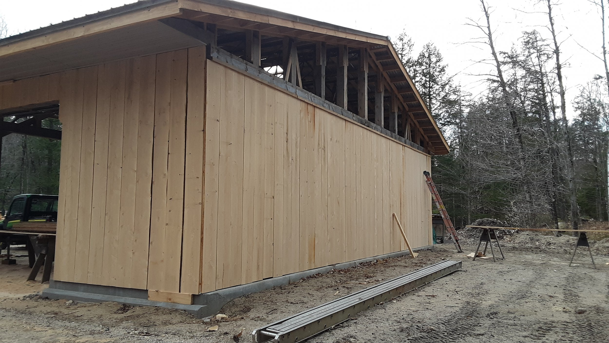

2 wall's finished, 2 wall's need battens.
