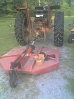

LOL Yes, i agree! a finish mower would be exactly what i need.But when i was clearing land, i needed a bush hog and have always used it to mow the grass and just accepted the long divots, but now going to try to do something about it without spending 1000.00 plus dollars on a 72in finish mower...

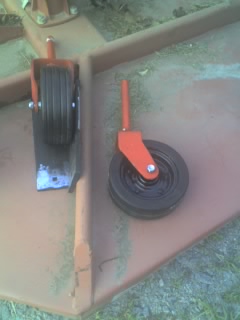

OK... today went to agri supply and bought 2 finish mower yokes ( offset to help centering) and 2 finish mower pneumatic wheels. It will have 2 wheels in front and keep the one in back. I bought about 10 bushings in 1/4 in height differences and will use them to adjust the ride height on front. I will install grease fittings
Tomorrow will weld a plate to the bracket that drops down to deck ( that has the 3pt hitch mounts) from this, it will extend approx 10 inches forward of the deck to allow room for the wheel to swivel.
Its time to mow, soo tomorrow after installed, will play with height adjustments and mow the yard..... While doing all this, i sharpened my blade to point like lawn mower blades since i have no more clearing to do this summer.
cross fingers and wish me luck... will post pictures and give report..
2 swivels were 53.00 2 wheels 62.00 bushings , grease fittings about 12.00
with welding labor about 150.00 for conversion

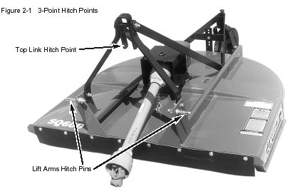

I just took a look at the Squealer manual, and the 480 is spec'd for 1.5", 3", 5", 8", and 10" cuts. Personally I think the 1.5" and 3" settings are just a scalping waiting to happen. But I suppose it's possible if you're operating on a pool table surface.
So since you're still having that problem with the front edges digging in on turns, I have to guess you're cutting at one of the two lowest heights. It then becomes imperative that your TPH sidelinks are adjusted as tight as possible to ensure minimum implement sway. Kioti calls them check chains
or stabilizers. Center the mower directly behind the tractor (at your desired cutting height), then adjust each sidelink to the shortest length possible. Assuming everything else is adjusted per the manual, that's the last thing I can think of to keep the edges from digging in on the turns.
Oh, one other thing; do you have the lift pins mounted on the inside or the outside of the A-frame? That is, are they pointing toward each other? or away? On the attachment below, they're mounted outside (away). Inside mounted pins will typically permit more sway.
//greg//

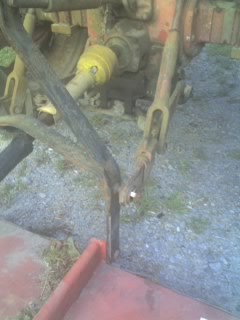

Thanks Greg for the tips, I will adjust those stabilizers.
Take a look at the photo, my stabilizers have slide ( different from yours) and it does have sway on the deck.
My hitch pins face out, and its being pulled my 686 international diesel ( 70 hp ?)
I also included some photos of the land i mow. 12 acres cleared plus warehouse and home. ( use a honda 20hp riding mower for trim )
I really do appreciate tips on setting it up, since i have purchased all the wheels forks ect, will go ahead and install. Have meeting at welder at 10 am and have ground all rust and paint from areas to be welded. Will post again tonight after mow.
I'd ask the welder's opinion of the comparative strength of those gauge wheel assemblies. They look awful light duty compared to what I can see of the rotary cutter. I'm afraid you'll end up with a welding bill followed by $150 worth of twisted hardware.
Finish mower wheels support 25% of the mower weight on each of four corners, and finish mowers are typically lighter in weight than equivalent sized rotary cutters. Your configuration will put ~33% of the rotary cutter weight on each just for straight line mowing. When you make your turns, expect one wheel to support up to 50% of the weight.
