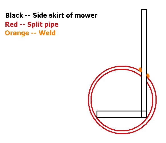

   / Scalping problem 72 bush hog, can i add front wheels? #70
greg_g said:
Sounds self-defeating to me. In effect you're causing sides of the mower to be even closer to the ground. Can't help but think that such a modification would increase the frequency of ground contact. I think all you'll end up with is a different looking series of divots.
//greg//
I'm not sure that I am getting it across to where it is understandable. The pipe would be to keep the side skirts from digging in when it does touch. It would add very little to the depth of the side skirt. Here is a cross section drawing of the way it would look.
