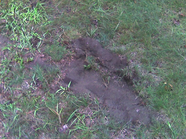

bjcsc said:
I read this entire thread and the one thing I see missing is that no one mentioned that there are two ways to run a bush hog. ...
I've attached a couple of photos showing how I have my bush hog set up and also the type of gouging (not scalping as it is not the blade but rather the cutter skirt or leading edge corner that does the turf damage).
Looks to me in the first photo like I have the deck pretty level rather than either tail or nose high. This would be a typical cutting height for what I try to do when mowing an old pasture.
Second photo shows tail wheel setting. I've never changed this from what the dealer set when I bought it.
Third photo just shows the sort of knarly damage done periodically on turns. I have seen this damage on flat areas as well as on bumpy terrain but it seems a bit more common on the sloped sections (which comprise about 80% of what I mow).

IslandTractor said:
I've attached a couple of photos showing how I have my bush hog set up and also the type of gouging .
That looks like you took a photo of what was happening in my lawn. One corner of my pasture nearly 40% of the turns i made created gouge, where the other 3 corners were closer to 10% but at the cutting height I wanted, I couldnt go 2 mowing laps without taking a divot somewhere.
I also run my deck level about the same height for better finished look. When running tail high, the finish cut wasnt as good, and could never try it front end high, because it would drag the back deck if lowered anymore in back.
Is there any bounce on your tractor when it gouges?
I mow at high speed and a lot of my problem was slight bounce if i hit bump while turning. Then it was gouge city. If everything is tight (not swaying) Other then raising the deck height, I just could never find an adjustment that could prevent the gouging.
When I added front wheels to my squealer and let it trail behind mower with lifting arms just floating, this effectively took bounce out of equation and kept a consistent low cutting height with no more gouging.
If you decide you want to try it, you can bolt them on and see how it works for you.

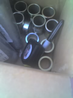

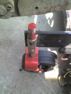

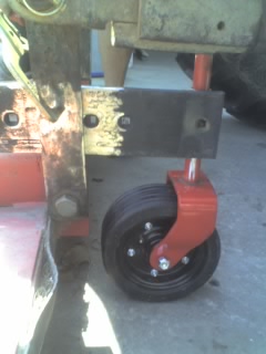

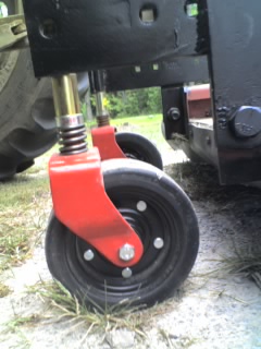

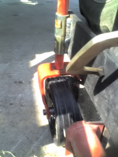

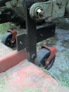

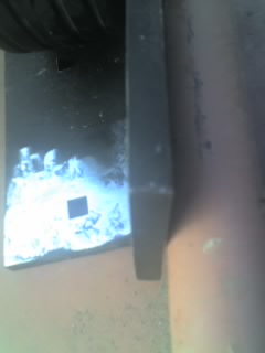

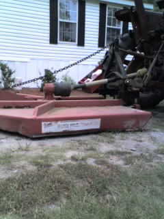

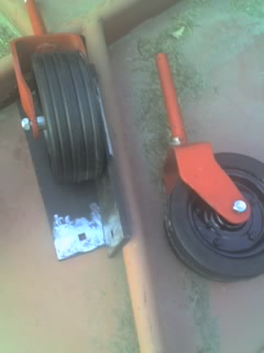

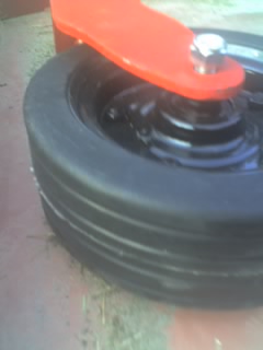

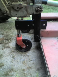

Installing front wheels...
All the parts I used came from agri-supply ( they were closest and had it all in stock) the forks and wheels are same one used on the caroni 93" finish mower they sell so I figured it would work for my 72' cutter
Item number
28538 Gauge Wheel 2 qty 26.95 ea
30887 Gauge wheel fork 2 qty 24.95 ea
axle bolts and nuts 1.50 ea
2 cotter pins .10
2 each assorted spacers ( to get adjust mowing height )
30903 1/4 in 30907 1/2 30906 1 " appr 1.60 each
total parts 116.60
All above items are on page 7 of agri-supply July catalog which you can view on their website I think.
I also wanted a piece of steel to weld the steel bushings to for the fork to slide in and out. I just walked around until I found something that would work, and this ended up being a HARRELL LANDSLIDE 30878 9.95 each
This was just plate steel with 1/2 thick that was long enough to get wheel away from mowing deck. You could go to steel store and pick up 2 plates much cheaper I am sure. Mine I think was apprx 1/2 thick 13in long and 4 in tall.
I took grinder and cleaned off place on plate for welded bushings on one end of plate. Then with everything sitting on concrete pad, welded the plate to my BH. I had the wheel assembly together and lined it up. Keep in mind you want to be able to have adjustment up and down with bushings to set ride height. I could have bolted it on, but welding was quick and easy. If I want to remove wheels, I just pull the cotter pins and drop the wheel forks out.
I did mine on inboard side, because my hitch pins are outboard, and would have caused interference when lifting if I had outboard.
I tried to include pictures to help... if you need any others let me know.
I also added some heavy duty springs in place of bushings at bottom to let it ride on suspension.

   / Scalping problem 72 bush hog, can i add front wheels?
#47
Let me know if you need any other photos. I wish I had mounted my plates lower and used less spacing on the bottom and more on top. This would seem to put less stress on everything due to less mechanical advantage on wheel fork ( like choking up on baseball bat)
I am not sure if it would help as everything seems solid, but just looks like it would have been better to mount my plates lower closer to wheel. I mounted them higher in case I needed to go to a larger wheel and fork combination in future, but I dont thats going to be necessary.

   / Scalping problem 72 bush hog, can i add front wheels? #48
That's what I meant. I can't figure out why it's doing that to you...Do you mow with your bucket attached? I'm wondering if maybe your tractor is leaning in the turns...?
