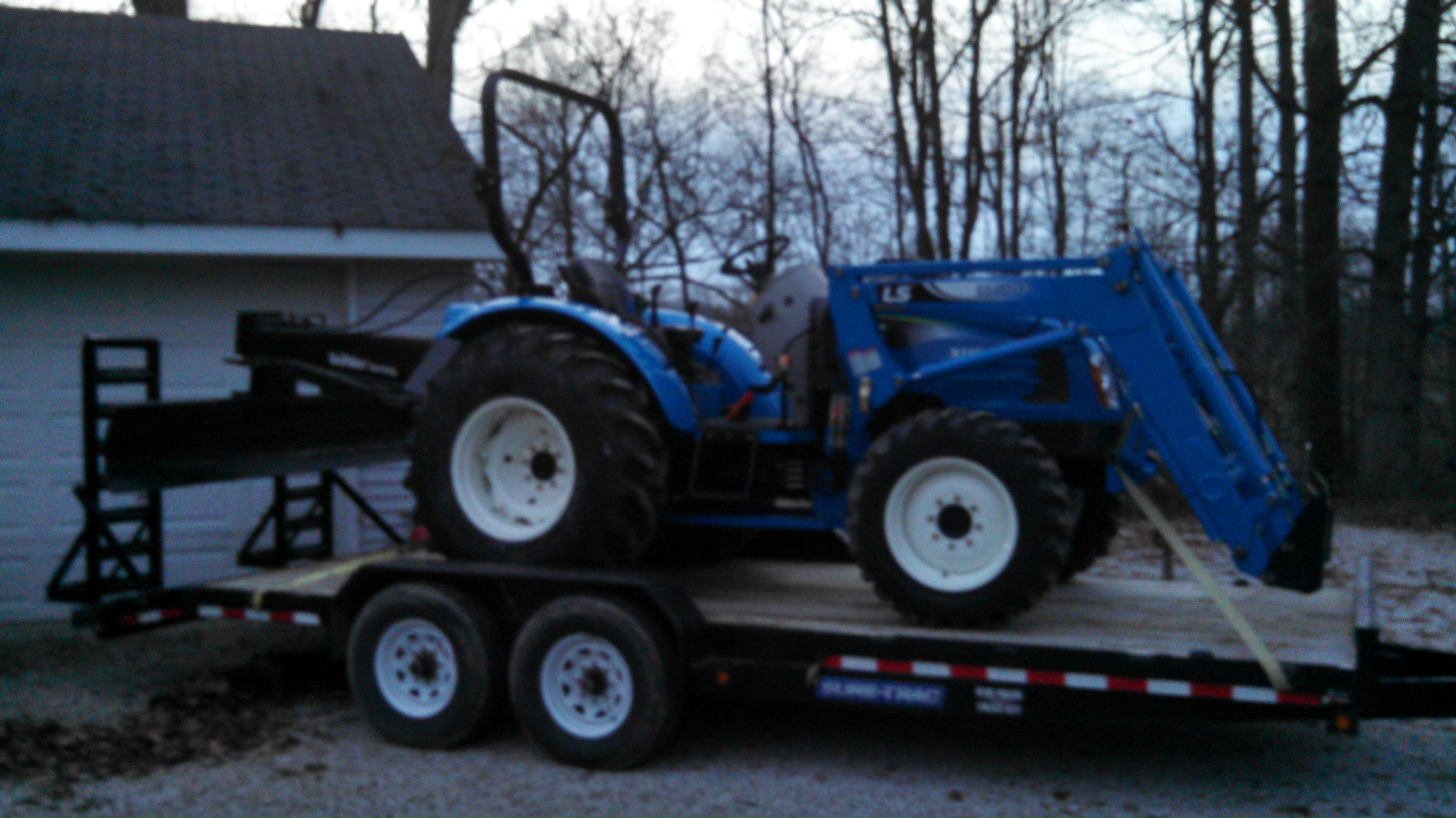

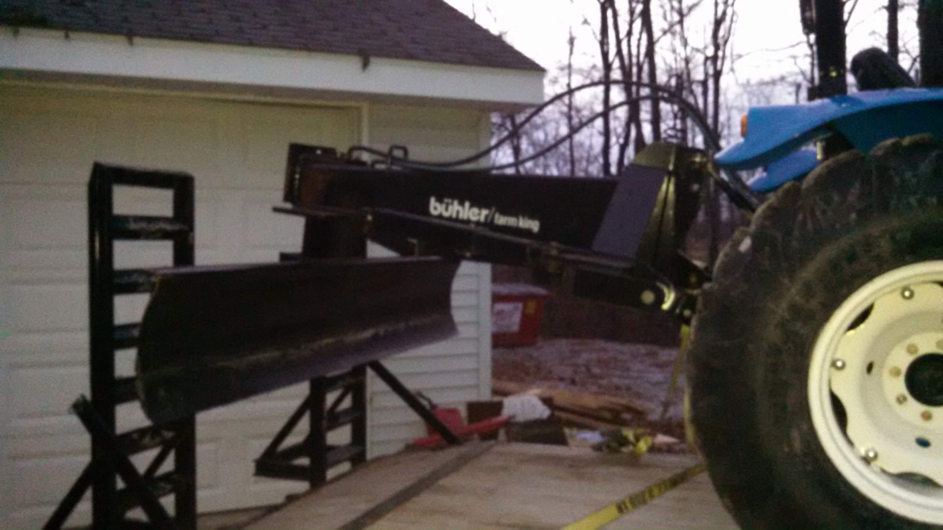

Just picked up new tractor and blade. I ended up getting a 100108 Farm King used that was 10 miles from my house instead of the Ebay one that was 400 + miles. It was used but this will more than take care of what I want. Now to begin to build the gauge wheels and I will have the complete package. Only bad thing about blade is some wear in king pin but nothing some shims or weld and grinder cant fix. The owner must not have owned a grease gun as the zerks were never touched. Pretty sad to abuse equipment like that ( ok rant end) :mur: maybe!

Couple of things today put 8 hours on tractor it now has 10 total...Woop! What an upgrade from the syncro shift to a hydraulic power shuttle the loader work is amazing. The extra HP going from 47 to 65 is pretty cool as well, I can now stay in 3rd range and just switch between 4th and 3rd to do most of the work.
I have never had a blade this heavy and it made very short work of making a even ditch to put a pipe in almost effortless. I don't mean to sound like I am crowing just really happy with my choice and am happy I listened to my first mind about going ahead with purchase, this is going to help me tame my wilderness.
I cant wait until I get the gauge wheels made for blade now, I looked today at wheels and axles at TSC and there was a High Run ASB1048 20.5X8.00-10 wheel and tire combo that is is good for 1535 pounds and a 5 bolt hub and axle kit I can weld to my build. The scraper weighs 1352 pounds without hydraulic cylinders or gauge wheel assembly. My question is how much weight do I calculate that the material will add to the gauge wheel, will the material be lifted by the wheel or is it pulled by the tractor and blade if I am phrasing my question correctly.
