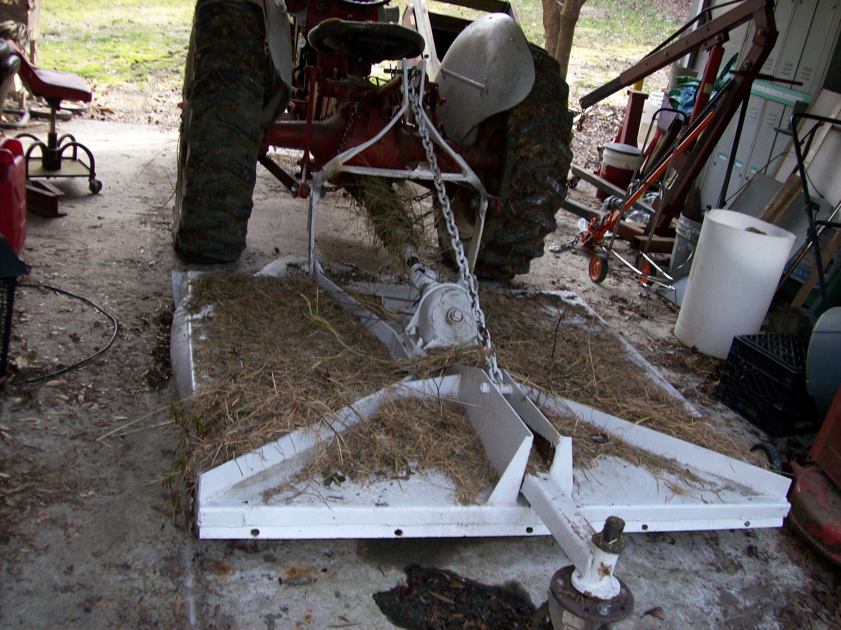

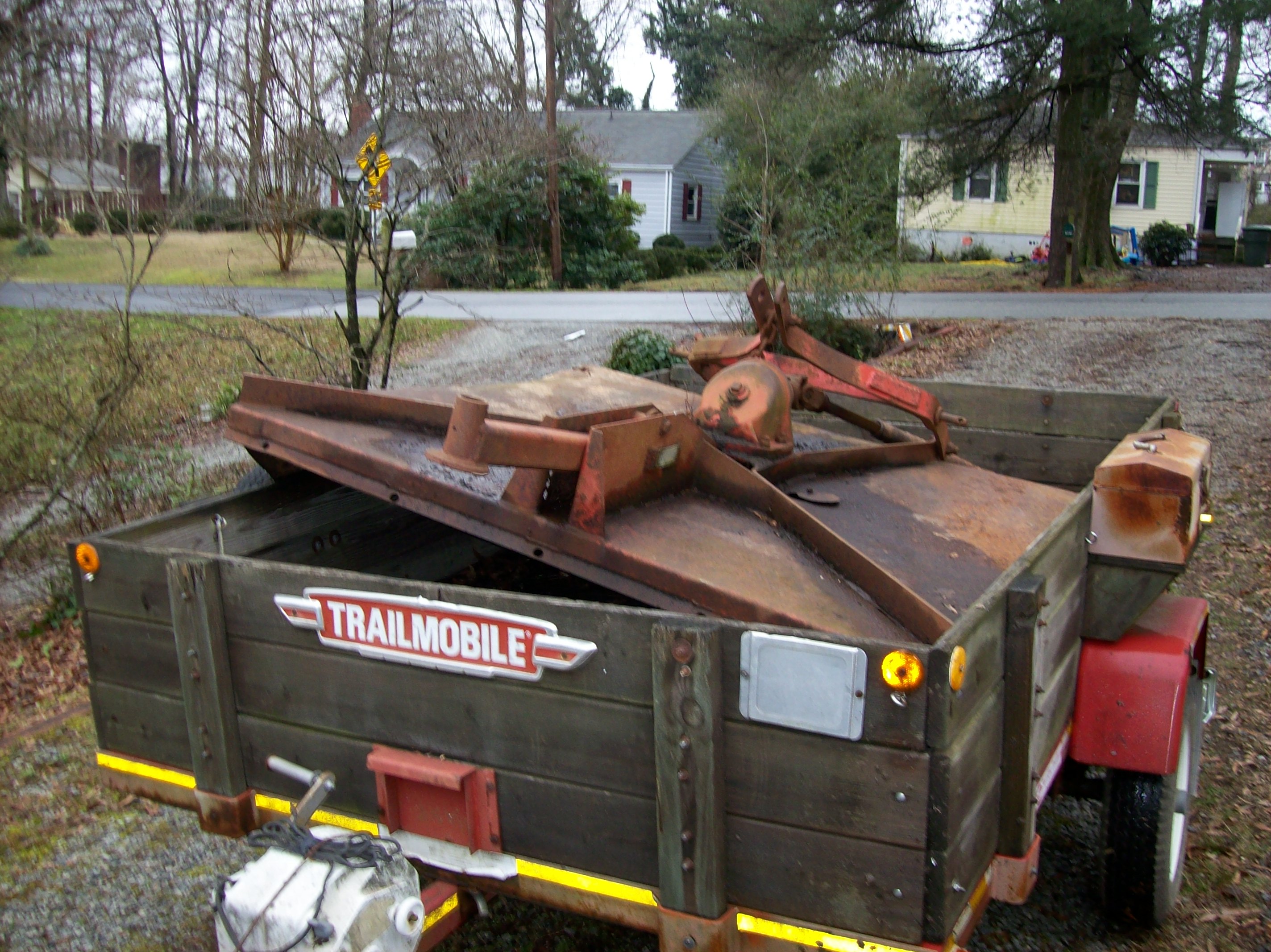

I bought one just like that for $300 a few years back that was in way worst condition. Welded up the cracks, put a new wheel behind it, filled up the leaky gearbox with grease & painted the rust. We had just bought a piece of property that was overgrown for several years and use it behind my 49 8N Ford to clear it off. Hit a few saplings that the old tractor could barely push over, but that Bush Hog chewed them all up. Used it that one time, sold it and made a few bucks to boot. That old Hog was a tough piece of equipment. If you can get a look under it at the blades and see if the gearbox turns, I wouldn't be afraid of it, but I'd offer less and see what he says.
