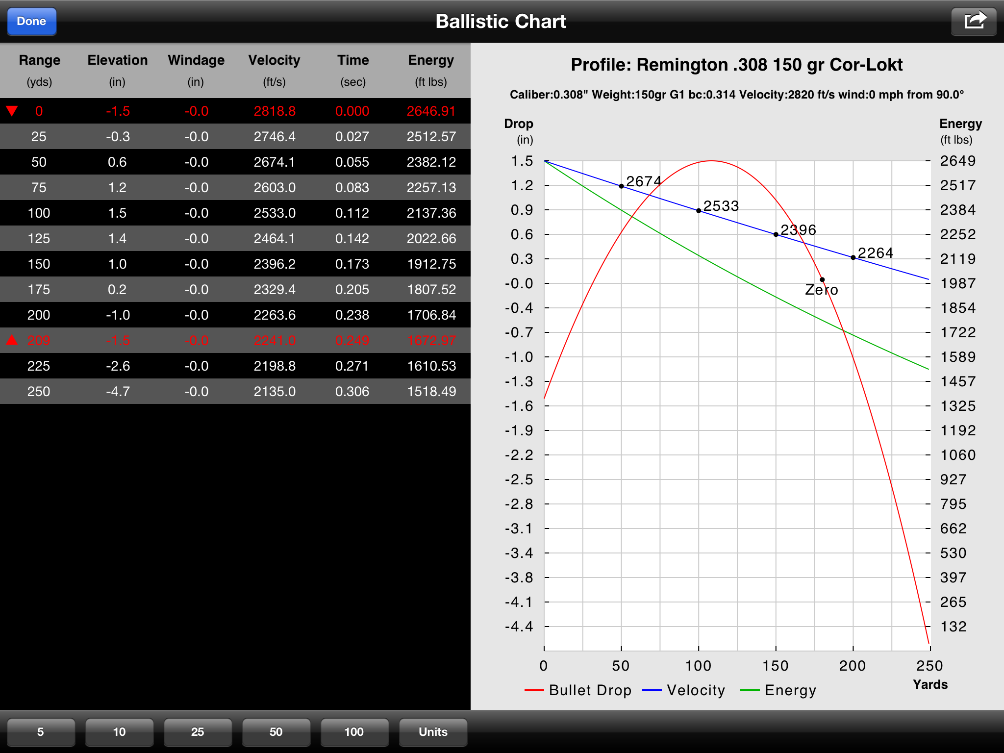

Here's a similar setup for the 150 gr Core-Lokt at 2,820 ft/sec. Zero is now set at 180 yards. Point of impact is still 1.5" high at 100 yards, but the trajectory is a little flatter.
Range Elevation
(yds) (in)
0 -1.5
25 -0.3
50 0.6
75 1.2
100 1.5
125 1.4
150 1.0
175 0.2
200 -1.0
209 -1.5
