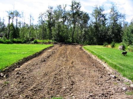

I broke mine as well but have rebuilt it much stronger and put in sheer-bolts as well. i bent mine after catching a frozen stump.
I am also doing the same thing as you are "crowning a driveway"
