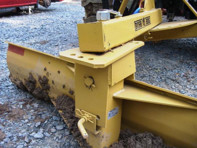

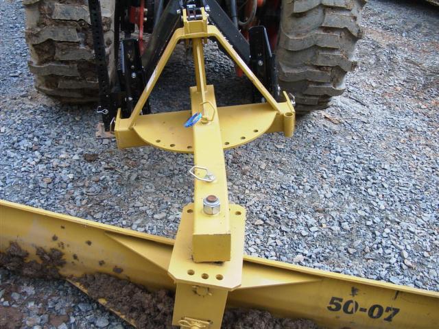

Here's the proof. Today the dealer told me they see this all the time and it hurt. They will see how much the two pcs. cost or if I should get a new unit. If I go for the new unit they have a 70hp model that is built a lot heavier and it's only $ 200.00 more. Hind site is 20/20 for me right now.....

If I owned that blade, and took it back and they told me they wouldnt warrantee it, I would then continue to use it as-is. It looks tweaked but that wont really affect its use too much. If the dealer really does see this all the time, the new pc you pay for is going to bend too. Get used to it, or have it reinforced by someone who understands the problem.

Maybe the pic's are deceptive but it doesn't look that bad to me. Any good welding shop could straighten it, re-weld it and add some gussets to make it stronger than the original.

It looks like most of the tilt is from the swivel bolt being bent. If it is, it would take care of most of the problem to replace it. Tell me if I am wrong, it is hard to tell by looking at pictures.

It does seem that way but the pictures could be misleading. Maybe if we could see a couple of 3/4 shots one from each side entire implement it would be easier to see.
Fl Cracker when you say prices for the two pieces which are you refering to?

It looks like the bolt took the brunt of the force.
FL_Cracker, Is the beam bent? It looks that way in the picture.
