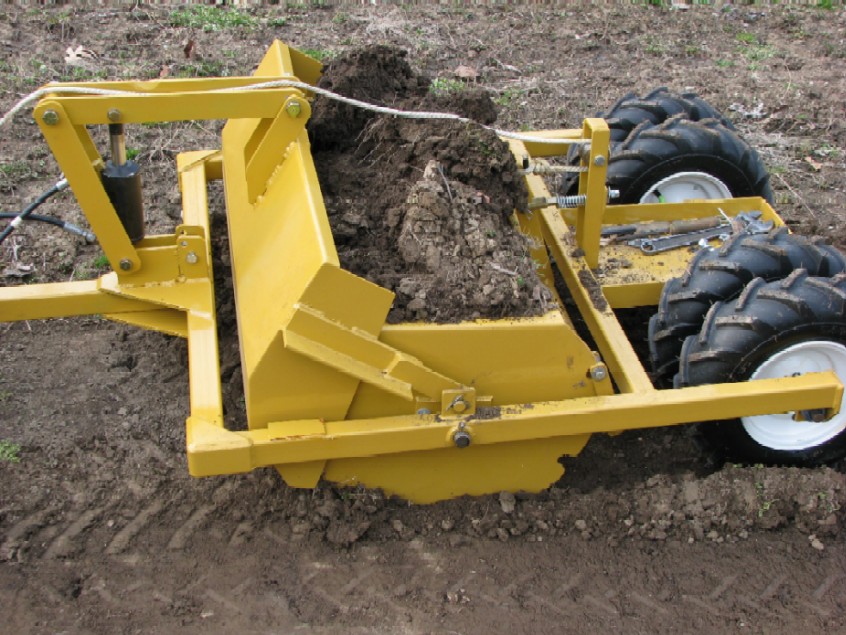

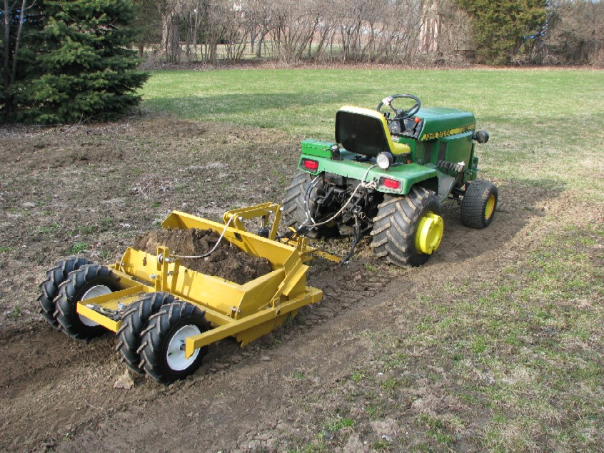

Did you follow the Hoelscher scraper design? What size / kind of tractor do you pull it with. I noticed turf type tires on the rears. Do you get enough traction??
This is my modification to a copy of a Soil Mover dump bowl scraper made for John Deere 140 tractors back in the 1960's.
I added the hydraulic apron last summer and are in the process of automating the dump bowl latch.

I have a 4wd Bx23 kubota tractor to pull with. I built this scraper around my size of tractor it works great. I wish I would have bar tires on it but turf tires seem to work also.

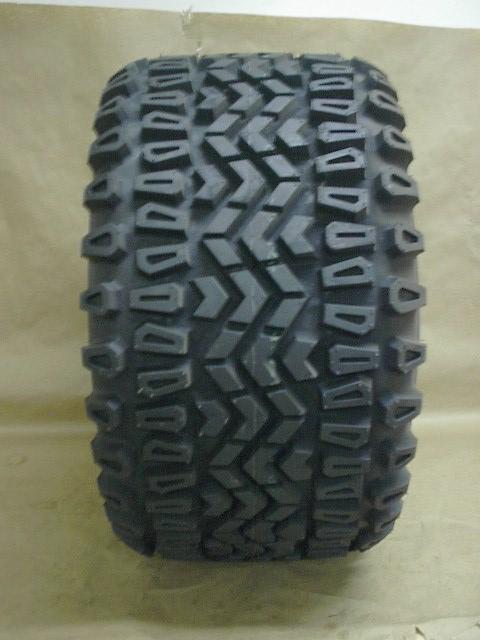

I have several tractors with bars tires. I am changing to Turf Trax tires for better all a round use.
