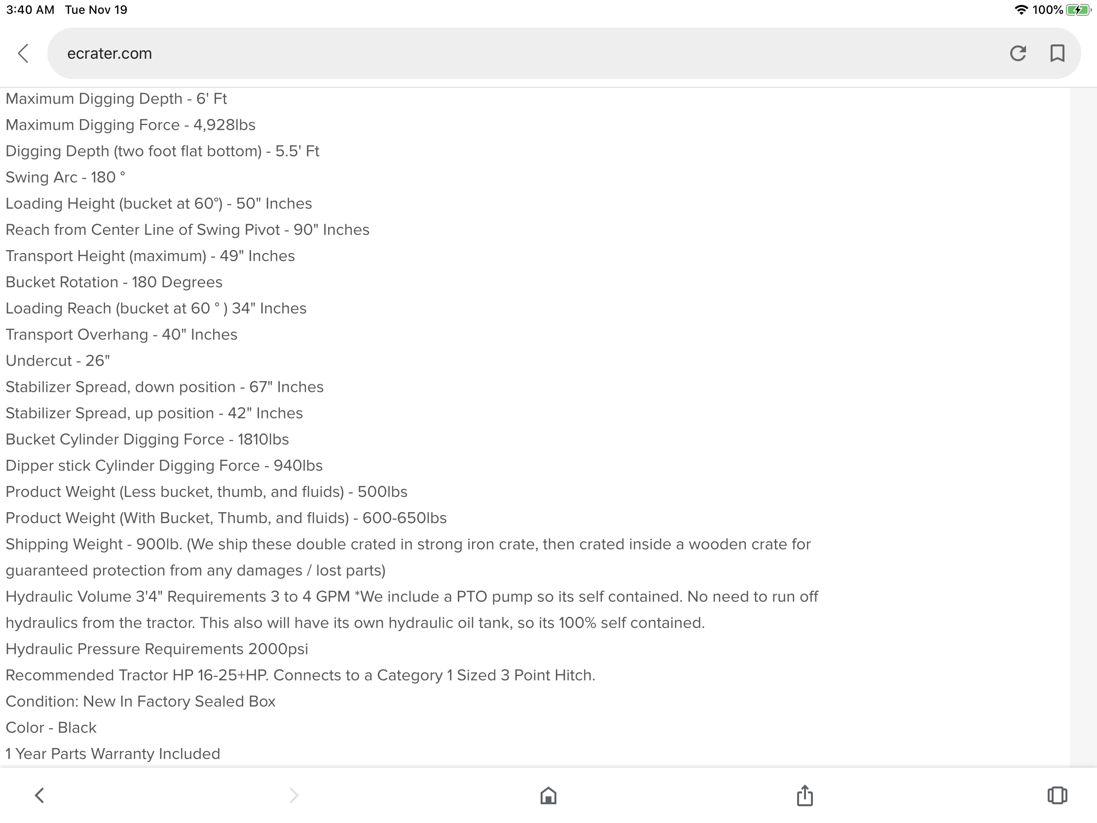

To bad this would not work on a GC1700 series scut. I really do not know why it wouldn稚 work being it is rated 16-25 hp, must be the way the GC is designed.
I'm talking outta school here coz I'm pretty new to tractors, but I see 2 concerns strapping on a 3ph hoe to a scut or cut.
1: Forces exerted to the 3 ph when working the backhoe. Well, here you got some control, just take smaller bites, don't lift to much, just be kinda ginger with the whole thing.
2: Forces exerted to the 3 ph just driving around with it back there. You got less control there, gotta make sure you drive down smooth paths, go slow, etc.
Plus your warranty is kaput going the 3ph hoe route. Overall, I'd say it's just a headache you don't need. But hey, why not just use your tractor to tow around the tow-hoe thing you were talking about getting?
   / SCUT's with backhoes #90
I have seen one of these in person and if it was your only means to dig a few holes, it would be okay. The amount of flex/slop or just looseness in a 3PT mount would be a bad way to mount a BH. A SCUT with a factory mounted BH is a good machine for many home owners to have around. They have the additional mounting frames and were designed to carry the weight. A 3PT mounted BH would be a last resort if there were no other way to get one that is properly mounted. I haven't checked the warranty on any other manufacturers but I would not expect the warranty to be affected unless there were some other contributing factors.
