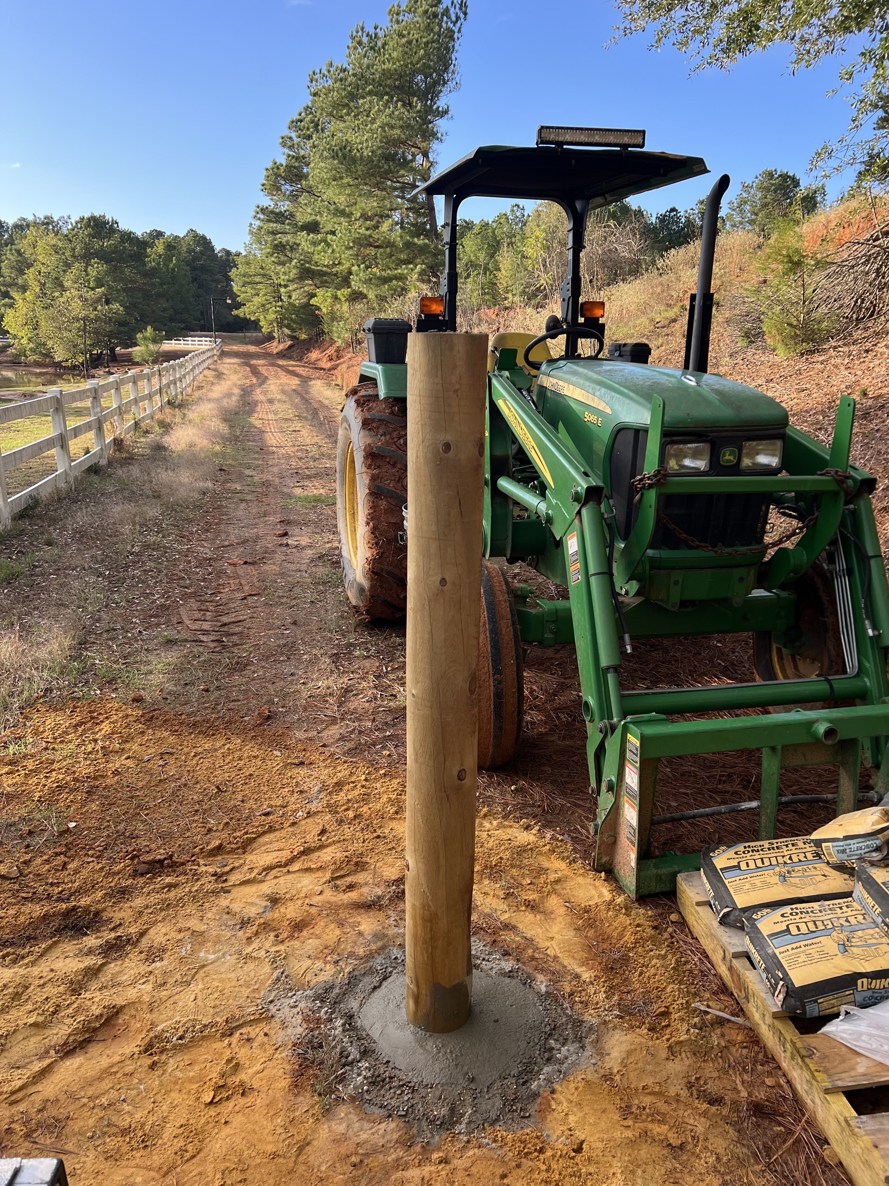

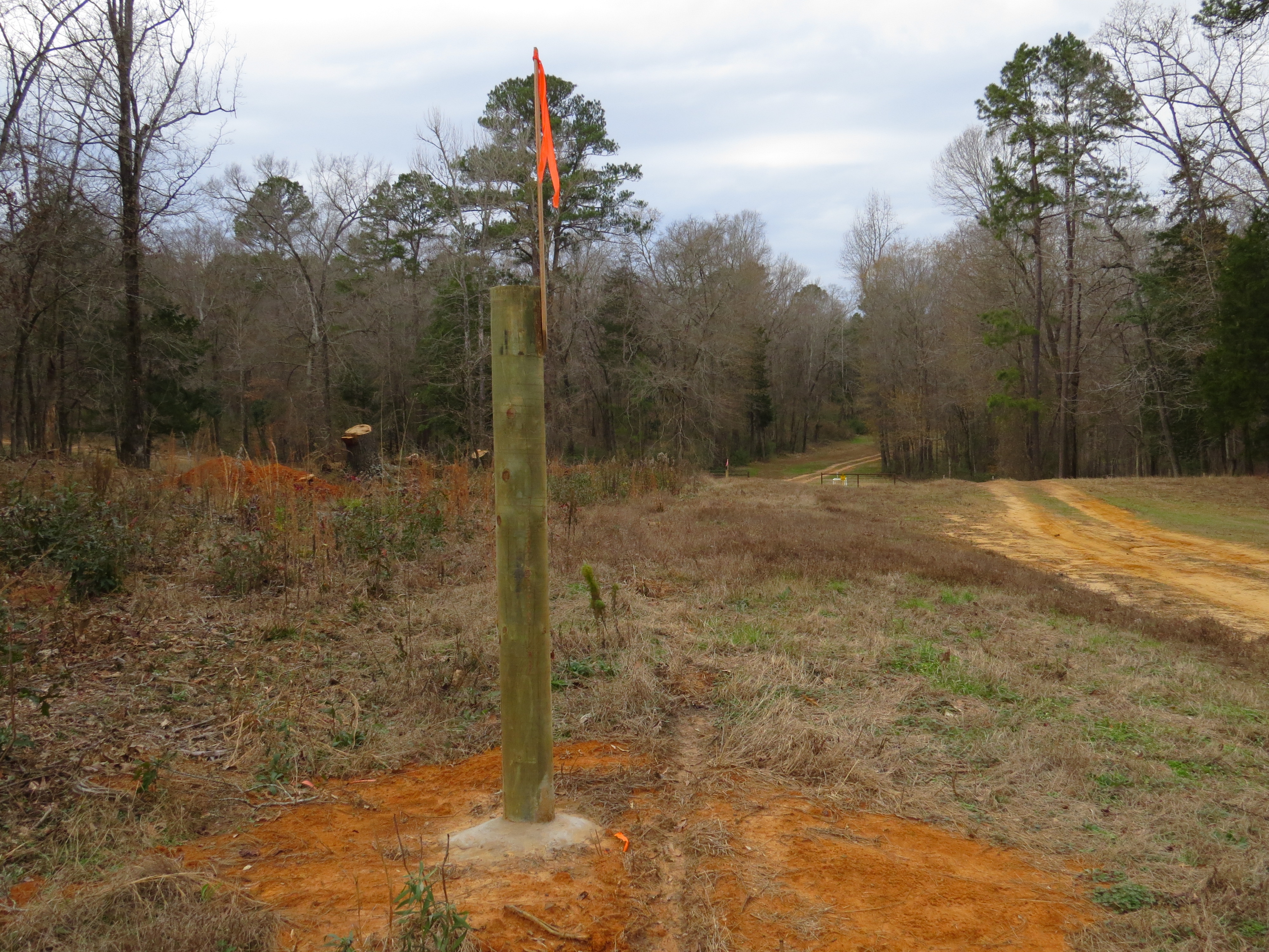

I found that you cannot pack dirt around a post and expect it to shed water. The soil around the post will wash away and leave you with a low area that holds water. I made this mistake with my line posts. Now I use concrete for every post, and I build it up, so the concrete is above grade and water sheds away from the post. This is the only method that I feel is 100% effective at stopping rot at the base of the post.
