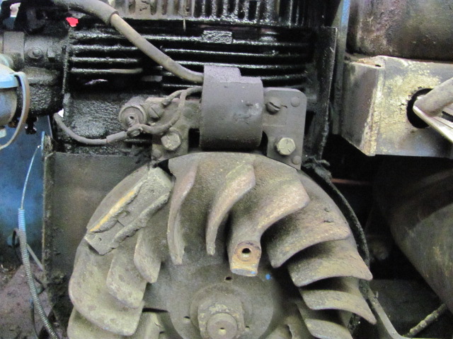

Decided this morning to start taking it apart, instead of trying to start with the small garden tractor battery I jumped it with a car battery. It started after several tries. I have now taken the shroud off and attached a picture of what I have.

The gap between flywheel and coil is critical. (5-10 thou' seems to work best)
Be sure to clean up the outer surface of the flywheel and faces of the coil irons. (steel wool.etc.)
If there's any contact between, we'd be lucky to get a spark at all.
If the gap is too wide, output will suffer.
btw, who hasn't seen an older lawn tractor with a car battery vs OEM-size on it. :)
What you are suggesting is that I retain the points and just clean everything up. That is certainly something I could try to see if I get a hotter spark. I wish I had the room for a car battery, the small garden batteries with their low amperage hours just doesn't get it especially in cold weather. I did a load test on the garden battery and it past the test.

I think he meant the gap between the flywheel and the armature of the coil.
I always inserted a business card and tightened the armature down with it in place. No idea how thick they are.
