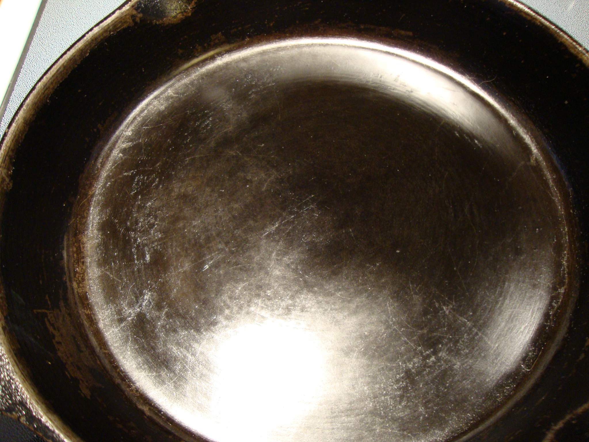

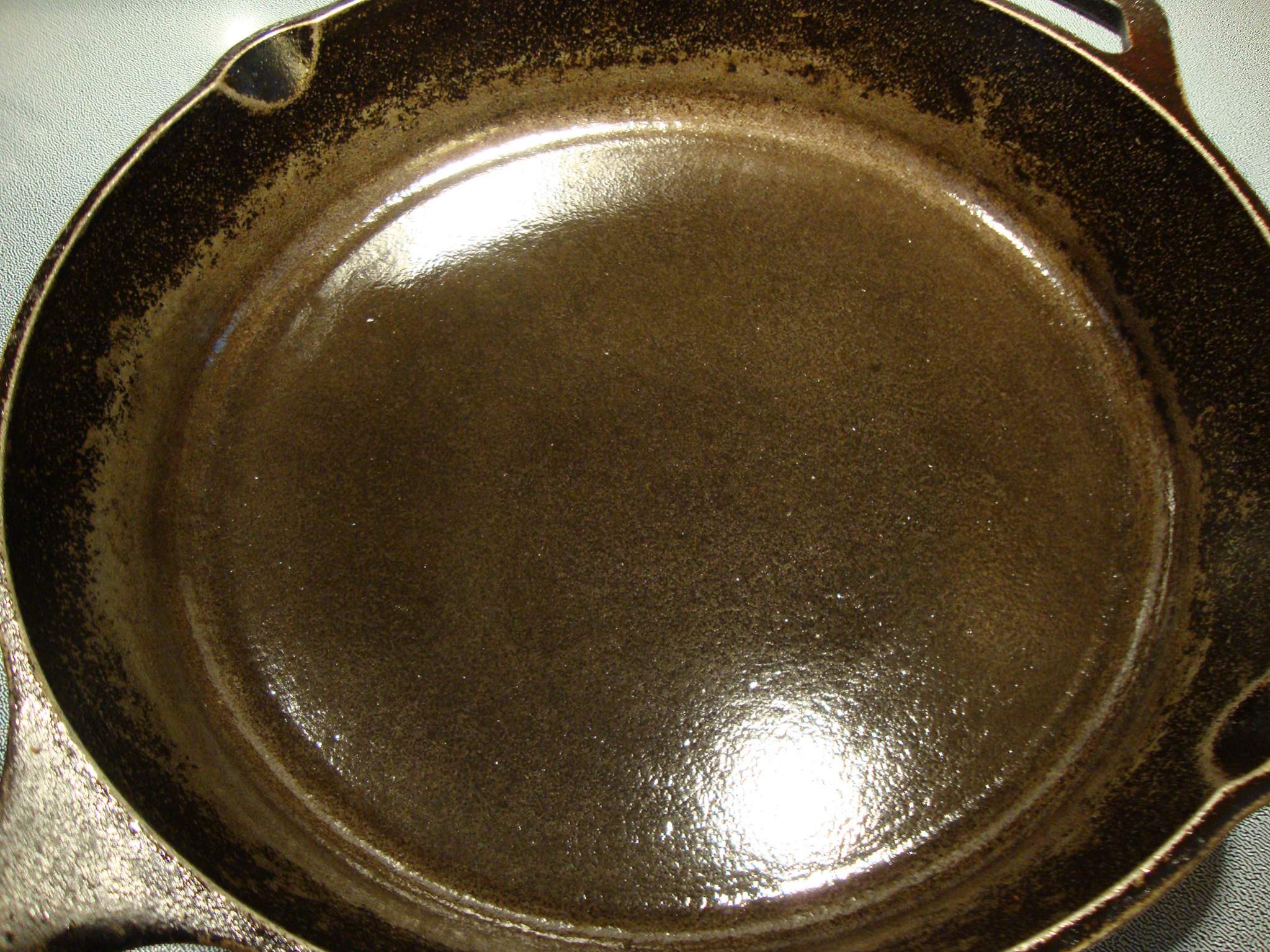

We have three cast iron fry pans, two are Wagner 1891 (one of the last pans Wagner made), and the third is a Lodge. We've had pretty much the same results everyone else has, the Lodge has been a very poor second to the Wagner's. The Wagner has almost a mirror finish compared to the pebble finish Lodge, which makes me think that's part of the problem.
I think seasoning is something that happens as you use the pan, not a process that's "once and done". I try to avoid cooking saucy foods in them, keep them strictly for frying and baking (I've got a good cornbread recipe that's done in a skillet in the oven).
The Wagner cooked pancakes this morning, pretty much 100% no sticking with a little butter added. The Lodge cooked bacon, ended up with little bits sticking here and there. I usually use hot water and a stainless steel scrub pad to clean them with, but decided this morning to try something different. I used a couple spoonfuls of canola oil and a dry steel scrub pad. It's as clean as ever, but no hot water to remove oils. Once everything is loose, a paper towel to wipe it out with and you're done. The Wagner pan needed no scrubbing at all, I just wiped that one out. I tossed the oily scrub pad in soapy water to clean it for the next time. I'll try this for a few weeks to see if it helps the Lodge pan. If it doesn't, I may try the sanding trick.
I should mention that the Lodge isn't bad as far as non-stick goes, but it's not half as good as the Wagner.
I've heard theories that the older Wagner and Griswold pans used a better quality cast iron than the new Lodge pans, if that's true or not I have no idea. I do know that soap and water is bad news for cast iron cookware, and I think plain water isn't so good either. I need something to get residual flavours out of the pans without damaging the finish (fried fish flavour does NOTHING for pancakes !), I think the oil and scrub pad might do the trick.
First pic is the Wagner pan, the second is the Lodge. Easy to see the difference in finish.
Sean
