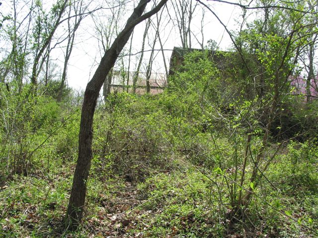

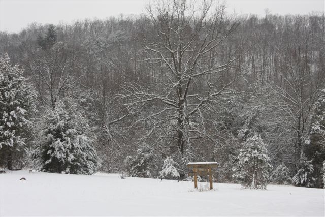

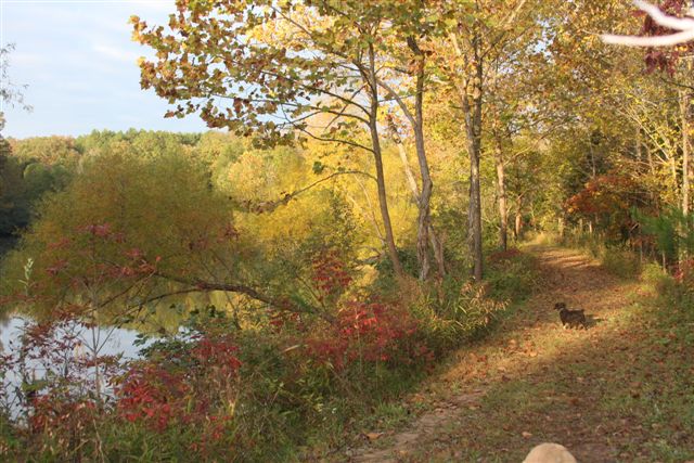

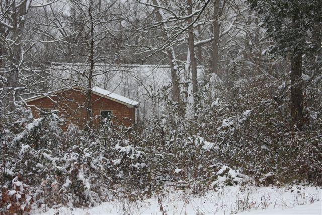

Here are a few images of the jobs ahead. Plenty of trails to create on the Southern hillside now covered in scrudge and trees. Want to add grapes too.
