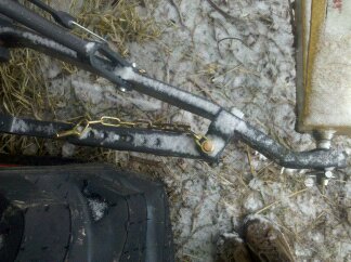

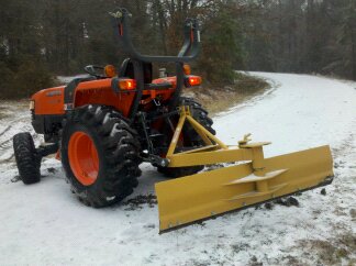

Everything is possible when you have an amazing support team and likely over 200 years of combined experience in the world of tractoring. Thanks for all your suggestions and help. I was able to get the blade attached (hopefully correctly) and to clear the drives.

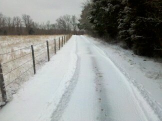

You can see how close the side arms are to the tires, but they say that is normal. I was so conservative staying away from the edges of the drive into my property that I plowed it the perfect width of my truck tires - ha.

A couple of things. yes the arms look normal, I hope you took another 2 passes at the road, to move those windrows over closer to the sides, because when we get more snow, (and we got more coming monday tuesday and wednesday) and the first windrow has thawed and refrozen, it becomes almost impossible to move over any, and that does not leave any room for your next windrow. Also a purchase you might consider for those lower 3PH arms is either a PATs easychange, (they are featured on this forum) or the Carter's. I have the Carters, but either make the hookup a little shall we say less "colorful". Also they eliminate the need to kick the heck out of the 3PH arms. which I have done plenty of in my time. If fact I hurt my foot once from trying to kick the arms off or on.

Can you move the attachment point for the stabiliser bars closer to the tractor & shorten the stabilisers some? That would get them away from the tires a bit more.
   / SECRETS TO USING A SNOW BLADE
#35
My goal is to see if it's possible to use a tractor without beating it with large tools and exerting extreme bodily force. I cannot seem to get the stabilizer bars closer and I am sure there is an adjustment that someone who has done this would see in 2 seconds.
