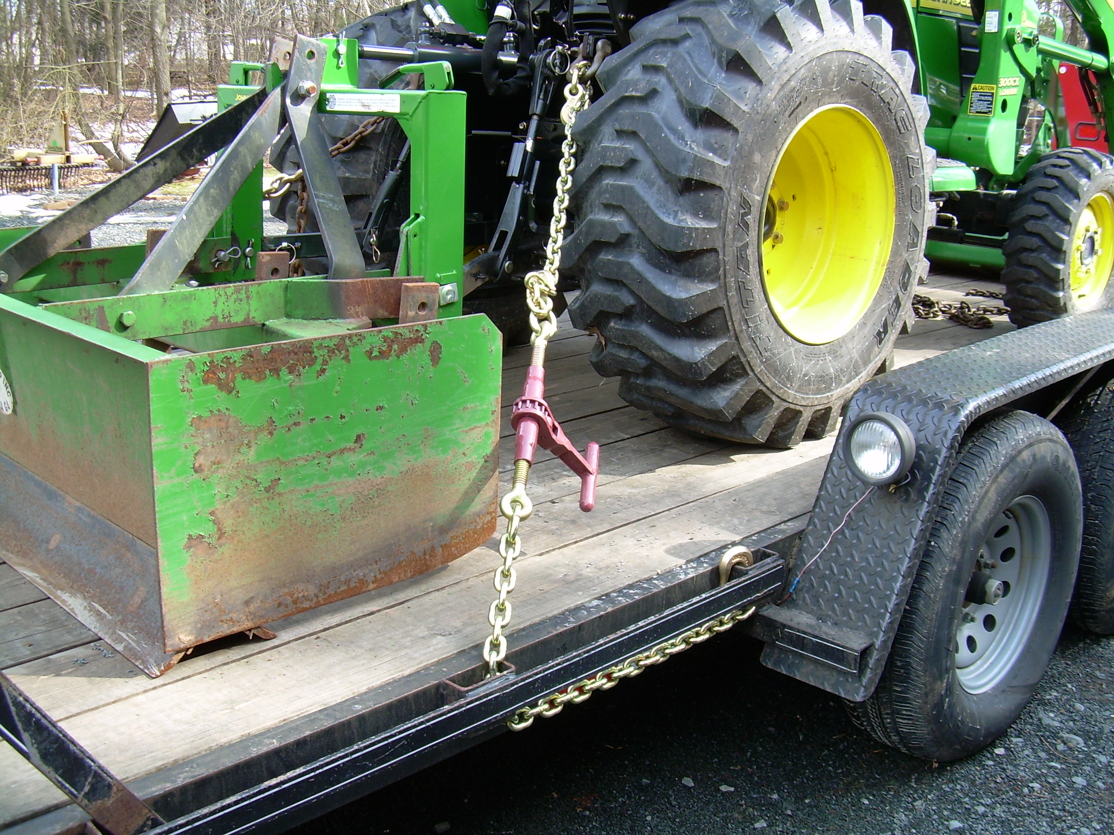

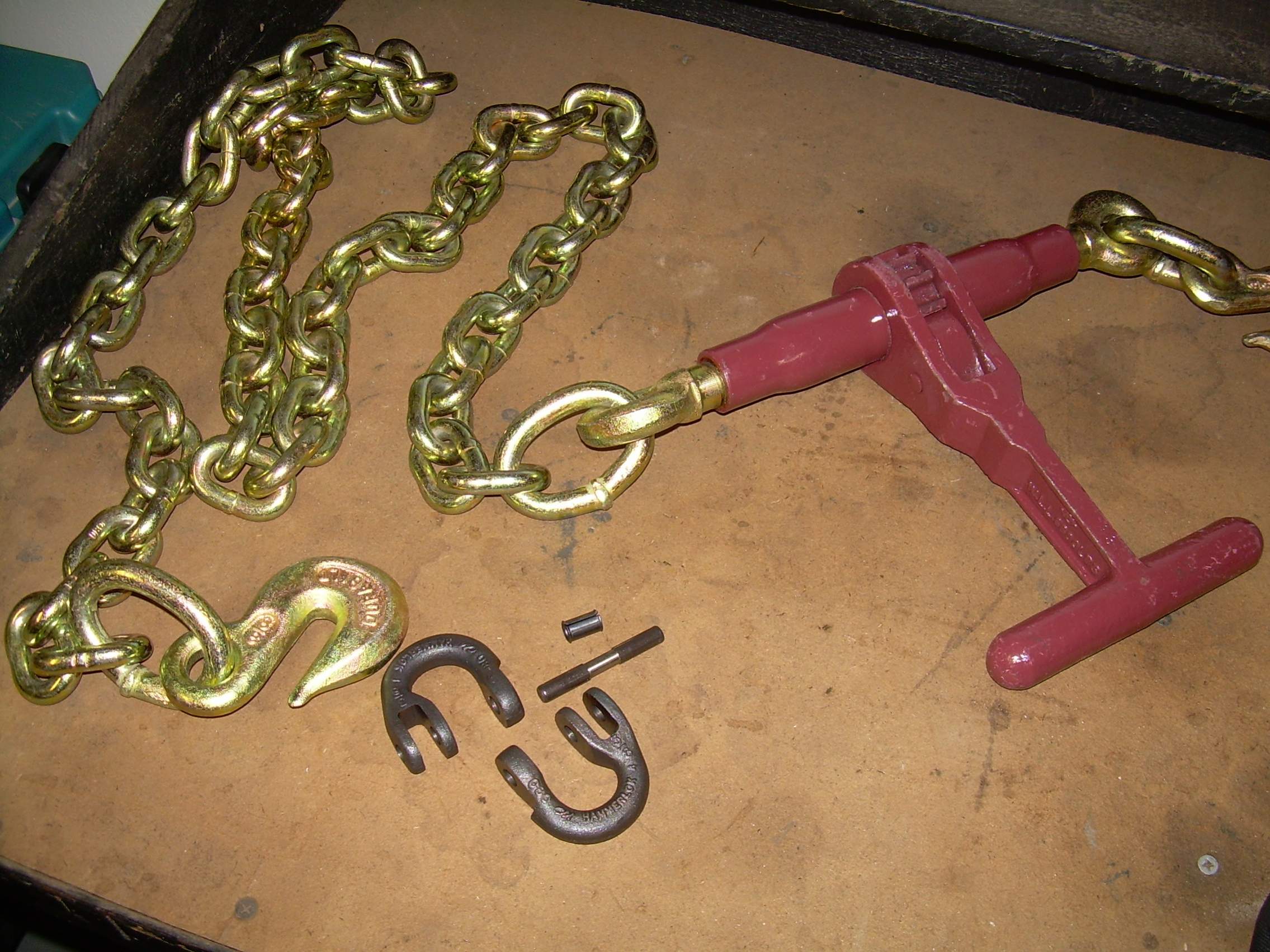

I agree that's why I'm going with all four corners with 3/8 chain and binders, bought 2 new G70 chains and matching binders and already had 2 5400LB binders and unrated chain. so that's about a 6x safety factor using the weight of the tractor added to the 4x safety of the chains and binders, so that equals a 20x safety factor total, I am pretty sure this could withstand a roll over a cliff.
I will use my 2 ratcheting webs for implements, I have not had my Back hoe on in 2 years, but I do want to be able to move that as well, since it will be attached to the machine I would think just rest the bucket on the deck and thread a web strap thru and tie it side to side.
I've also got an extra new ratchet binder I bought from AWdirect, it's a tee handle 6600 pound rating that had a 6' 3/8 G7 chain already attached, I though it would be better to have chain attached but found it isn't, then I cut the chain in half and installed another hook cause I thought that might make it better, but I just decided to stay with the conventional binders. Can't return this one now since I cut it, turned into a $60.00 experiment, I may find a use for it, maybe with the back hoe or other separate implement not connected to the tractor like my forks etc.

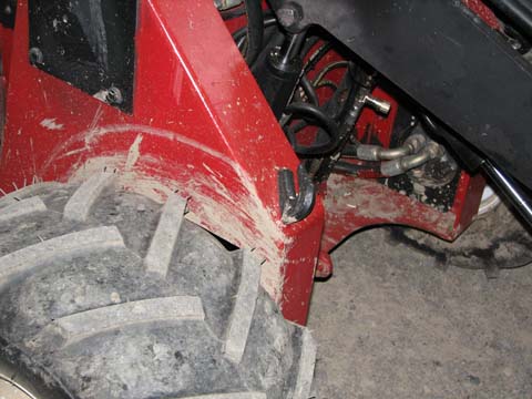

I admit that I really ate crow on that ordeal. I stupidly thought that 2 of the 10,000 pound rated (that's what it says all over the straps) 2" wide straps on the front and 2 on the rear of a Kubota L5030HSTC would be fine. After the incident, I felt like I needed "moron" tattooed on my forehead. :eek:
No strap was even close to a edge and the front weight bracket (with no weights on it) made for a great place to place the hooks on the front and the bottom of the hitch plate on the rear worked great there. I'd done the same thing for years without incident. It was only when I went to a friend's office who owns an engineering firm that he took the time to 'splain things to me. In his professional opinion the dip in the road caused my 7k trailer to flex, putting slack in the straps as the trailer actually moved up on both the front and rear and then snapped back in place. That shock load was, according to his calculations based on the construction materials used in my trailer and the weight of my load, enough to have easily snapped 3 of those straps on either end. He politely called me a lucky fool and, as you can read in the other thread, I promptly not only immediately purchased all grade 70 US made chain and binders, but bought a trailer with more than double the weight rating. I now only use those straps to hold down a finish mower or bush hog on the rear of my tractor to the trailer.
As an interesting point of interest, I did use half of one of the newer 2" 10k ratcheting straps to pull other ATVs out of the mud and snow. I don't know what a Suzuki 750 King Quad weighs, but it's nowhere near even the 3300 pound WLL of that strap. It maybe weighs, what, 600 pounds? Anyway, I snapped two of those straps with that Suzuki pulling other ATVs out of mud holes. If an ATV can relatively easy snap one of those straps, they definitely shouldn't be used to secure a tractor to a trailer unless you use like 20 of them!
And, yes, I admit that I'd have been a smart arse and argued that those straps would have been plenty fine, especially using 2 on each end. I count myself as very lucky that my ignorance on that matter didn't result in a life changing disaster. That's why I'm pretty adamant about telling guys what I know to be fact on securing tractors to trailers. Some think I'm nuts and act like I likely would have before I had that incident. As I stated before, if I can by chance save one guy from having a terrible accident, it's worth all the fussing. I can be disliked big time for my strong feelings on this issue, but if it helps someone, I'm okay with that. :)

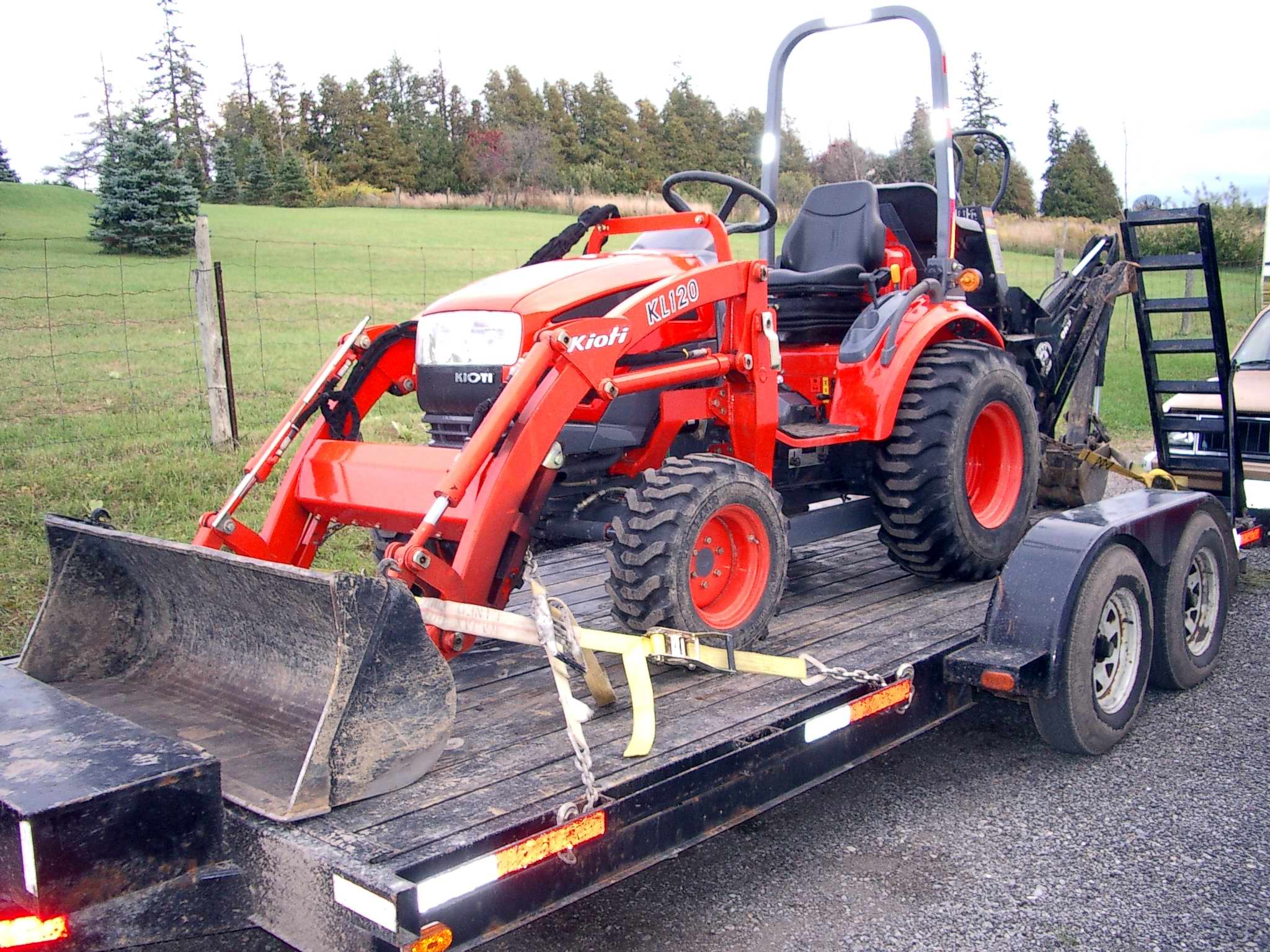

I have been formally trained by my employer to haul large excavators backhoes and dozers according to FEDERAL Regulations
How far did you have to travel?__How big of an employer?
I hauled through 21 states and hauled all different kinds of equipment, metal, pipe and ETC...
I was trained by the best flatbed division in the U.S.__T.M.C. and drove for 7 years.
Johndeere4300,
It is your combination of the front and rear chains. They are both pulling toward the rear.
It would be better to show a picture the way YOU bind one down.
I will continue to bind the way i do, because there is no problem with it.
We are talking about the picture in the avatar.
Chris
I know your talking about my Avatar.:rolleyes:
You can't tell in my Avatar what is chained down.
We need to see a picture of the way you bind one down.
That's the main reason for this thread, was to have pictures and not talk about a boat.:confused:
After reading what happened to you I actually thought that straps had the ability to absorb shock loads way better than chains. In fact some years ago ( no proof here of anything) I had a guy tell me that where he worked they did drop tests with weights secured by chains and straps. He said the straps held more than the chain due to their ability to stretch a little before breaking. I just wonder about the straps you were using. I've pulled hard on those straps loading vehicles onto my trailer pulling with a 12K MM winch and my new bridle is a strap. Never seen one ever break yet.

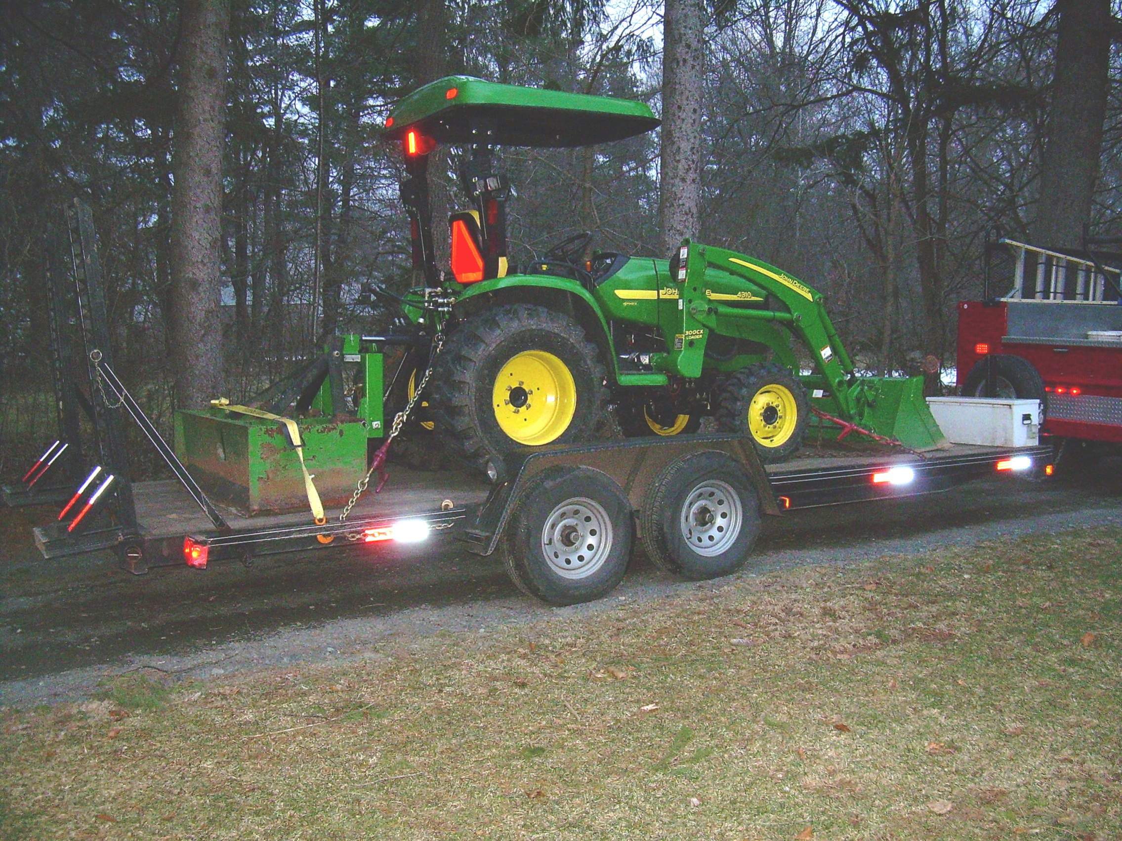

Gary has provided excellent photos. He is securing the tractor front and rear with opposing force and is also securing both the loader attachment and the backhoe attachment.
You might want to look back over Gary's straps and see if you see anything wrong with them.
One off them looks like it has a bad place in it.
It don't look secured to me.

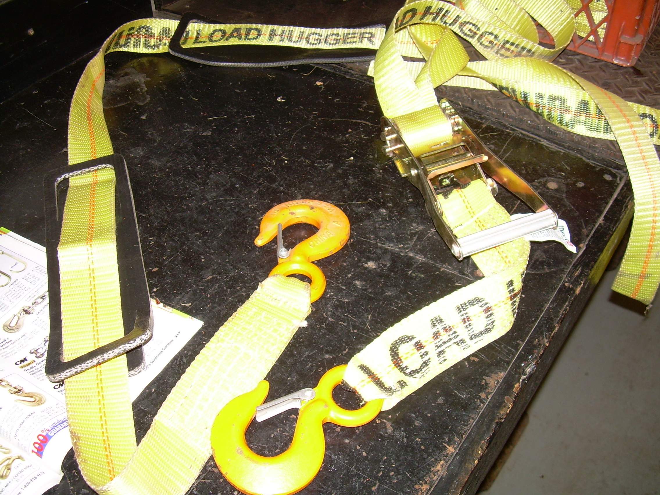

I use the 4" not 2". I posted back a few on how they are strong enough to fold up a 7k trailer like the one I used to have.
What are the ratings on your 4" straps
And Are you using deck winches or ratchets with the 4" straps
At least where I am anyway a 4" strap alone costs twice as much as a 2" strap with ratchet. Then I asked how much for a 4" ratchet. $78.00/pc
So $40 strap and 78.00 ratchet = $118.00
It cost $40 for 20' 5/16 gr70 and $20.00 for a lever load binder = $60:rolleyes:
   / Securing Equipment on Trailer #60
I'm using 4" w/ ratchets rated at 5600lbs WL. I paid 50.00 ea for a total 200.00 for all 4. I cut the length down so they are custom for my load. I'll take pics later as I'm loading it today
