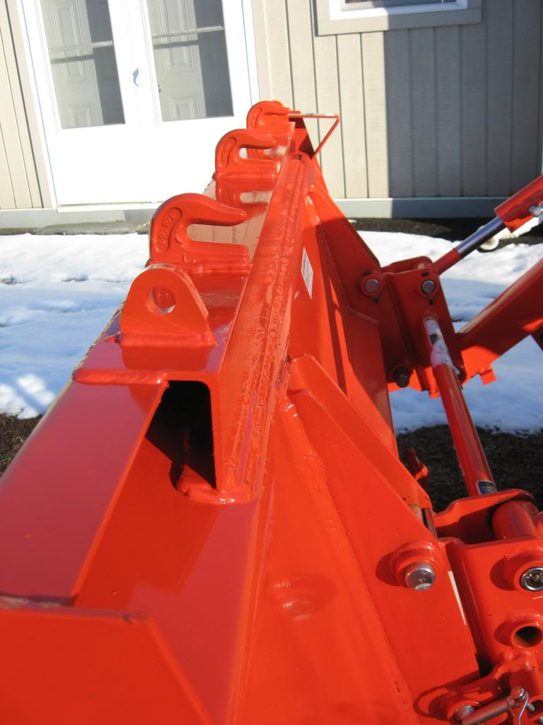

Excellent!!! Accomplished two things at once. Hooks and extreme reinforcement to the top lip of the bucket!!! :thumbsup:

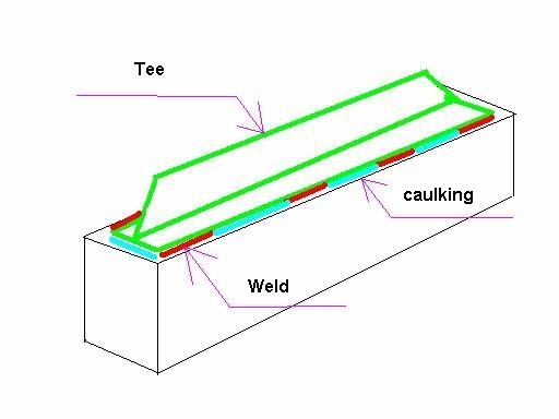

Shaneard I suggest you run a bead of caulking between the welds. So water won't get under the plate.

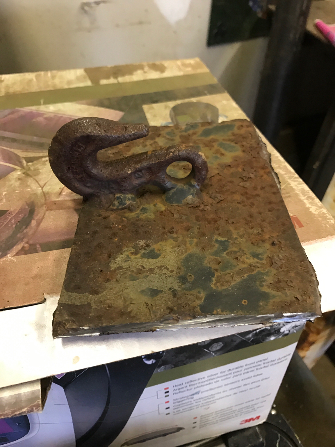

Oh here's the 5/16" hook and plate I cut off. Forgot to get picture before. This is part of why top lip was bent. IMG_3377.JPG
Agreed and heat it up and dry it thoroughly before you seal it.

Does anyone have pics of how to deal with the lip issue of the Kubota buckets? While I've got no problem ordering Kenny's Bolt-on hooks for the Kubota....I was just wondering if anyone's got a quick and easy way to attach grab hooks that don't rub over the lip. (And Kenny - over 50 bucks to ship to Canada? Wow!)
   / Seeking advice on welding hook to FEL bucket #108
Over $50? Who said that? The website (in the FAQ section) states $43.95usd for up to 20 pounds of product in a USPS medium flat rate box-this is what they charge, I do not profit from that. Unfortunately this is the cheapest way, I wish there was a better option for our brothers to the North.
*edit* I guess in Canadian dollars it is over $50.00
If you can weld, know someone that does, or can have it done locally then using a piece of angle iron to "box" the lip is a great solution, and it makes it very strong too.
Here is a great pic from a TBN member (and customer):
