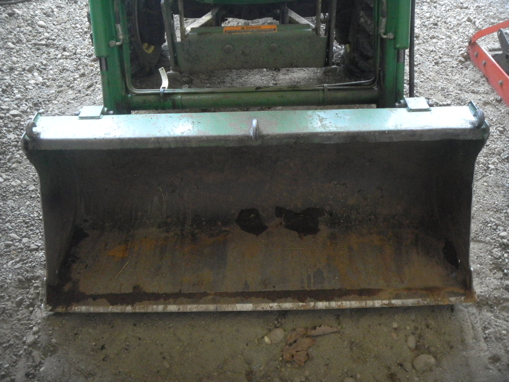

I put three hooks on my bucket. I skip welded a piece of flatbar under the hooks inside the bucket. The flat bar is welded to each side of the bucket, and skip welded under the top. My FEL will only get 1,300-pounds off the ground.

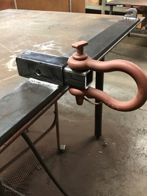

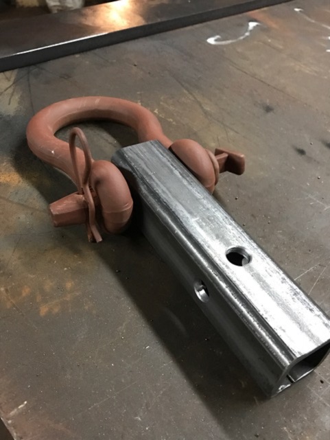

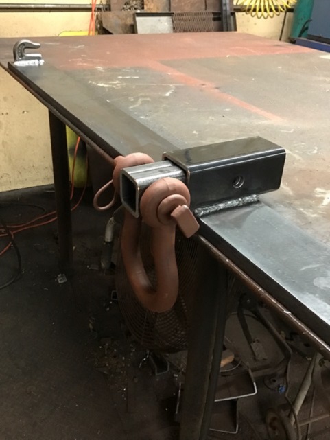

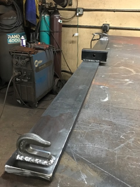

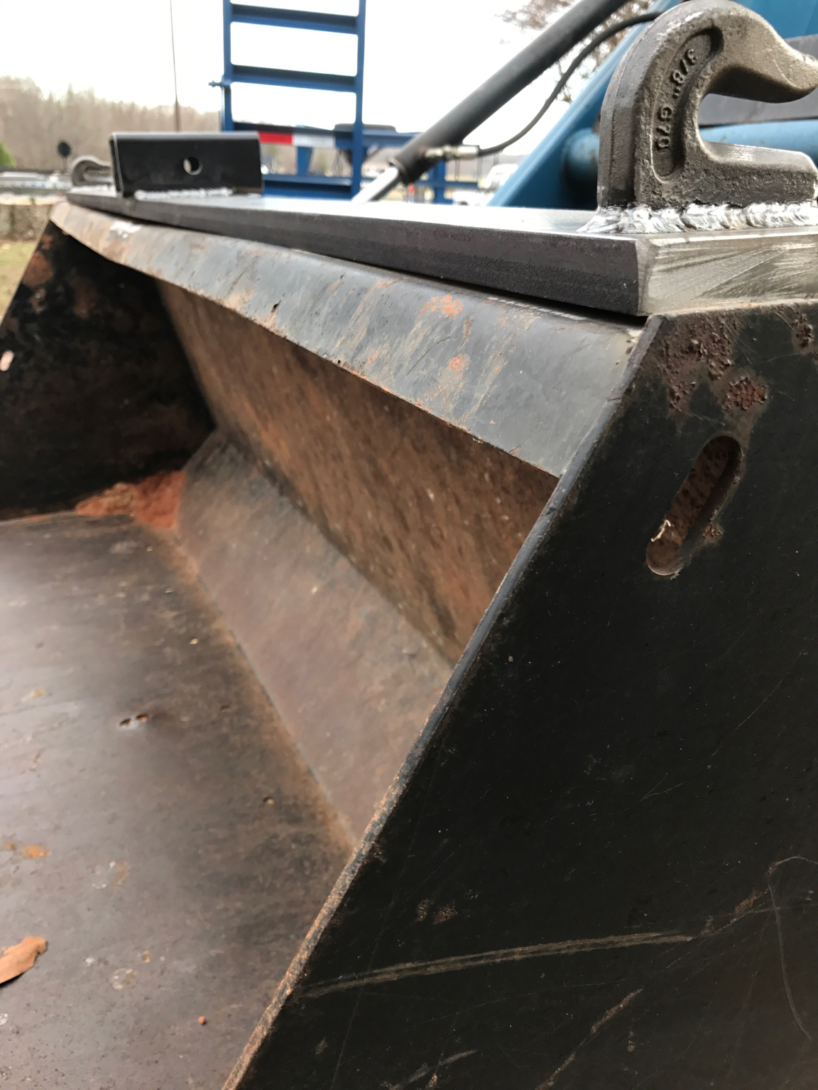

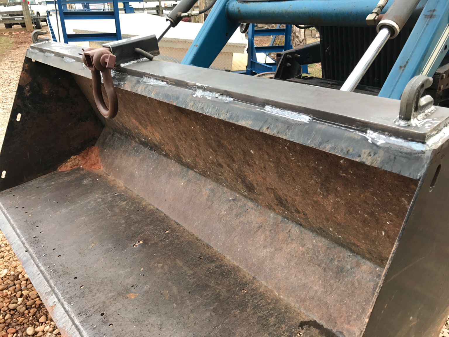

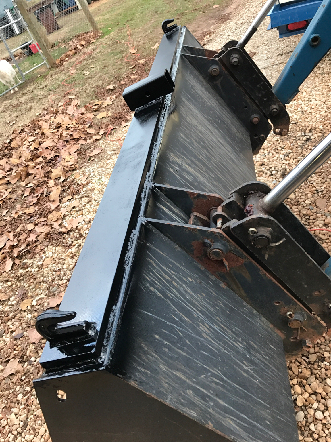

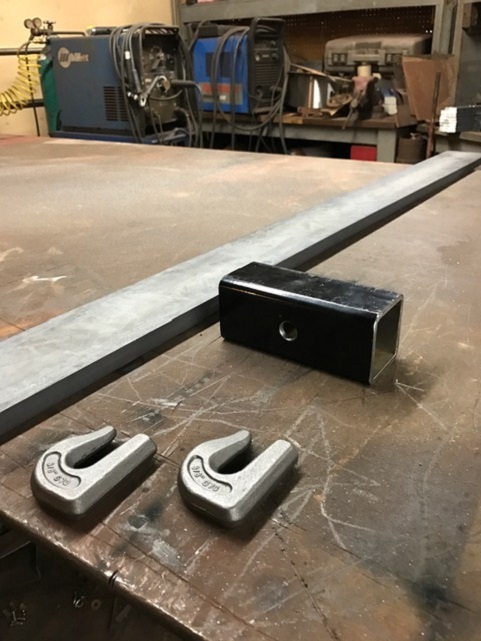

I cut me a piece of 3/4" X 4" HR steel 71" long to weld on top of my bucket then fired up the old Millermatic 250 and welded my hooks on it, decided to put a hitch in the middle for my clevis that way I can turn it 90 degrees if I need to and it's not dedicated to just one position. I can also stick it in my other hitches if I need to. I need to put a fresh coat of black paint on the bucket anyway, this will be the perfect time to do it all!

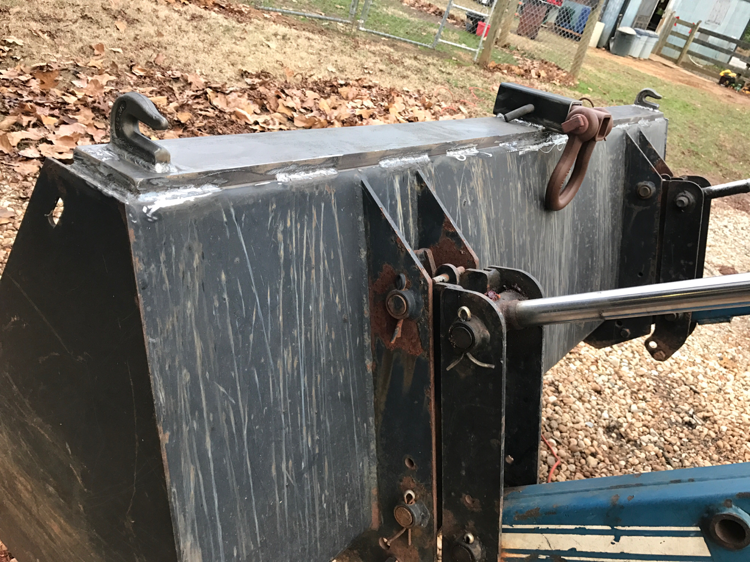

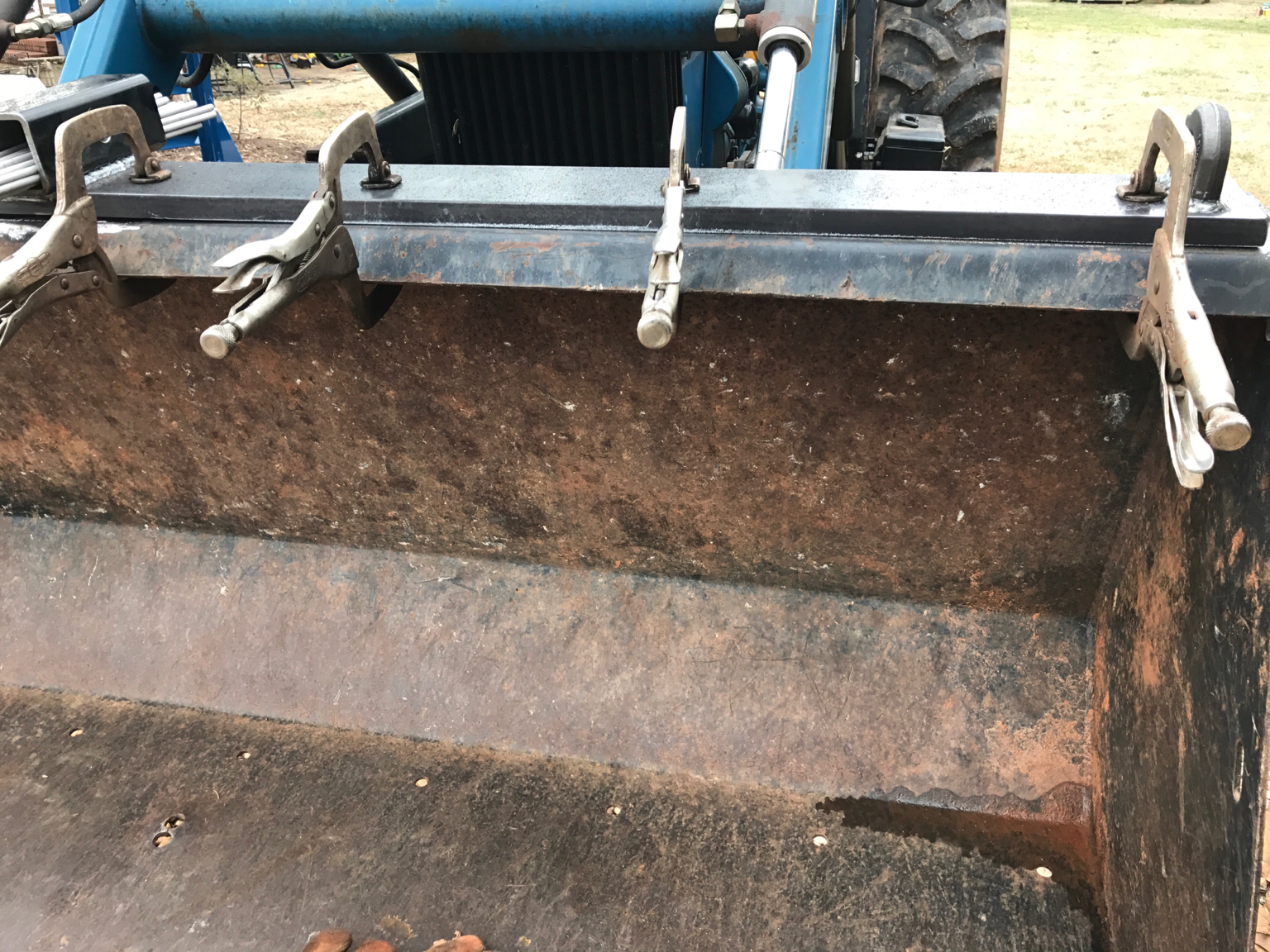

Finally got around to cranking the miller bobcat and burning some 7018's. Had to do a little clamping and jacking to get it straight. The clevis can go either way and be put in backwards to get it out of the way. IMG_3373.JPGIMG_3376.JPGIMG_3380.JPGIMG_3383.JPGIMG_3384.JPG
