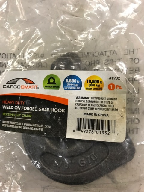

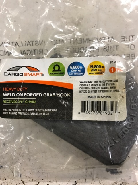

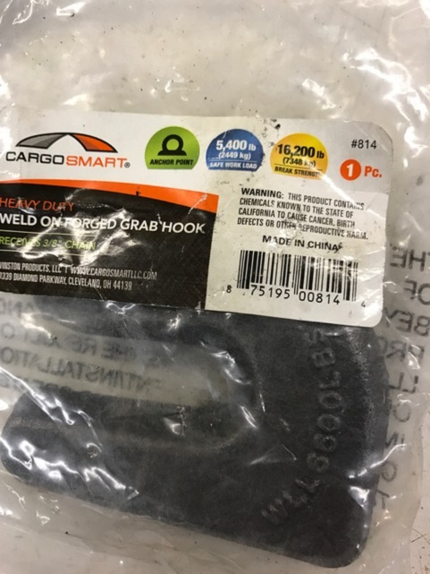

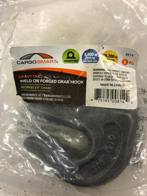

I am going to grind off the single 5/16" hook welded in the center of my bucket put on by previous owner and put 2 on the outsides and something in the middle for a clevis. I went by Northern Tool and bought 2 weld on hooks. They only had one that was cheaper so I got it and one in the bin beside it that was a little more expensive. Now, riddle me this batman, one package says 5,400lb safe work load with 16,200lb break strength. The other package says 6,600 lb safe work load with 19,800lb break strength. Now look inside the package, the hooks have 3/8" G70 on one side and the other side says WLL,6,600lbs. Why would they put the same hook in different packaging only to charge a little more money? Why not just charge one amount and use one package if it's the same product?

   / Seeking advice on welding hook to FEL bucket #88
Maybe someone switched the hooks in the bags at the store, they are in small zip-lock bags right?
   / Seeking advice on welding hook to FEL bucket #89
No, they are sealed bags.
