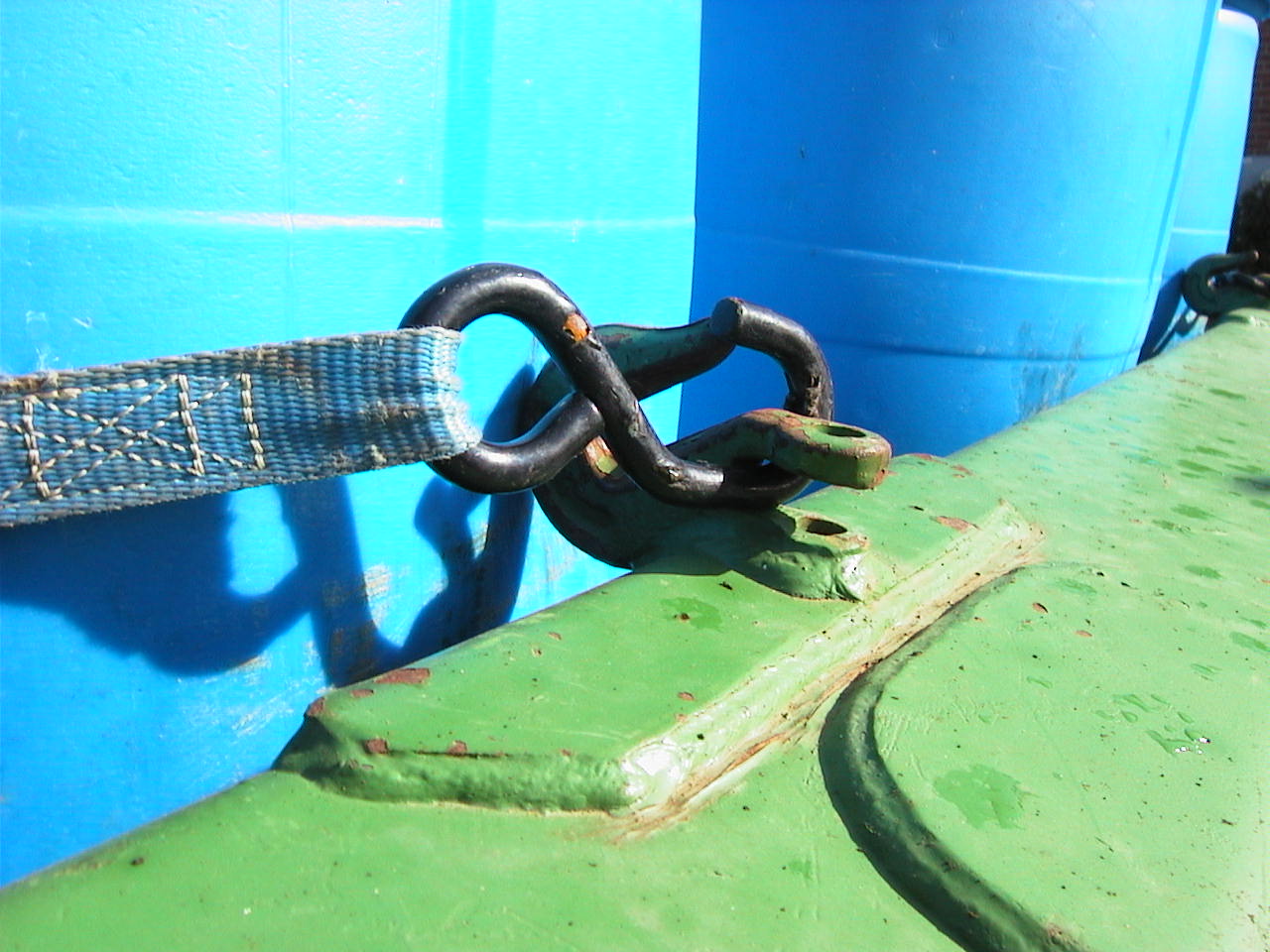

This is the only photo I can come up with of what I think is the perfect way to do bucket hooks. It's on my 90HP JD 5520 and is way stronger than ever needed.
It's a quarter inch plate bent to the angle of the lip of the bucket and welded on. There are two--one on each side in line with each cylinder and the hooks are welded to that plate. I prefer this type of hook on this tractor because I hook water buckets on for watering seedlings and I can hook the straps better. The nipped corners on the plate give it a "fishplate' style that I figure is stronger. This is not going anywhere.
Anyway, I lift very heavy things with this tractor and it works great. I hook a chain into each hook and then use a shorter chain hooked to the center of that chain to lift things. I figure it distributes the weight better and it must because I've never bent anything and I've sure tried.
