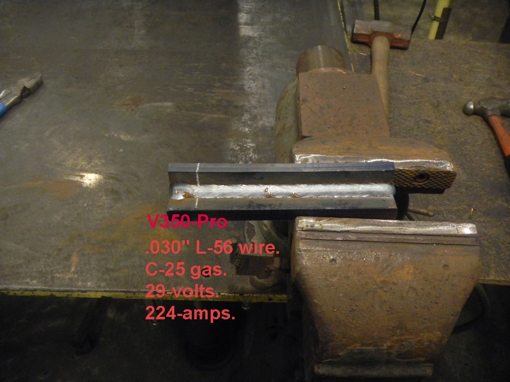

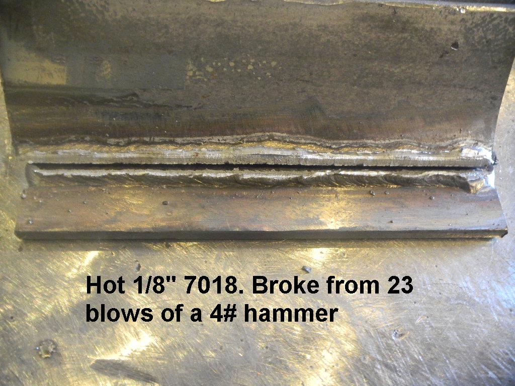

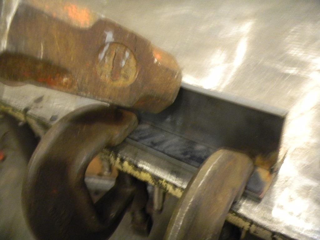

Several years ago, I did some fillet weld break tests. Not very scientific I know, but you get the point! ;)
   / Seeking advice on welding hook to FEL bucket #26
One of the things I learned in my tech school Adult Ed welding class was weld penetration. When I weld something serious and thick, I get great penetration and even though I may (no may about it) lack actual welding finesse. I can't recall a weld tear or break even when I somewhat expected it. Take your time, fit and grind and put the right amount of power into it has worked for me. It may look a little or more shaky to a pro but it holds.
   / Seeking advice on welding hook to FEL bucket #27
Shield Arc, I think you posted these pics and comments on another thread before. What amazed me then and does now is how your weld broke. It undeniably broke the weld. Didn't tear loose from the metal. The break is straight, not jagged back and forth across the weld. That tells this amateur that your weld had consistent penetration as Sixdogs mentioned above. It also had consistent strength the full length. Excellent visual example of what a weld should be. I can only wish...... :)

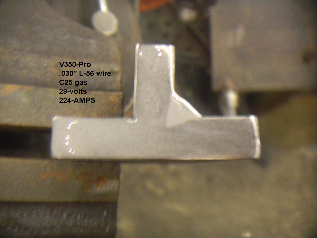

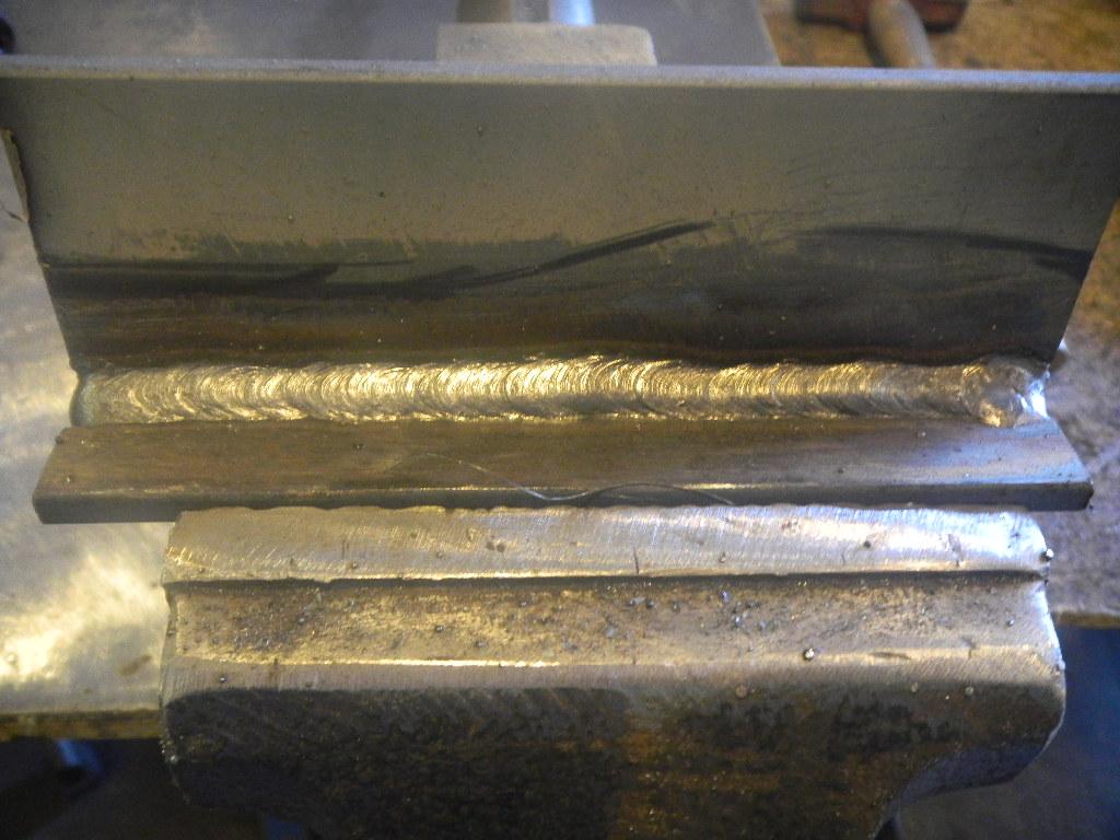

To get good penetration, all it takes is power! :D

   / Seeking advice on welding hook to FEL bucket #29
You second photo in the above post #28 is amazing. It's close to a centerfold weld that every welder should tape to the mirror in the morning.
Shieldarc--I can't imagine any of your welds ever tearing under any circumstance ever. Never. Why did that weld fail?

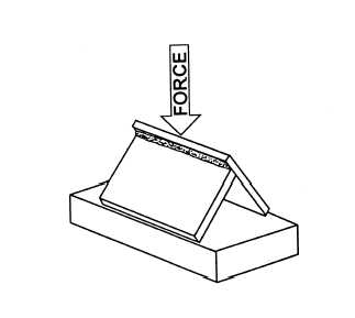

Which weld, the 7018 weld? If so, the plate was beat on the back side, weak side of the weld. All welds will fail that way. In a lab they break fillet welds in a shop press, so they can see the amount of pressure it take to break the weld.
