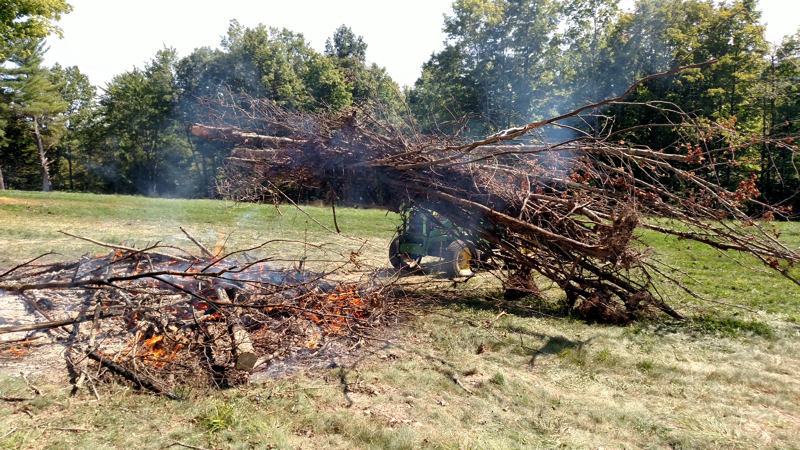

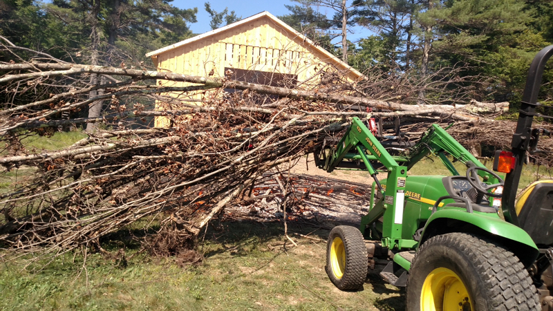

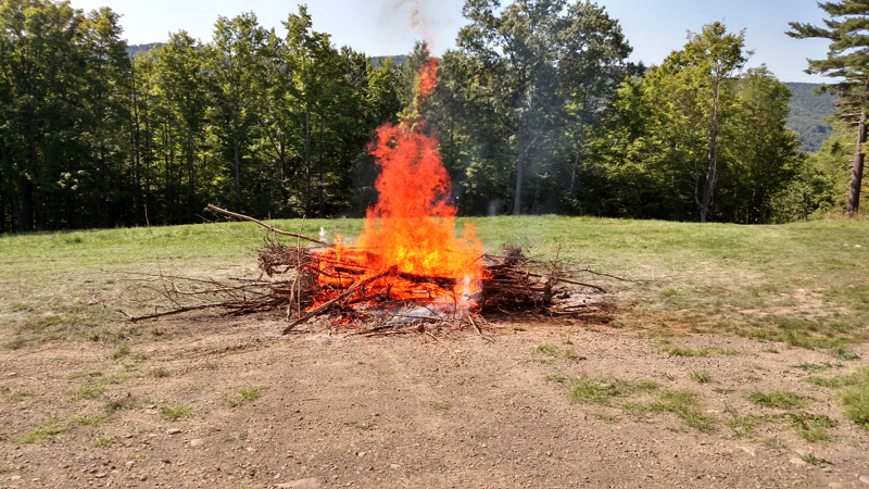

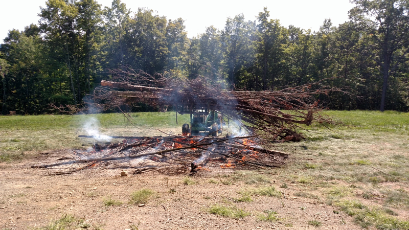

Go small, go light, go single lid. Save your money for other attachments. You'll have more net lift capacity to boot. Mine is 48", about 300lbs. Opening width is about 42-44" as I recall. Made by Millonzi who went out of business when the owner died quite a few years ago.
My grapple cost me $500 and is as basic as you can get. If I had to do it over again I'd get the same thing except that I like the much better designed and wider EA upper grapple arm. Someday I may try to convince EA to sell me just the upper arm and replace mine. Still, I've had my grapple for ten years and beat the crap out of it. The bottom is missing paint but otherwise in original shape. The upper arm has been twisted a bit but works fine. This is how I twisted the upper arm: (note that only one tine is touching the 2000lb rock which was not simply lifted but actually pulled out of the ground in one lift...I thought it was smaller as only the tip was showing)

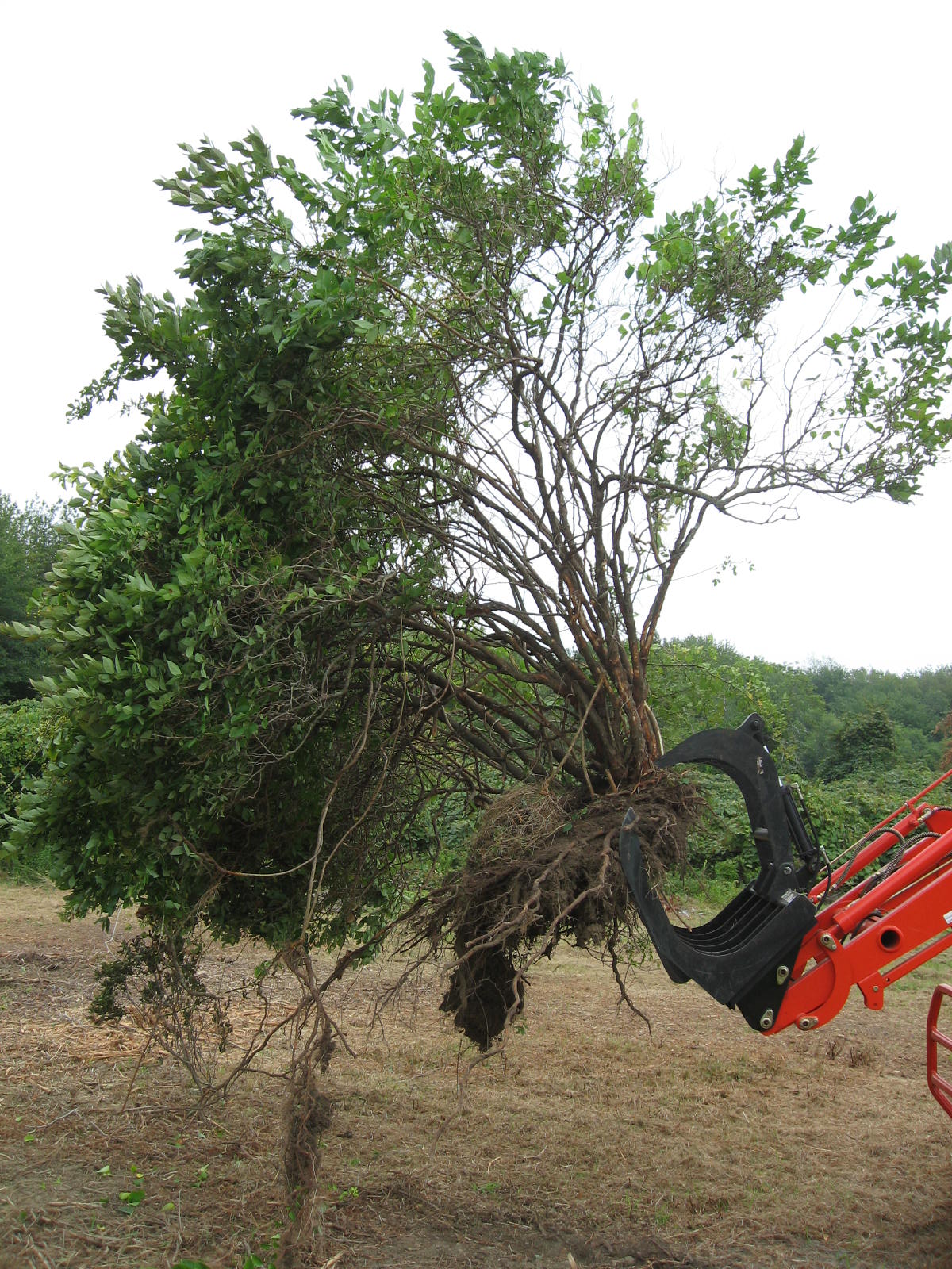

I will have to admit I have never wished for a wider grapple than my 50 inch. I have wished it were narrower a few times.
IT did you see what I built as and attachment for my 50 inch EA Wicked?
http://www.tractorbynet.com/forums/...y-wicked-grapple-bush-grabber.html?highlight=
Pretty cool James. I like both yours and rswyan's.
I've never felt the need for actually grappling the above ground portion of a sapling or small tree. My technique on smaller trees and bushes is two steps: 1) push the sucker over to expose roots, 2) once it's over the roots are exposed so I just slip my narrow grapple under the whole rootball and pop it out. With shallow rooted trash trees I can even take on bigger than sapling trees with this technique. With bigger trees I raise the grapple and push from about 8feet for leverage. Sometimes it takes pushing from more than one side to loosen up the roots but once I can see the roots pop up I just stick the grapple underneath, stick the tractor in 4wd low and push while curling the grapple. The last photo was a tree that I used my BH ripper on to cut the roots before pushing it over. Probably could do that with the grapple but it would be much messier finding all the roots. The ripper is great for that size tree.

Build something like my little attachment and you can grab grape vines all day. it is kinda fun to yank them down.
