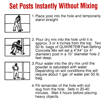

That looks great, Harv. One little thing that makes me curious is the order of the pictures makes it appear that you poured in the dry mix then added the water (mixed it in the hole, I guess?) and I wondered if you did it in that order. I always poured in the bucket of water then the dry mix. Kinda curious as to whether the order in which they're put into the hole makes much difference.

Up until this project I had always mixed the stuff in a wheelbarrow first, even though I had heard you could do it right in the hole. Guess I wasn't convinced it would mix properly.
This time, however, I grabbed a flyer at the store since I had never used the fast-setting stuff before. So for the first time that I can remember, I actually followed the instructions! /w3tcompact/icons/shocked.gif (See attachment)

Jerry, I used to be the same way, but it really is a lot easier to mix it in the hole, but everyone I know puts the water in first (thinking it'll get mixed better than way), but Harv's instructions showed to put the dry mix in first. Now I wonder whether either way actually works better than the other.
   / Seemed Like Such A Simple Project #100
Putting the dry mix in first, then adding the water is the same way I mix concrete in a wheel barrow. So, the instructions Harv posted make sense to me. /w3tcompact/icons/smile.gif
