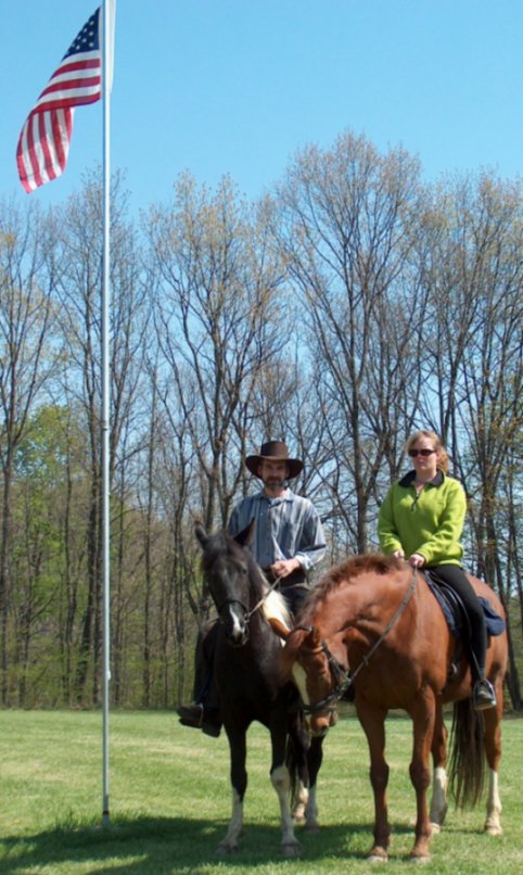

Fractal,
My wife gave it to me for my birthday (just after 9/11). She bought it locally in VA (although it was delivered from MN I think). The total cost was about $500 with the flag. The pole is one large piece of aluminum and tapers from 5" to 3" (I think). I would definately recommend it.
I did use the PHD to put it in, however, some shovel work was requred to bell the hole. It's a shame I didn't take a photo journal.

Thats the kind of flag pole I want to put in.......but I'm a little strapped for cash.....so I might go with the lesser priced model and see how it hold up.

Nice Pic!!!! Thats a mighty fine view you have there MrP!

If you do a little internet shopping, you can put a package together for alot less than it cost me.
Check out:
<A target="_blank" HREF=http://www.aflag.com/cgi-bin/Web_store/web_store.cgi?page=residential_poles.html&cart_id=3198360.13367>Residential Flagpoles</A>
Although, I think mine may be the commercial grade:
<A target="_blank" HREF=http://www.aflag.com/cgi-bin/Web_store/web_store.cgi?page=commercial_sizing.html&cart_id=3198360.13367>Commercial Flagpoles</A>

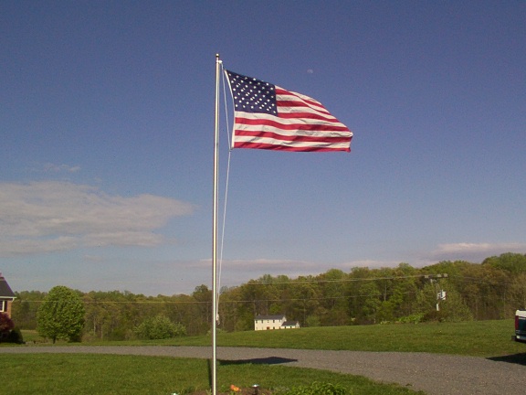

I put up a homemade flag pole made out of galvanized pipe. It's a lot cheaper and looks just fine to me. You can go as big as you like. I used 1 1/2", two sections. If I was going to go three sections I would have used 2" pipe. I buried a 3ft. piece in concrete and the pole slips right in. I can simply pull the pole up if I need to. See pic.
