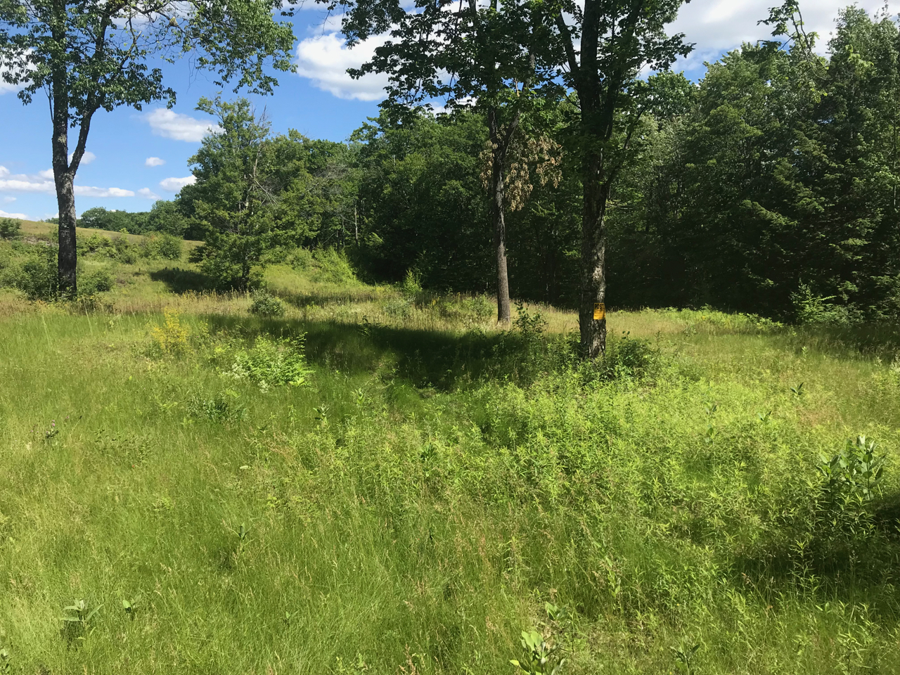

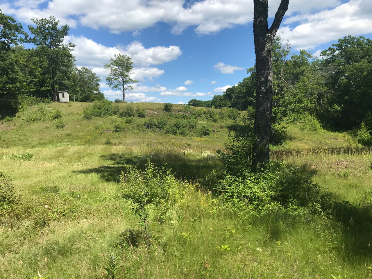

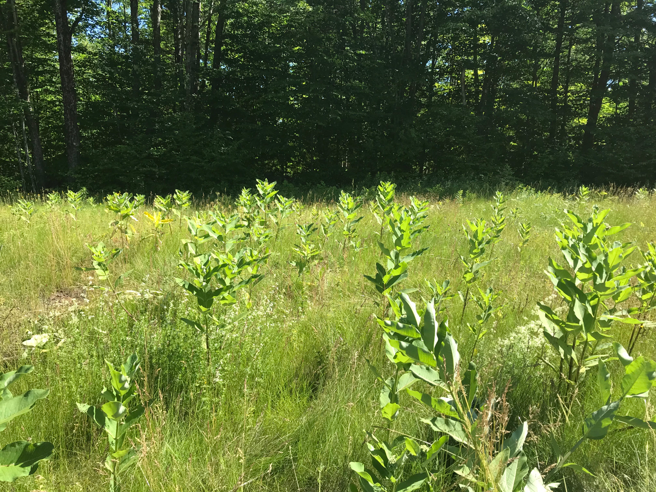

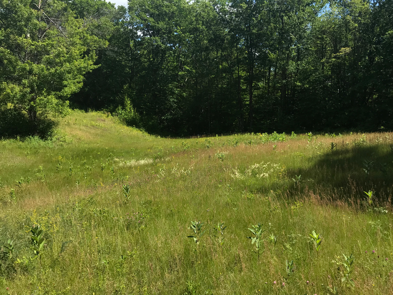

I've recently (this past winter) acquired a new property that requires mowing. I've been using my Land Pride 1660 finish mower to try and get it into better shape. As I understand, it was "bush hogged" once a year previously. I'd like to make it a little more grass-like and a little less "weedpatch-like". My intention is to mow it maybe 3 times a year to keep the weeds from going to seed.
This is not "field grass" as in, filled in, ready-to-make-hay kind of grass. It's somewhat sparse, but the taller stuff I'm cutting is probably near 2 feet. I know, probably more suited for a rotary cutter, but this is what I currently have.
My mower does a pretty decent job, but i do get some "stragglers" - tall, uncut pieces of grass/weeds/whatever. It may be partly due to the blades not being razor sharp, but they are not too-too bad (compared to some I've seen here and there). What I'm thinking is that since I have it set to the highest possible cutting height (wanting to avoid the not-too-infrequent rocks, protruding ledge, misc logs etc) that there just isn't enough suction to keep everything pulled up good and tight so that it gets sliced/shred/torn off. I'm assuming that the blades I have are "medium lift". Would "high lift" potentially give me a better cut? Other thoughts (other than getting a rotary cutter, which is not entirely out of the question)?
FWIW, I don't feel I have a problem with power on my 22.5 HP (gross) / 5' mower, so the extra loss from the high lift (I'm assuming there is one) would probably not be significant.
This is the type of conditions I'm looking at:
NOTE: Yes, I am cutting some of the "brush" that's in the pics, but with a more regular schedule of 2-3 time per year that condition will no longer be. I suspect that the previous owner actually didn't have it cut at all last year.

The tall pieces are likely taller than your deck is wide. The front edge pushes it down and holds it until the rear edge reaches it and holds it down. The blades may never touch it. If so, the blade type or condition won't make any difference.

How many times did you try cutting it? I would cut the opposite direction or try 90 degrees to the last cutting. I think you could get by with the equipment you have now unless you want to spend some money. Sharpen your blades too

Another possible solution. Take the time to walk the fields and mark or remove the rocks & logs. The ledge??? - I guess mark it. This will allow you to lower the finish cutter and achieve a better cut. As all have indicated - be sure the blades are sharp.

Waiting till the grass goes to seed is beneficial to the project. Unfortunately, about the only way to get a decent cut quality will be to cut it a second time, either at an angle, or at least in the opposite direction. Wait a few days or more between cuts.
   / Selecting blade type #10
As Rick suggests, wait a few days between cutting it at a different angle and I think you'll have great results. As for angles of cut, rather than 90 or 180, try a slight angle on the first cut and then a slight angle the other way on the second cut. Instead of ( l ) and then ( -- ) to form ( + ) patterns, angle from 5:00 to 11:00 ( \ ) and then from 7:00 to 1:00 ( / ) to form a ( X ) pattern.
