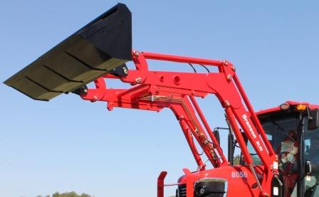

The arms on my Humpolec loader kinda/sorta suggest that there was an option to fit different geometry, i.e. something that would keep the bucket at a constant angle to horizontal.
I've looked at it many times with the "self leveling" thought, but never got around to sketching it up in a CAD program.
Basically a parallelogram should do it and I think I have seen that on a large('ish) JD.

As far as self leveling goes the Branson 8050 with the BL50 loader is self leveling.
Many of the New Holland and IH can be ordered with or without self leveling loaders,
if you find one on a lot you could see how the mounts and arms are configured.
The only hydraulic self levers that operated where on large loaders and you could
actually feel the hydraulics fight you if you tried overriding it.
