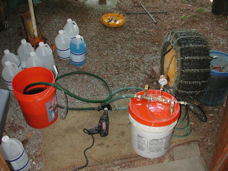

Hi,
Here is the first of two pictures. This one shows the layout things. Five gallon bucket on the left holds the ww fluid. Next time I will cover it with a piece of plywood with a hole in it so I don't have to hold each gallon jug the whole time it empties.
The larger green hose goes to the pump and the outlet hose from the pump [lighter green one] goes to the assembly I made up with the valves and pressure gage. The small hose from the bleed valve [red handle] goes back into the 5 gallon bucket, to return any fluid that comes back out of the tire when the air pressure is bled off.
The fluid to the tire exits on the far right, and goes to the tire via vinyl tubing, the cheap kind that you can buy at home depot for something like 10 or 20 cents per foot. It can easily hold 15 psi. That hose slips over the valve stem and is held on by a small hose clamp.
If this post goes and the picture also appears [never posted one before] I will also post a closeup of the valve manifold assembly.
Bill

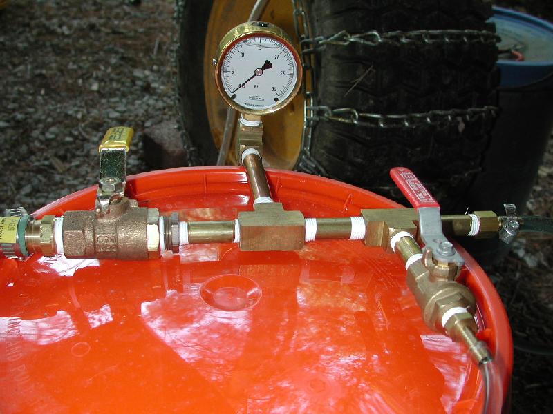

Hi again,
Well, here is the close up. I happened to have brass fittings on hand so that is what I used, but you could just as easily use black pipe which is VERY cheap in these small sizes.
The pressure gage is not needed, but was very usefull as it gives you an idea about what is going on. The pressure gradually built up as the fluid went into the tire. I decided to turn the flow off at 15 psi, which gave me about 11 psi in the tire, due to the pressure drop of the long piece of vinyl tubing between the pressure gage and the tire [maybe 20 feet ?]. I did not cut the tubing short as I don't know how long I will need it to be when the real tractor arrives...
The valve on the left, with the yellow handle, turns the fluid from the pump on and off. The other valve, with the red handle, is the bleed valve. The tubing on the outlet of the bleed valve returns any fluid that is in the tubing that goes to the tire, as well as any fluid that comes out of the tire, back to the 5 gallon bucket.
When filling, you open the yellow valve, with the bleed valve closed, and pump to the tire. At some point, you close the yellow valve [I also turned off the drill] and open the red bleed valve to let the air come out. Then close the red bleed valve and repeat as required.
You can see the tubing that leaves from the fitting on the far right [a simple hose barb] going up to the valve stem on the tire if you look closely behind the pressure gage.
When doing the first tire I bled the air out three times. The third time I was really glad I had the return tubing going to the 5 gallon bucket, as I think I overfilled the tire by about a gallon and a lot of fluid came back out! The second tire I only bled twice, and on the second bleeding I found the tire was full.
Worked really well for me...
Bill

Wow. You had all of that "just laying around" huh? Pretty slick setup. You should go into business filling tires! Might want to go back to Phar-Mor and pick up a couple hundred more gallons though...
   / Self loading of tires easy! #7
Wow, looks like a really slick setup. I am wondering why you would be concerned with how much pressure you are putting into the tire when filling with the fluid. I've never done it before, but I thought they just pump the fluid in until the tire is full enough, install the valve core, and then pressurize the tire with air to the proper pressure.
The reason for the pressure gage is to get an idea when to stop filling, and start bleeding air.
As the fluid fills the tire the pressure builds up, and I am sure the flow rate drops. With the gage you can pick a number and when that pressure is reached, stop the pump and bleed the air. I picked 15 psi...
Without the gage it becomes more guesswork and less science, so to speak. But aside from a possible time savings, I am sure that you do not need the gage.
Actually, I kind of like watching it and not guessing. But if I did not hava a pressure gage laying around I probably would have not used one.
Bill
