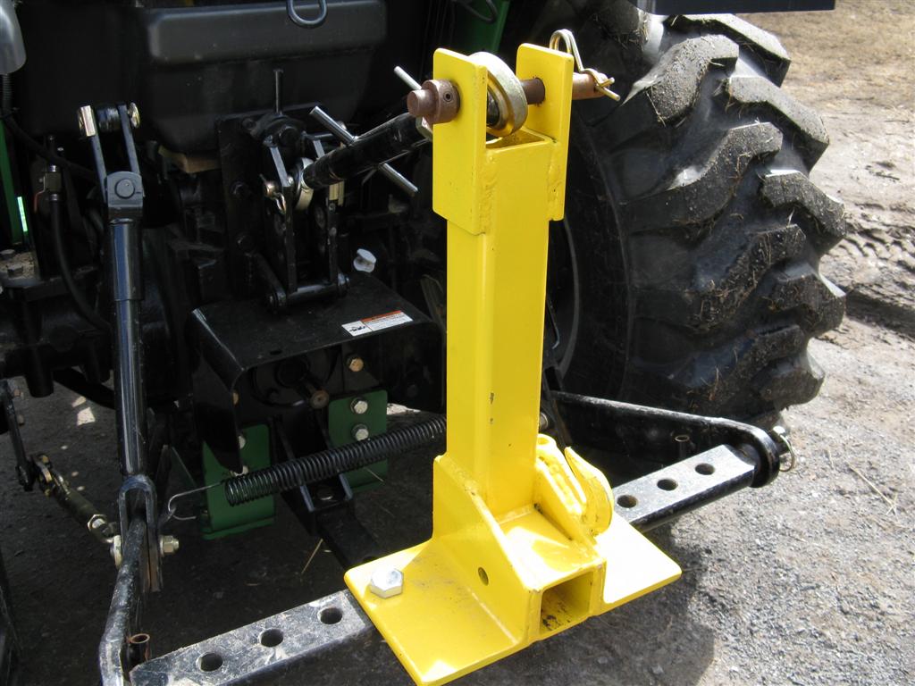

I have made lots of attachments but the most used would definately be the 3ph reciever hitch. I am forever building something that slides in the hitch and works off from that. I have 2 factory boom poles but I built a small one out of 2" tubing to work off of the reciever. Sometimes I need the factory one but usually the smaller one in the reese hitch gets the job done and is a lot easier to change out.
Whenever I take an implement off of a tractor I put the reciever tube back on. Keeps the sway out of the lift arms and is always ready to move a trailer. Built 3 of them, have 2 tractors. If someone needs to use one of my home built reciever attachments, I have an extra hitch to let them use also.

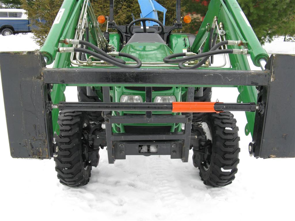

My most used is the front quick-hitch (either with, or without my three-point hitch mounted). With it, I can put any three-point attachment on the front, including my carryall. Coolest so far is my boom pole (in my humble opinion).
really interesting. have close up pictures of your build?
   / Self made attachments #23
"really interesting. have close up pictures of your build? " Here are a couple of pics. You can see more if you search under boom pole and quick hitch, etc.

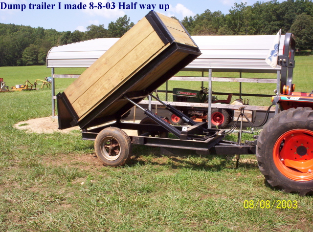

Just a small sample of my home made all time favorites. First 5 videos are my Robo Rake made completely from scratch. (Click on image to watch the videos.)
Robo Blade with gearbox built by 3RRL:
Home Made Grapple:
Home Made Dump Trailer with two stage tailgate:
Larry
