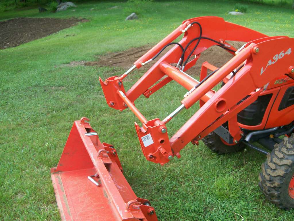

I have three bucket hooks welded on short pieces of angle iron on my bucket, and love them. I've attached a picture. The short angle iron gives me a place to put things like steel bars, and I've sure used all three hooks.
You will also like the QA very much. I just got mine, and have used it for the forks, and just to take the bucket off. It doesn't seem to affect lift capacity though I know technically that it does. Actually, I have been able to lift odd shaped things with my forks, and the QA that I couldn't lift with the bucket without the QA because the forks allow me to get the load closer to the pins. Don't do what I did though, and install the pins the way they came..... make sure the greasable ones are back where the QA pivots. Duh!
